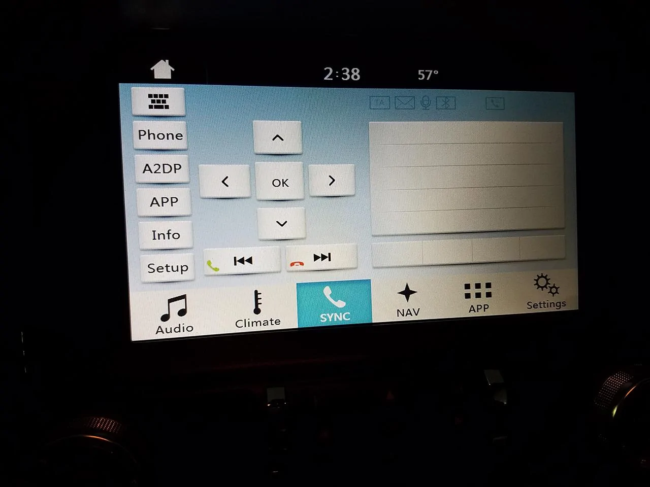

How about a thread revival???
I'm having similar issues and trying to work them out. I upgraded from a standard Sync model to a Sync3 from
a member here and it worked out nicely for a while but noticed that capabilities have slowly been chipped away
over the months.
At first Nav, then bluetooth (Fuse fix is only temporary) and finally total meltdown where I cant do much other
than listen to the radio. I am wondering if the sync unit is fryed. I tried doing a soft reset (power button and
right seek aarow) as well as a hard reset but nothing has worked.
Anyone have this problem? Thanks in advance.
