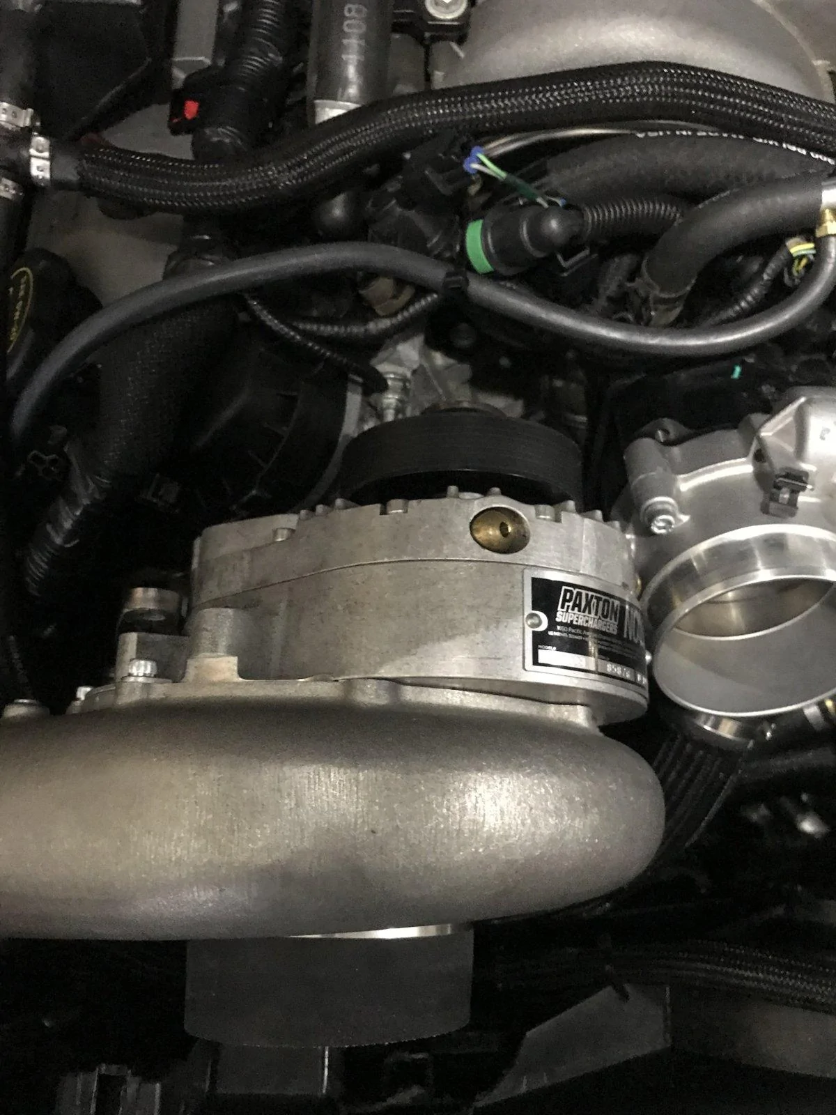

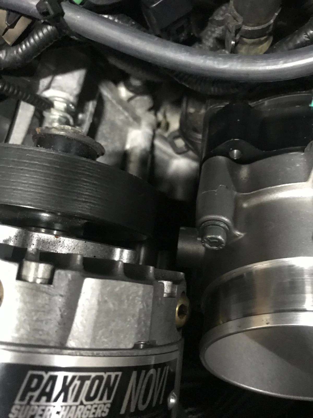

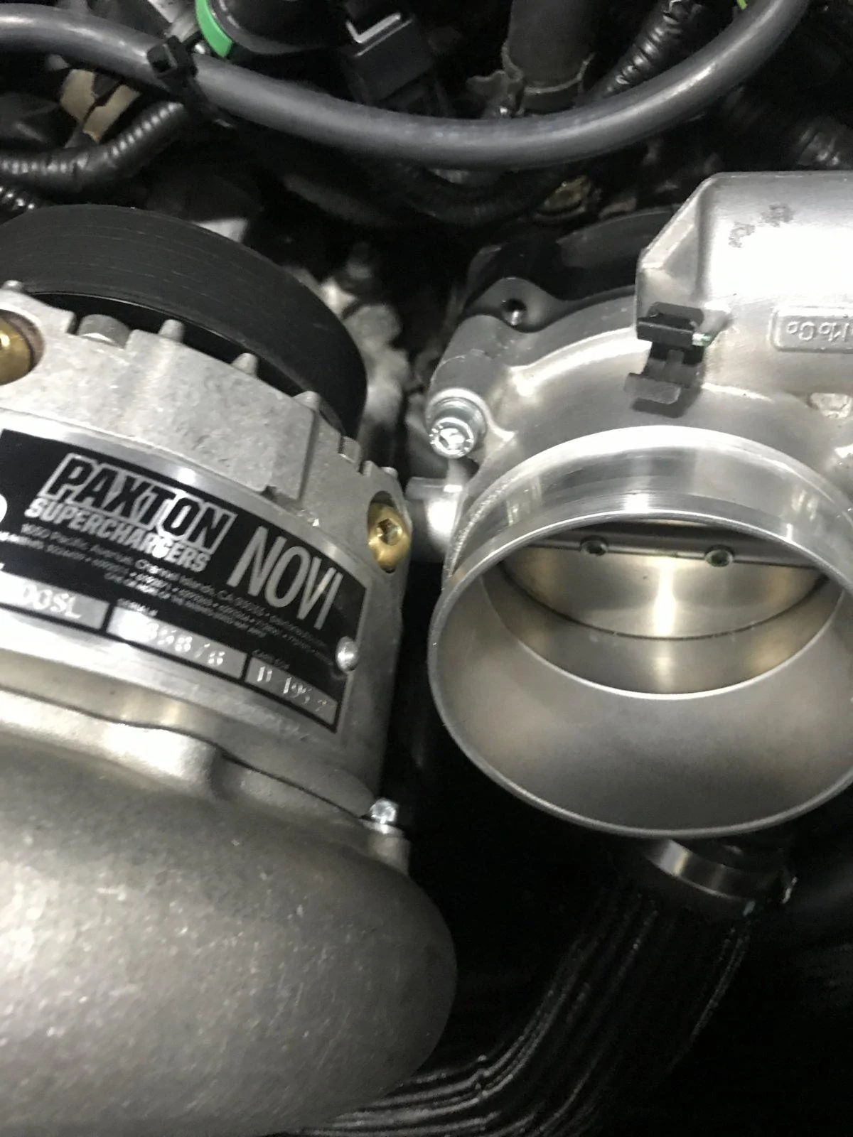

Anyway, I pulled the Paxton kit off the manual car which I had no problems installing it on, or pulling it off of, Im on the very last steps of installing on the automatic and for some reason, I can’t fit the head unit with the throttle body spacer provided by Paxton. It doesn’t even come close, I can fit the throttle body without the spacer, but no dice with the spacer. I’m running an 18’ manifold, is the spacer even really necessary? I’ve included pictures to how far off I really am. I’m not sure how it’s even possible. Any advice is appreciated.

Just for my own mind I went back and looked at pictures of the manual car, and boy was it close, but I’m 100% I was able to remove the throttle body without touching the head unit,

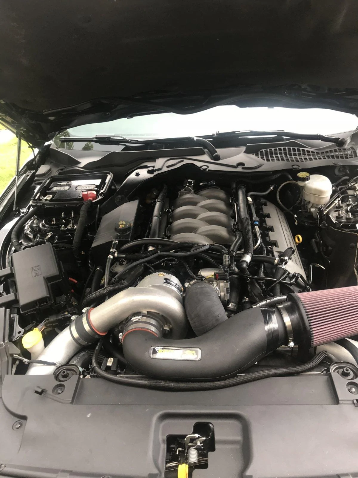

FBO minus cams, lund tuned on 93. beefcake special stage 2 paxton. Made 754 on a good 60 degree night 29% humidity without cai tube. So real world conditions probally 700.

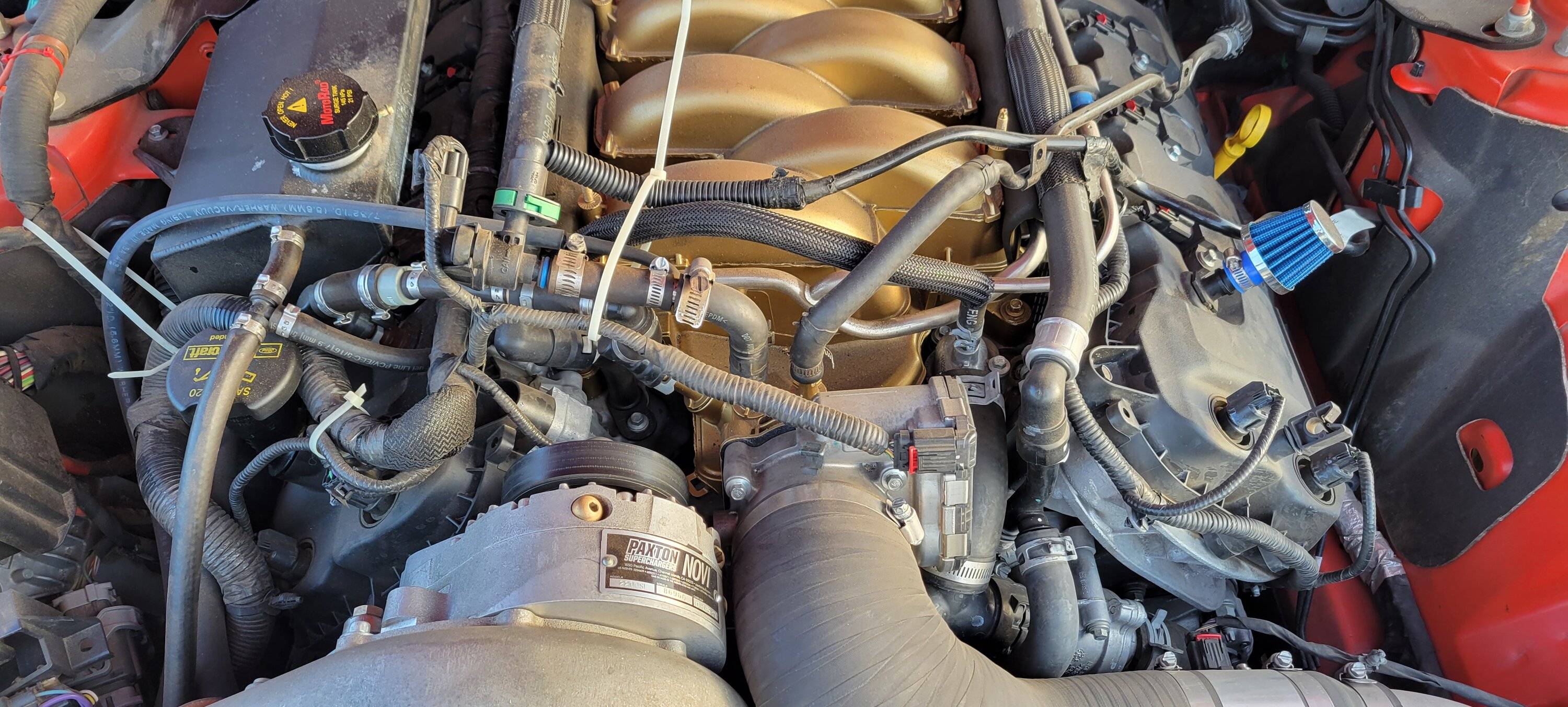

Ik this is old, but how did you fit it without the spacer? I have an 18 manifold on my 16 and the throttle body hits the coolant hose that ys off into the thermostat and radiator.
This is a really old pic but does this help? I have a gen3 manifold and my tb fits just fine without a spacer

Hmm odd, I had to buy a steeda spacer to get mine to fit and even that was close.
