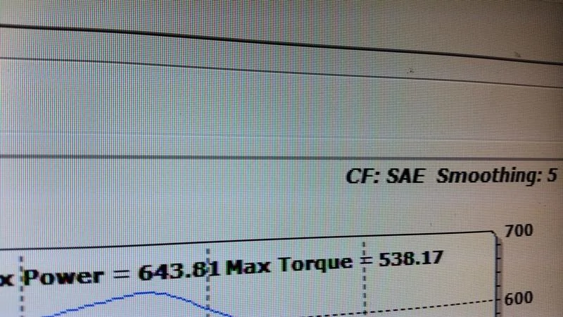

When we rolled this car in, our intent was to just tune it for 93 considering the fuel system. On the first pull it made 607/500, on 16* of timing and around an 11.5 afr on the sniffer. I noticed about 1/2 a degree of knock retard so I really started questioning the quality of fuel in the car, as the crew over at CPS made sure there was no interference anywhere that could cause false knock. Being though I had developed and done quite a few cars flex fuel, we decided to enable it on this car and throw 5 gallons of e85 from our local gas station down the road. After a couple minutes adapting the car by rolling it on the dyno we decided to make a power pull.
Again, this car is stock. We intentionally stopped making power at 6850 to keep it safe considering it really doesn't have the rest of the supporting mods I personally would prefer. The above was done with the 3.8 pulley that the Paxton ships with.

Nice! That's the first car I've heard of to run a flex fuel tune without the updated fuel system on a boosted car.

I'd love to see the complete graph for torque and hp together.
