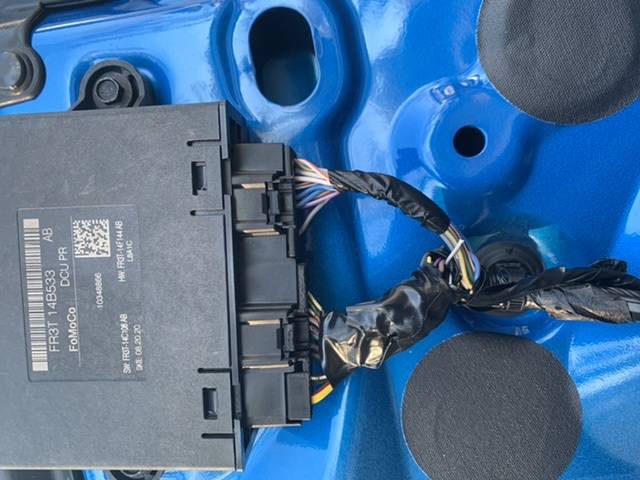

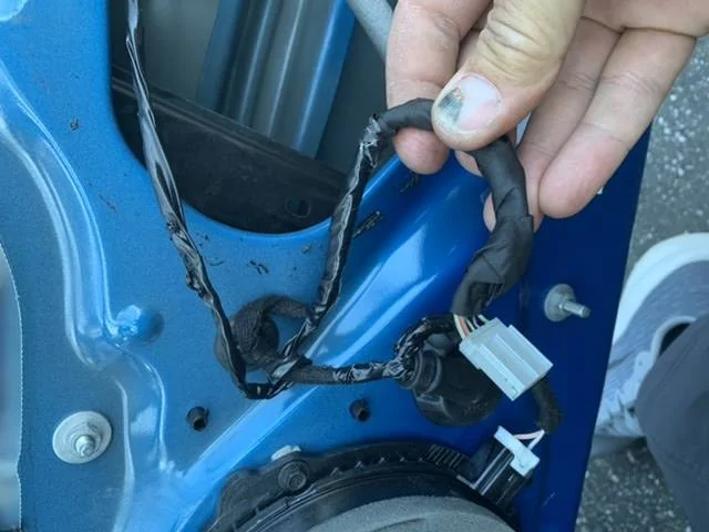

Almost two weeks later, the window issue is back. Since the dealer gave me the ok to take the panel off while waiting for the new clips, and stated that the problem was resolved with a bad connection on a pin in the connector, I figured I would save myself a trip to the dealer and ā€œreconnectā€ the bad plug.
To my surprise I found a Mickey Mouse cut and spliced wires behind the door panel. This is frustrating as it is a 2500 mile two month old car. The wires obviously were not the problem, as the same issue has returned! I am dismayed by the diagnosis used to resolve the issue.
Should I ask for a new wiring harness?

Update on the window issue:
Took the car to a nearby large auto mall FORD dealer, where they started off with payment issues, without even looking at the car. They said I would have to pay for any repairs, then claim the reimbursement from ford technical center for the shoddy work done at my local dealer... One big PITA.
I left and went to a YELP recommended Ford dealership. They took in the car for initial inspection without an appointment, found the wire harness to be temperamental and occasionally faulty. They ordered a new door wiring harness and installed it the following week. Very pleased with the third dealer, will return when needed. The window has worked great for the last three weeks.
