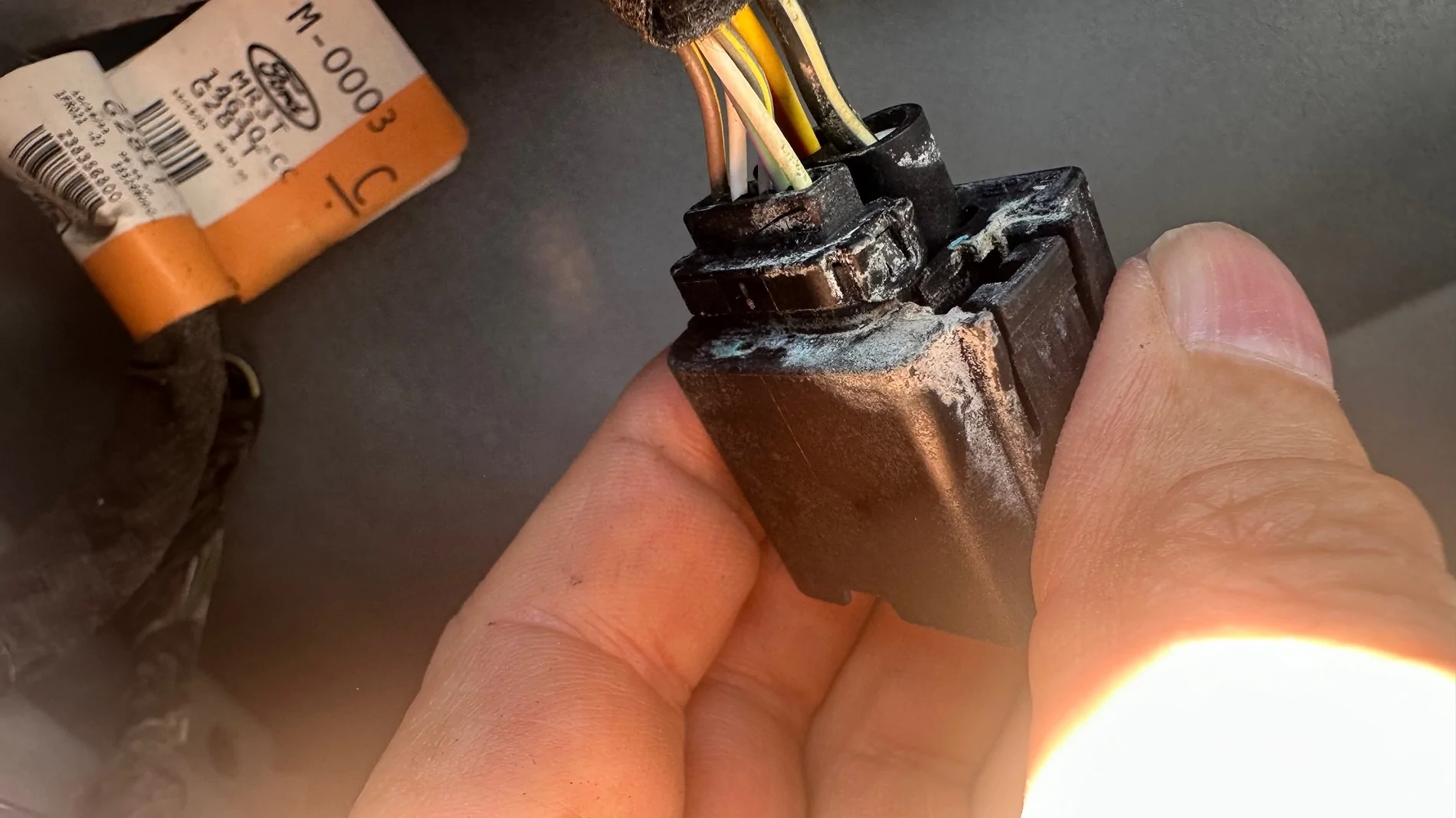

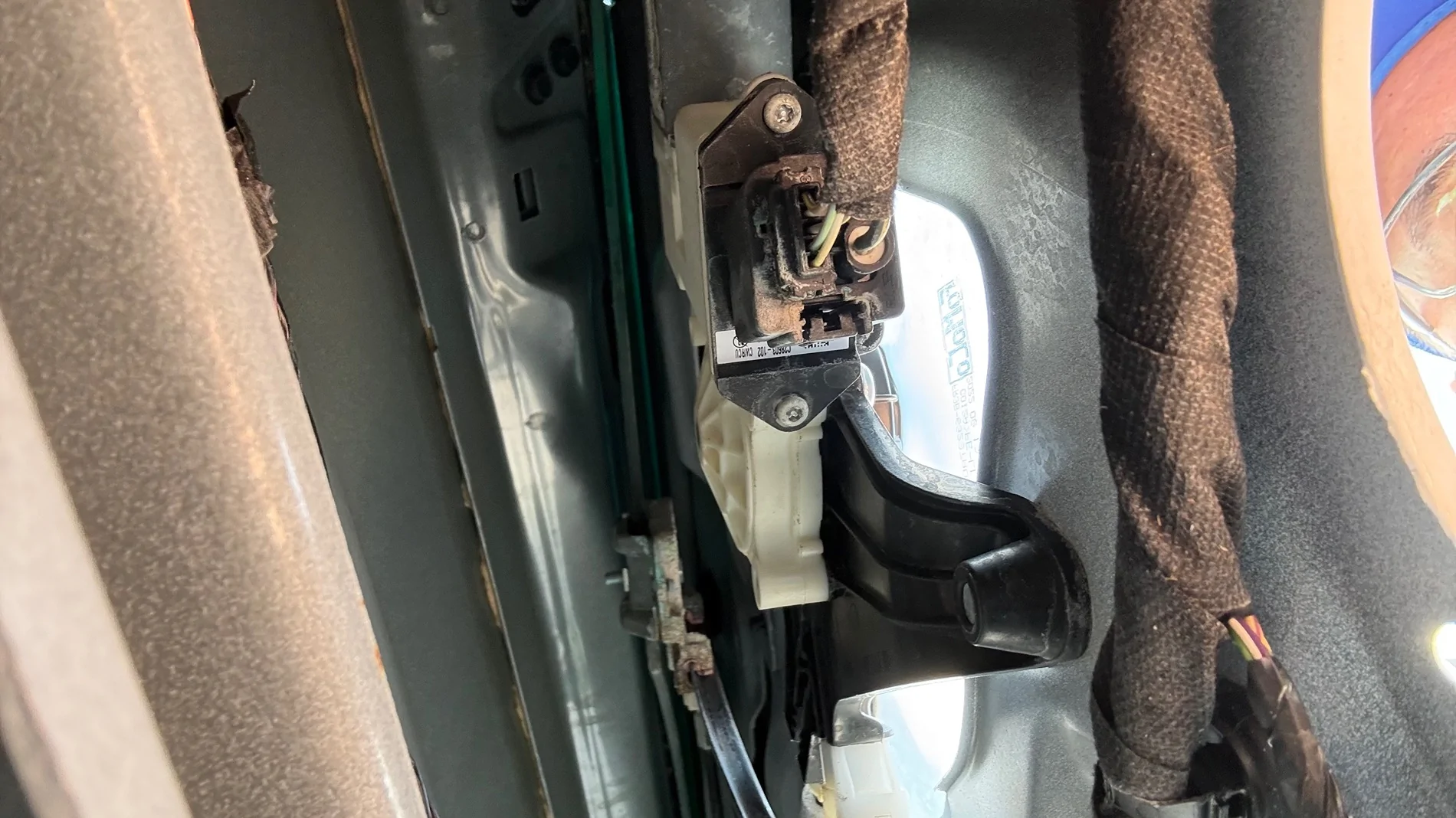

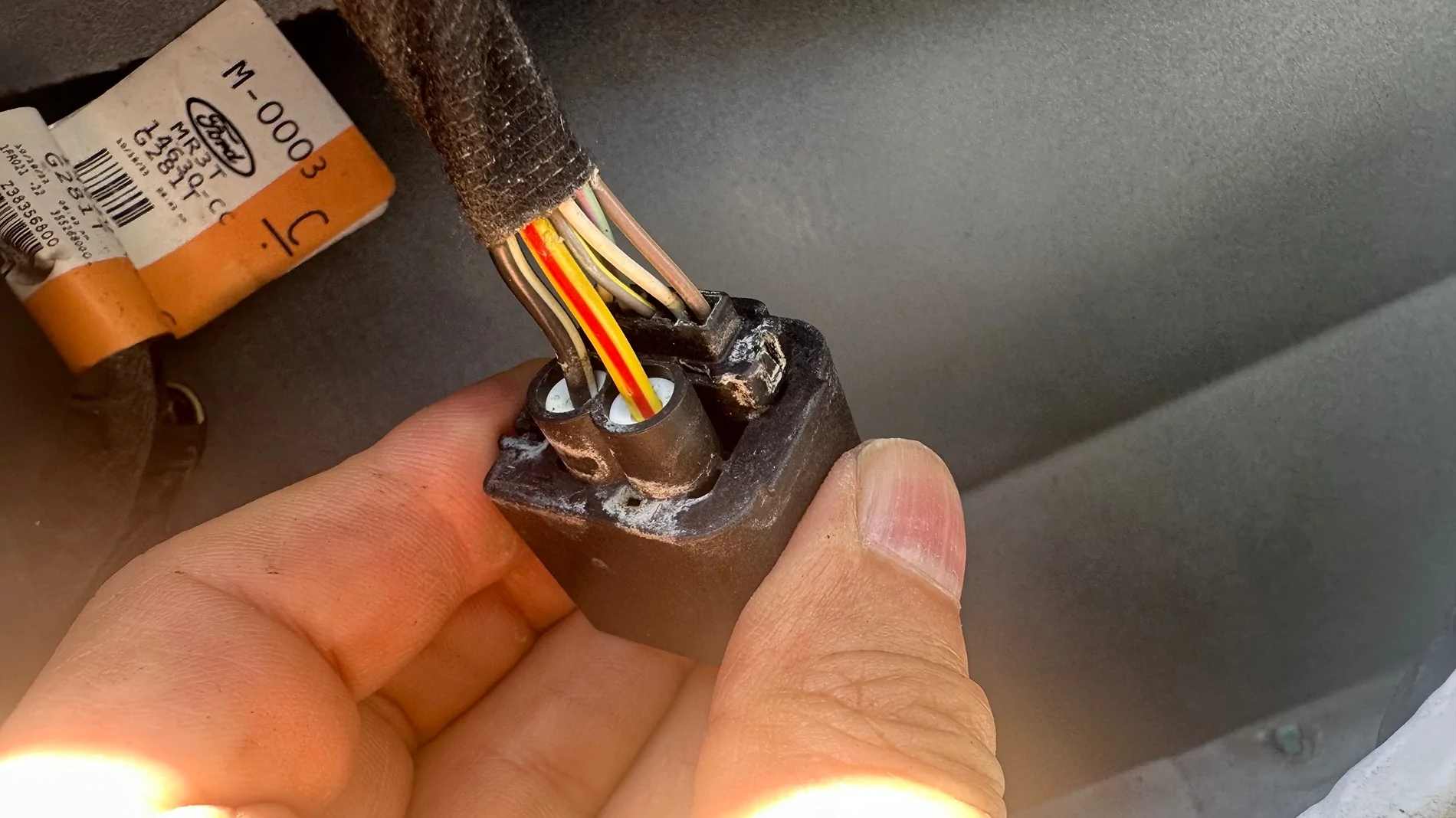

I bought my Mustang used, had it 1 week, and this window bounce issue appeared. The dealer had it 6 days, and didn’t fix it. Found the fix on YouTube. Cleaned the connector with electrical contact cleaner, then added dielectric grease. Put it back together and worked perfect. You can see the water contaminate in the pictures.
