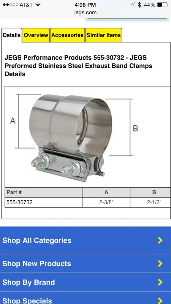

I bought stainless step clamps from Jegs and never looked back. They have a better holding ability than the clamps that come with most exhaust clamps.

These, and they are only $9.00
They have all sizes. I replaced every clamp on my car and now it's as tight as permanently welded connections.
