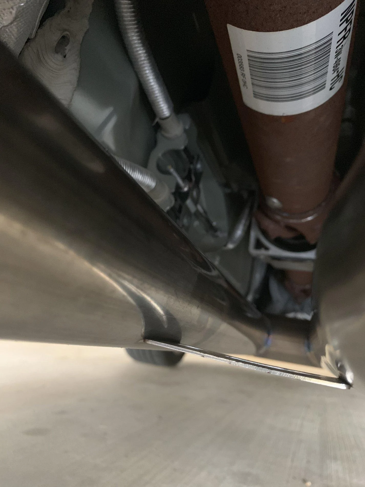

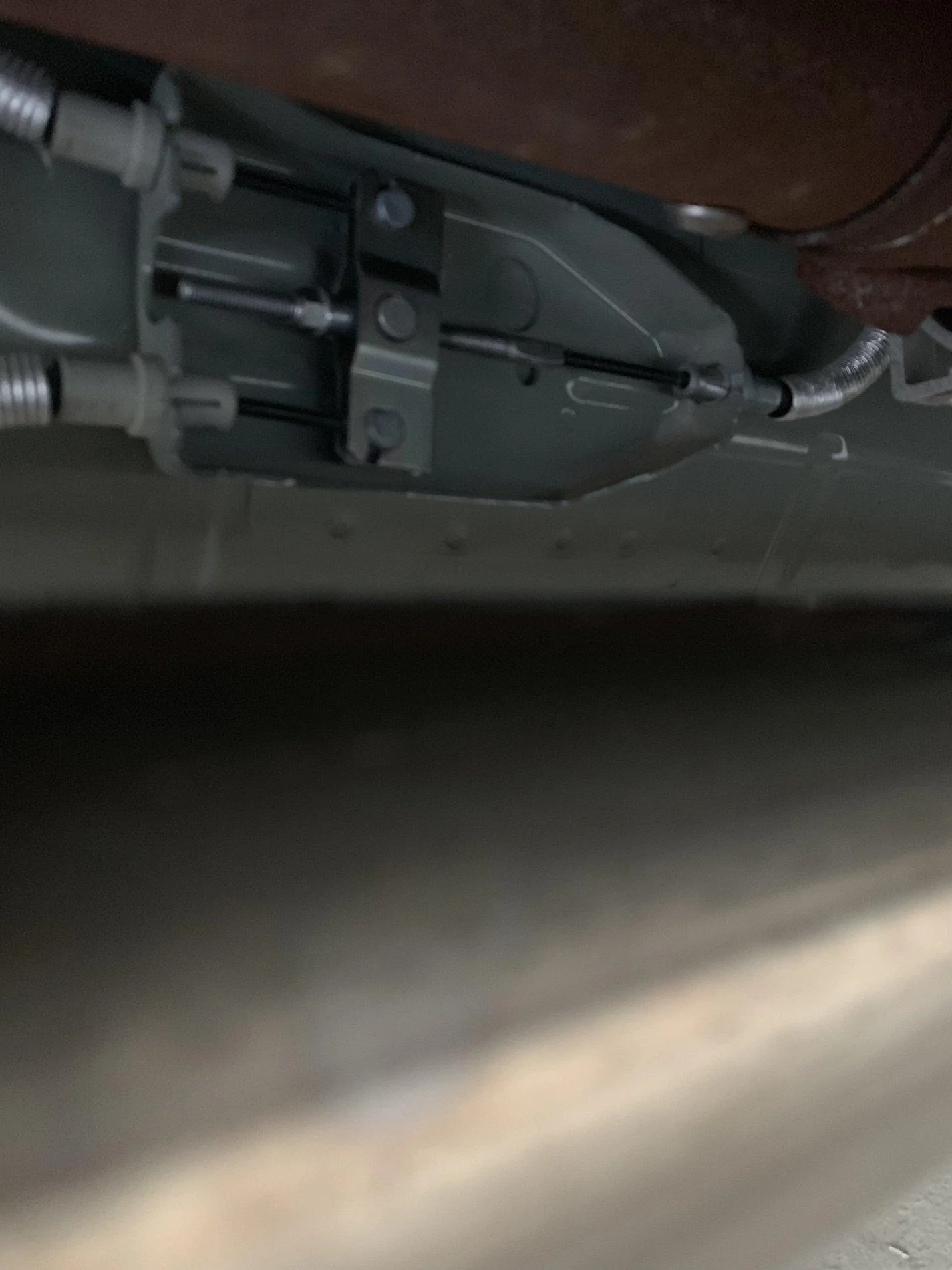

Anyone try this with the factory resonator in place? The only thing I could get on it was a deep well socket. i think I got it a little better but I have no way to tell if the other end of the cable is wanting to turn?
