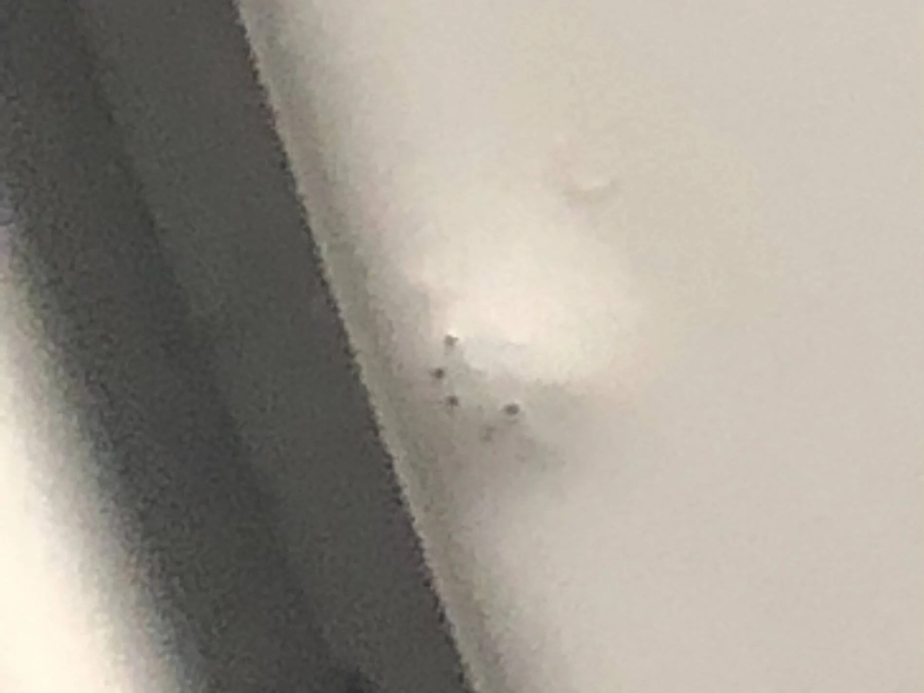

Just noticed this today when checking the air in the tires... frankly I can’t tell if it’s a run in the paint or something bubbling underneath. If it was a run, I feel like I would have seen it already though... I’ve been all over this car for a couple years now.
Searching only found paint bubbles on the hood, with an odd thread with a bubble on the rear bumper. If it’s a run, I’m inclined to leave it alone, but a bubble this early has to get fixed.
Thoughts?

Definitely looks like a reaction going on that has bubbled to the surface. I enlarged the pic as best I could and don’t see any trails on the surface for it to be a paint run or drip.

I agree with Cobra Jet, they look like rust or something is starting to form and is bubbling up.
Also, those little specs or dots you see is the rust trying to break thru to the surface.

The specs or dots might just be dirt - I took the pic right after I "cleaned" the area with my fingers while feeling the bumps. I'll clean it properly and get a better pic up close. The passenger side of the car is hard to get to since I'm parked up close to another car in the garage.
I agree with Cobra Jet, too - it doesn't have the trail of pain above the bump that I would typically expect with a run...
More to follow.

Agree with the others, that’s not overrun. Have you tried pushing on it? It may give a little if it’s a bubble forming.

I live in the rust belt, I've seen this a million times. I may be wrong but I don't think so, That looks like rust is starting to form and you got lucky catching it as soon as you did as it would be just a minor repair at this point.

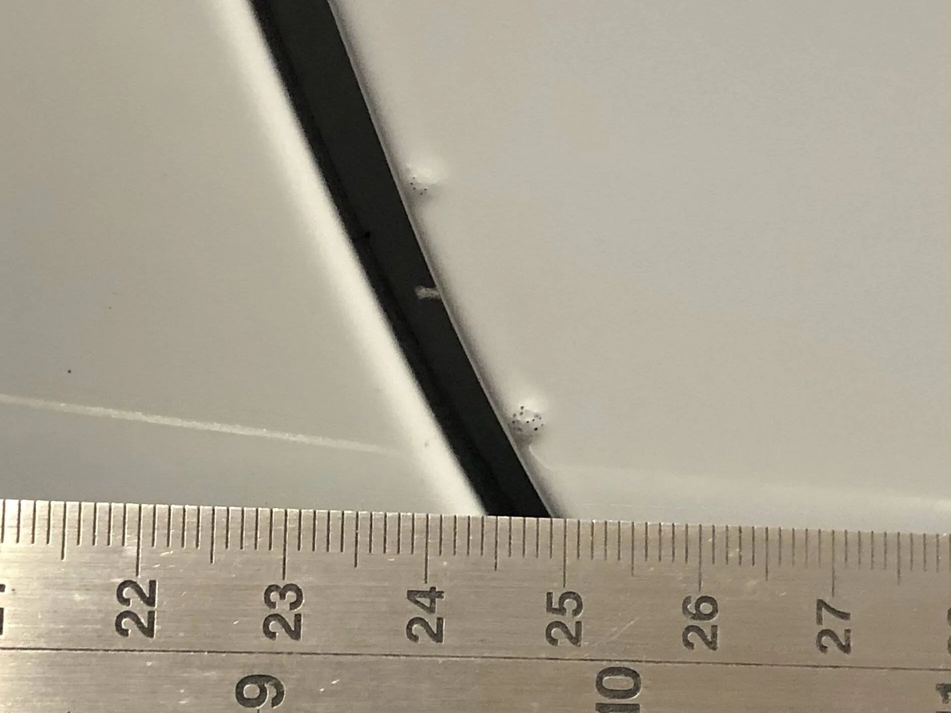

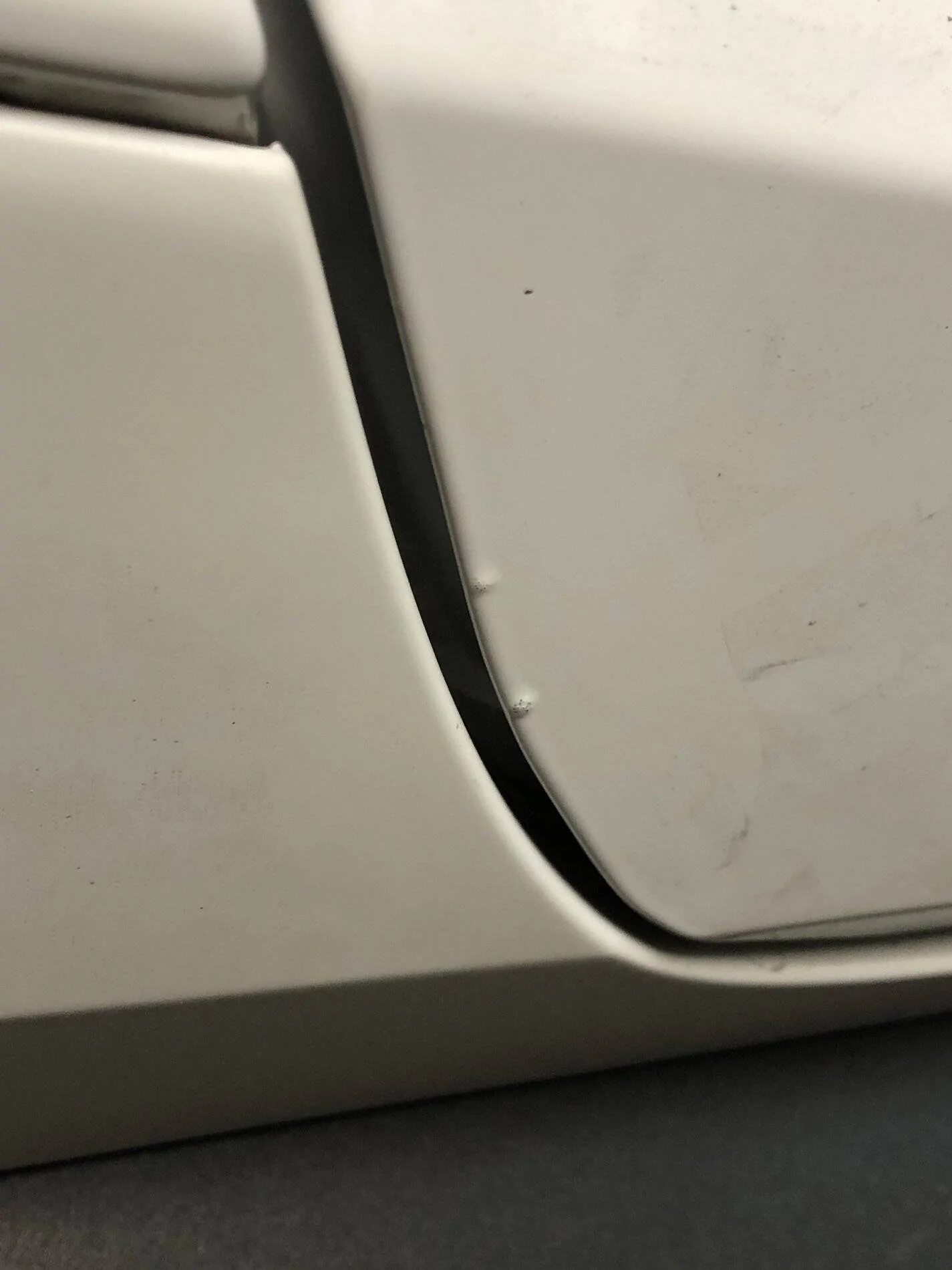

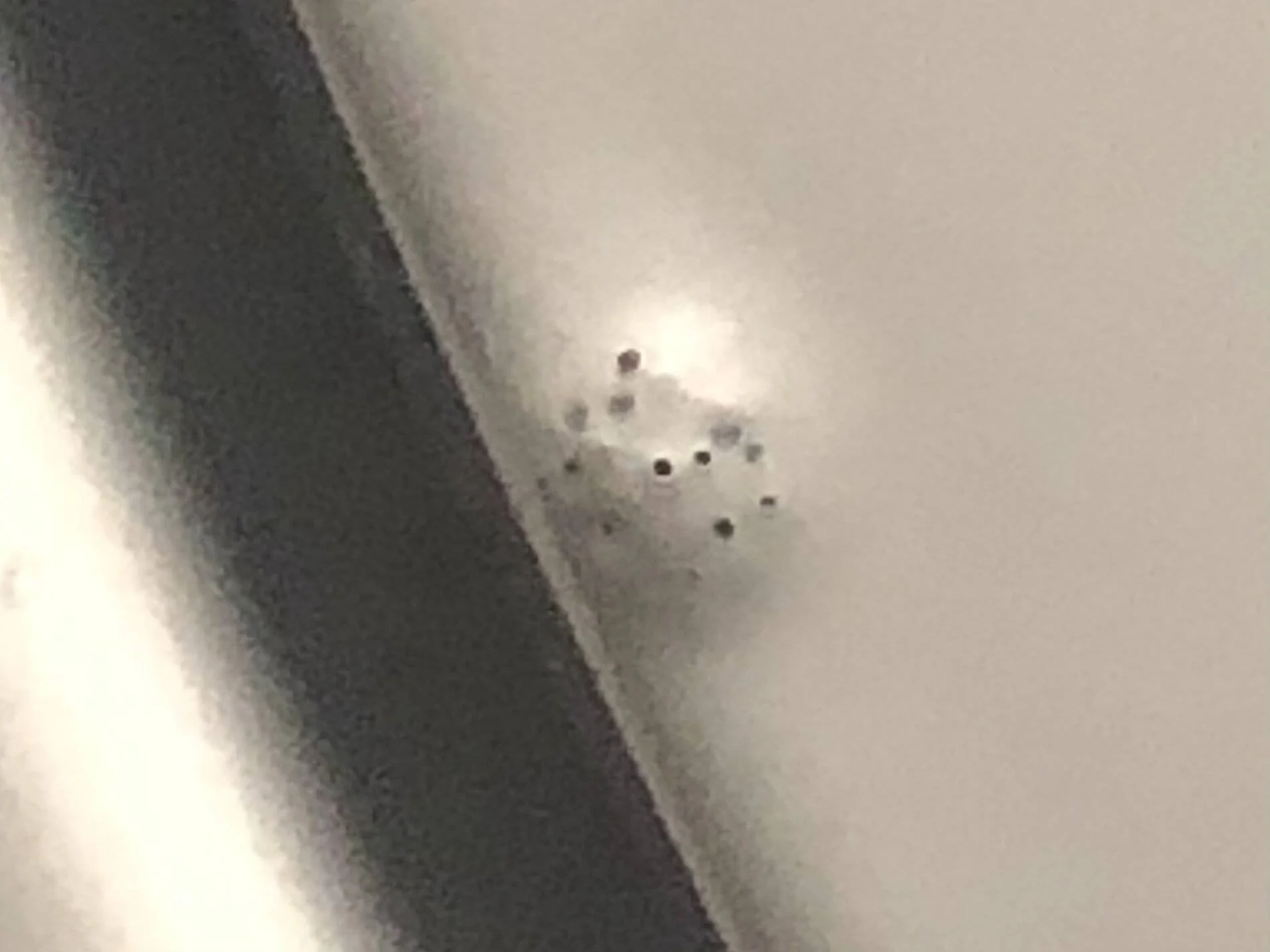

Ok, I cleaned the area better and the spots remained. I’ll let the photos do the talking, but it looks like I have a dealership appointment in my very near future.

Since your car is an 18 and it's happening already, it's a good bet that there are a few spots of contaminated metal that was not cleaned properly before the paint was applied.
Back in the 60's, 70's and 80's that was a common sight up here in the snow belt. It was not uncommon to see severe rust damage on a 2-3 year old car and see 5 year old cars in the junk yard already because it was too far gone to save.

Yes, in that new pic, there is def some bubbling that is occurring under the painted surface and is not on the clear, nor is it a paint run.
I’m going to attach this thread link here, but check out the PDFs in it, in case you’re wondering what is and is not covered under the paint warranty:
https://www.mustang6g.com/forums/th...pping-on-hood-edge.142195/page-2#post-3048339
Your 2018 comes with a 5/60 Paint Protection, where the metal does not need to be perforated to get a warranty claim approved. It’s also outlined in the Mustang Owner’s manual.
