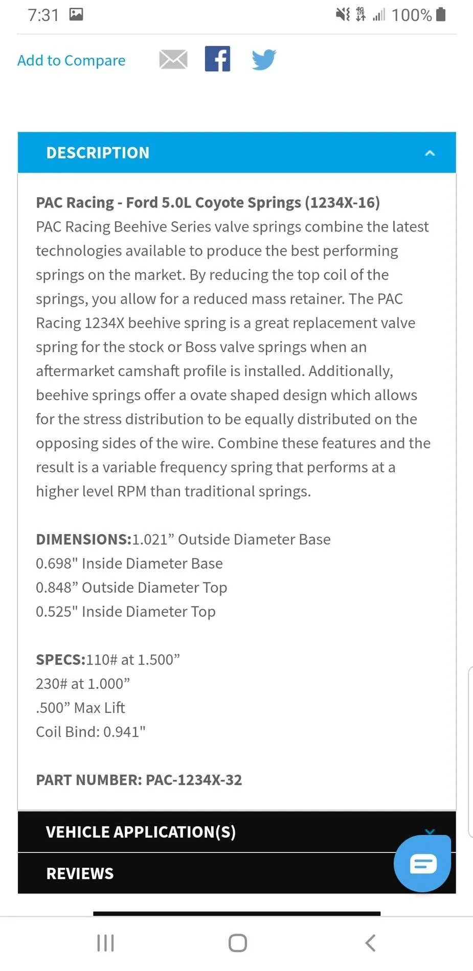

PAC 1234X-32 spring valve fitment
GT83
Nov 3, 2018
27
105
Caribbean
2015 Mustang GT Performance Package
Would this kit will be a great replacement from stock spring valve using STOCK camshaft and stock valves on a 5.0??
