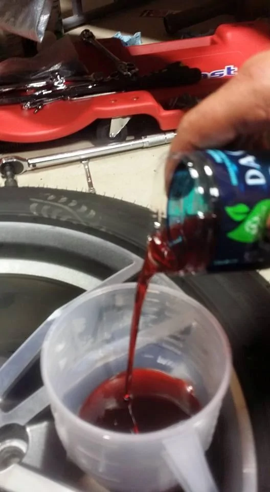

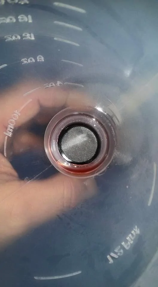

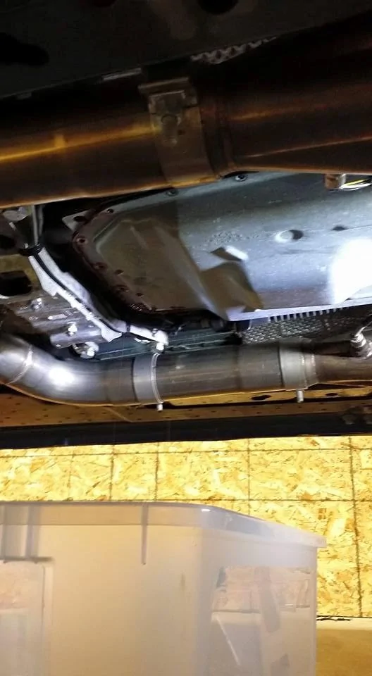

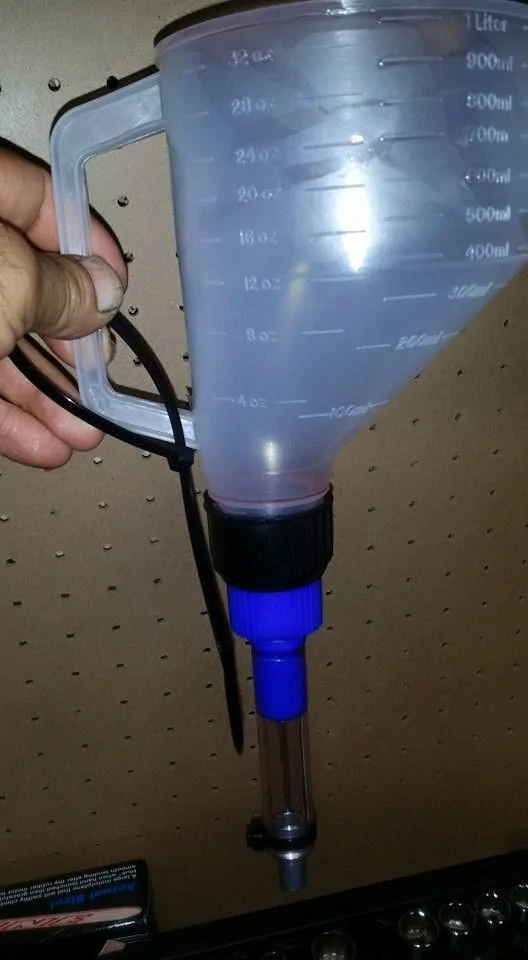

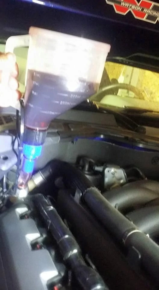

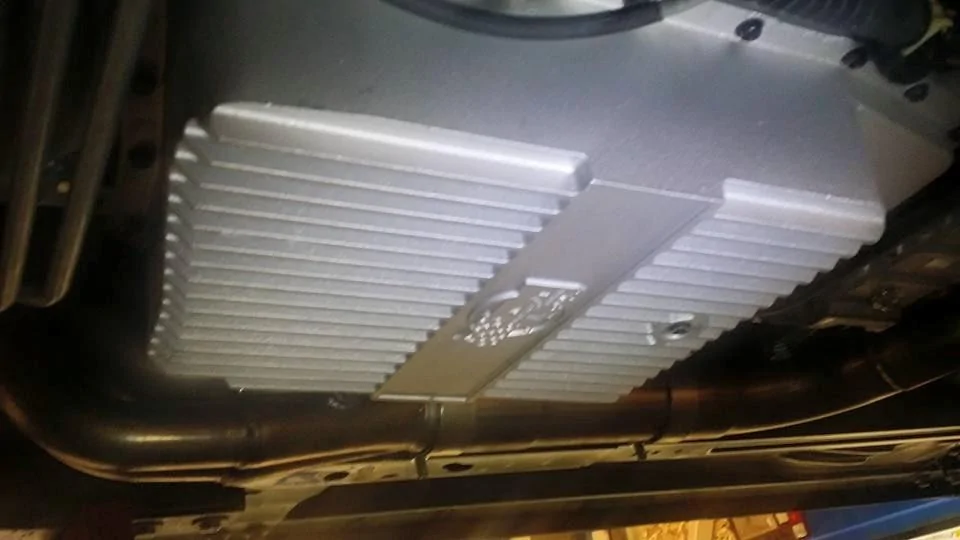

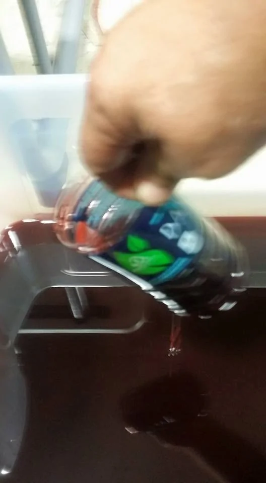

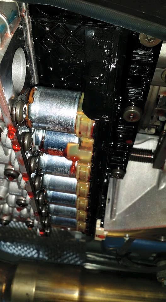

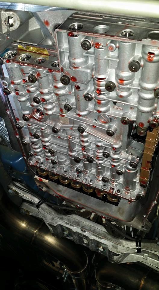

Another great product and easy install. I bought a 50 some qt storage bin (my Dad's idea, BOBS550) from the local dept. store, Meijer in my case. This worked great, not one drop or splatter. I installed the dip stick last week, this makes refilling much better.

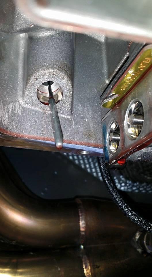

What dip stick did you use, the one in the PA Kit?

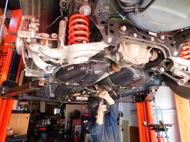

Does the pan stick low enough to get hit?

Yes I did use the one in the PA kit, if I remember correctly this is the kit part # PA68402. It is a Lokar dip stick, it has a mount tab, you have to fab something up on the car, mine is just tie-wrapped.
The pan is low but the k-member is just a touch lower, so the k-memeber should hit first.
I'm very happy with it. My main reason was to have more fluid to dissipate heat.
Here's the best pic I could find at the moment.

...and my Steeda G-Tech Brace is even lower.
