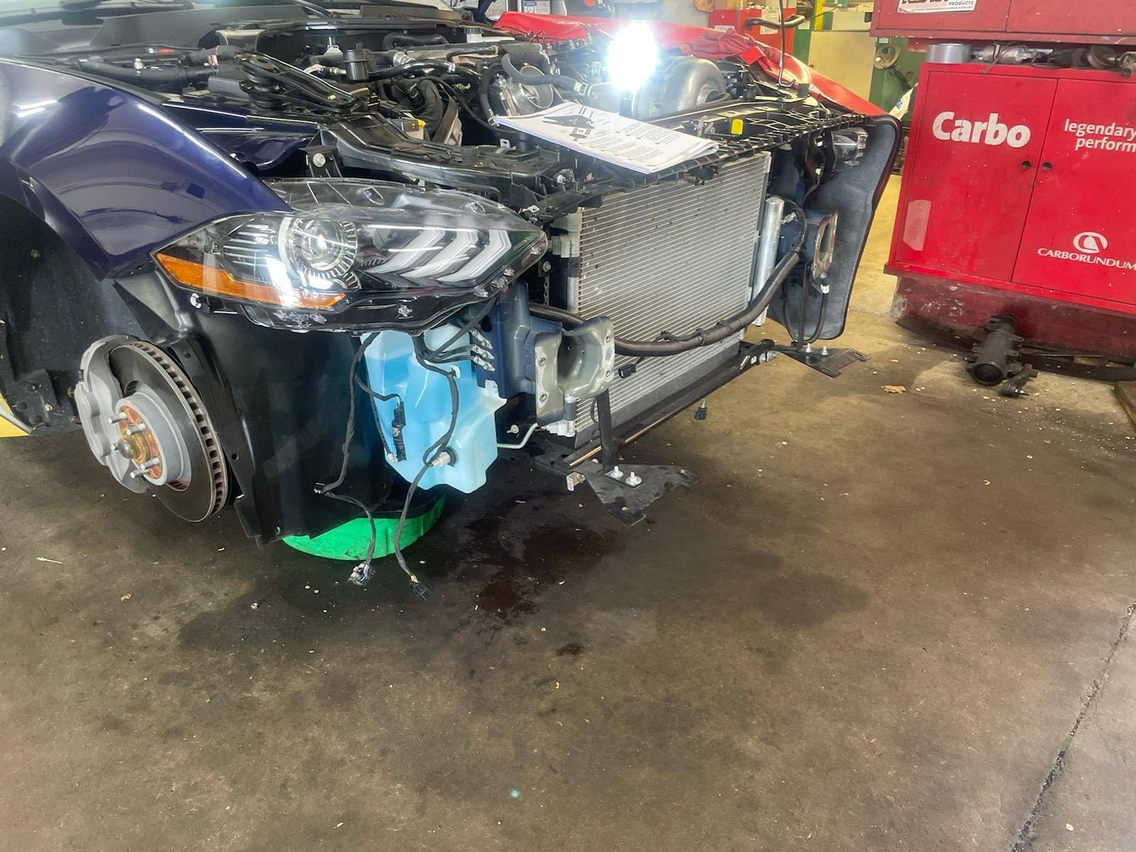

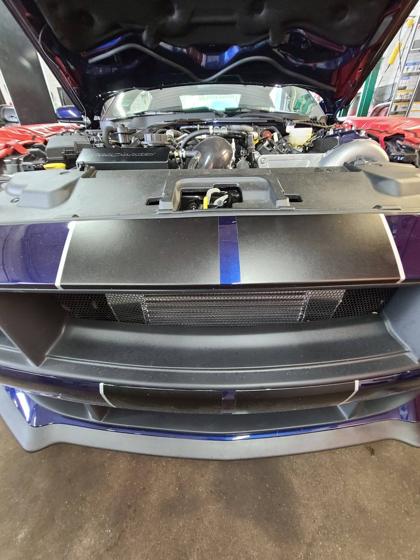

A couple of progress pics of my 2018 GT P1X install. Specs and details in my signature.

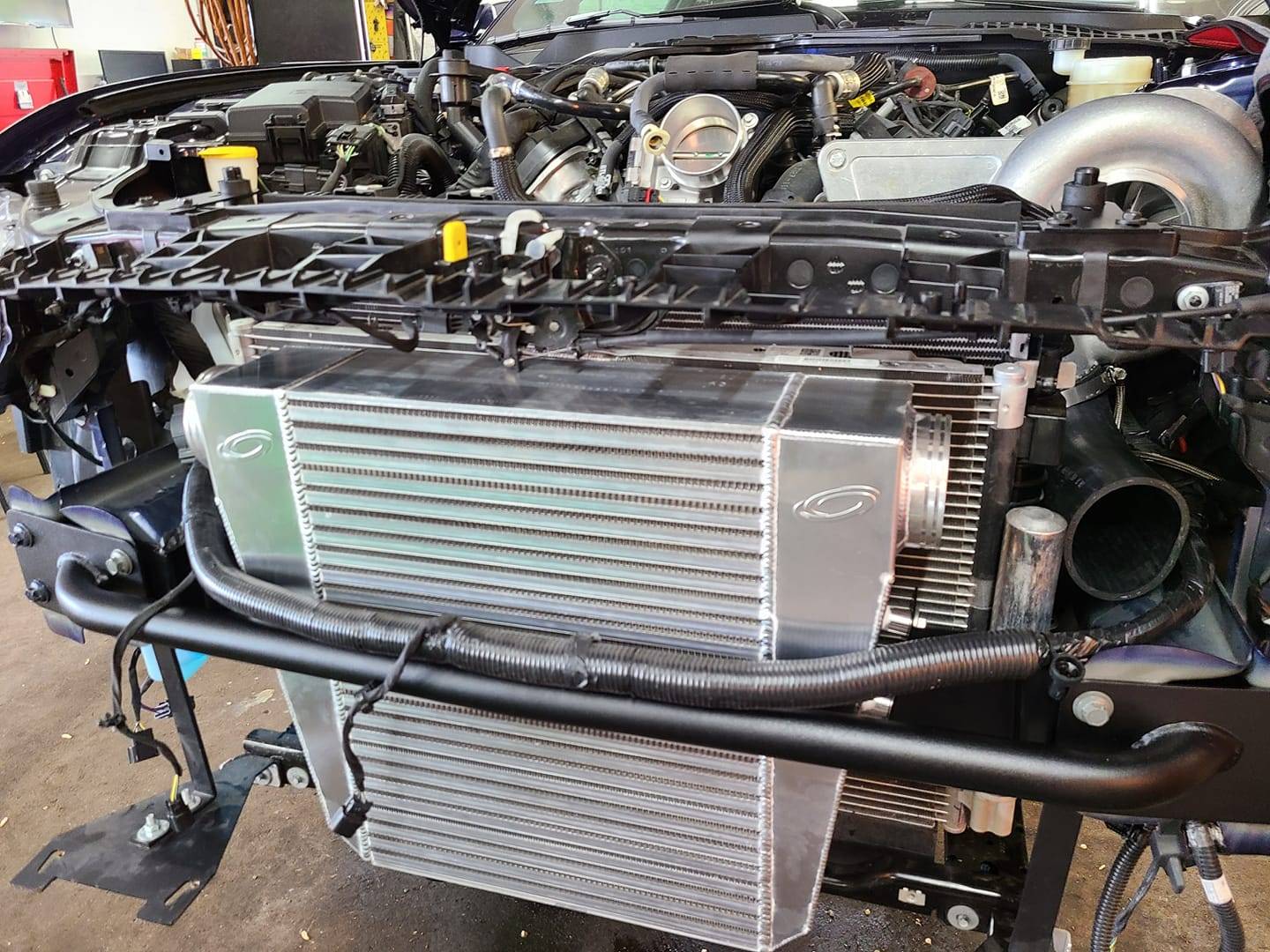

I got to see this setup in person in my area and that inter cooler is beefy!

Unfortunately Cali gets a different version which is Carb Compliant.

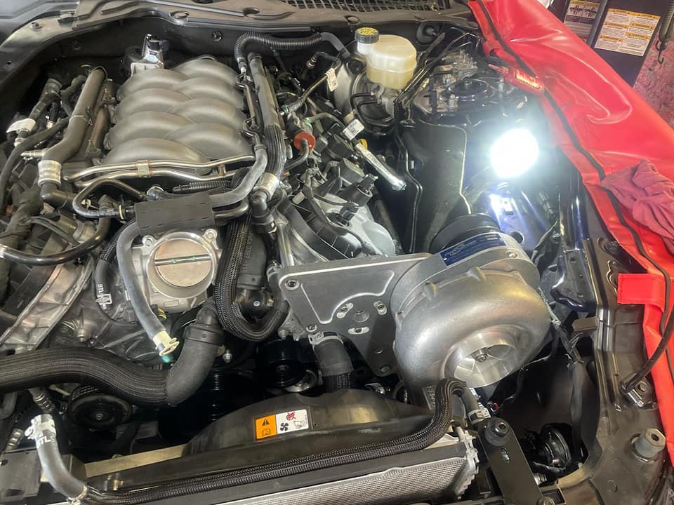

Awesome. Looks just like my install back in December 2020. I would suggest:
1) Use the heavy duty t-band clamps everywhere, the worm band clamps are marginal.
2) Get it remote tuned, can't stress this enough. Difference is night and day.
3) 8 oz. Boostane per fill up makes a noticeable difference with 93, I never run w/o it.
4) Good axle back exhaust will wake it up noticeably with the Pro-C.
Get ready to grin uncontrollably once you get it dialed in. Power is astonishing.
Get ready to buy new wheels and tires. You will have no traction below 50 mph. Tires will spin at 65 if the roads are wet with stock tires (ask me how I know).

Lund is Tuning it. I will be on E85 as soon as the 1/4 tank runs out. I don't intend to run 93 anymore, but will keep boostane in the trunk incase E85 is not available. I'm already on drag radials. They were needed with just the E85 tune.

Yours will be more of a monster than mine with E85.
Wish it was available in my region, I would definitely run it.

They are beasts on E85.

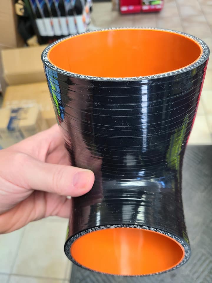

Now in the fuel system stage.
