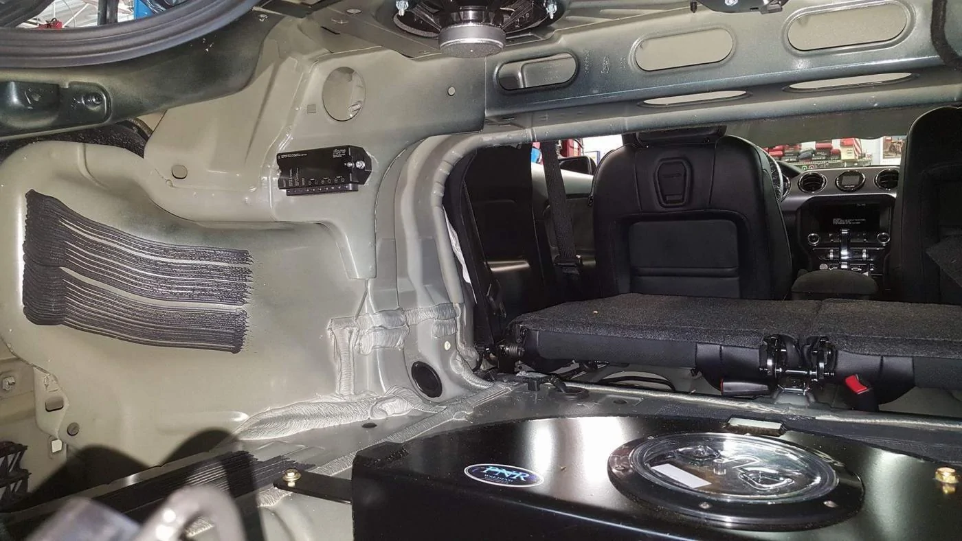

The guys at Finish Line have been going to town on it. They have the OPG's, crank sprocket, and BOSS 302 tensioners are installed, along with the ATI 20% damper. Then they moved onto the Fore Innovations fuel system. They have it mostly plumbed and wired. Friday they received Whipple's new massive heat exchanger and PNB 7 gallon trunk mount tank. Brian & Brandon will get all the necessary hardware together to plumb the new tank to the heat exchanger.
Tomorrow the new driveshaft and Zeitronix Zt2 datalogging system with wideband o2, fuel pressure, map, and ethanol content sensors. Hopefully by Thursday, the Circle D converter will arrive. All the guys at Finish Line Performance have been great, Wade, Brian, and Brandon, as well as Beefcake have made it really nice to work with!

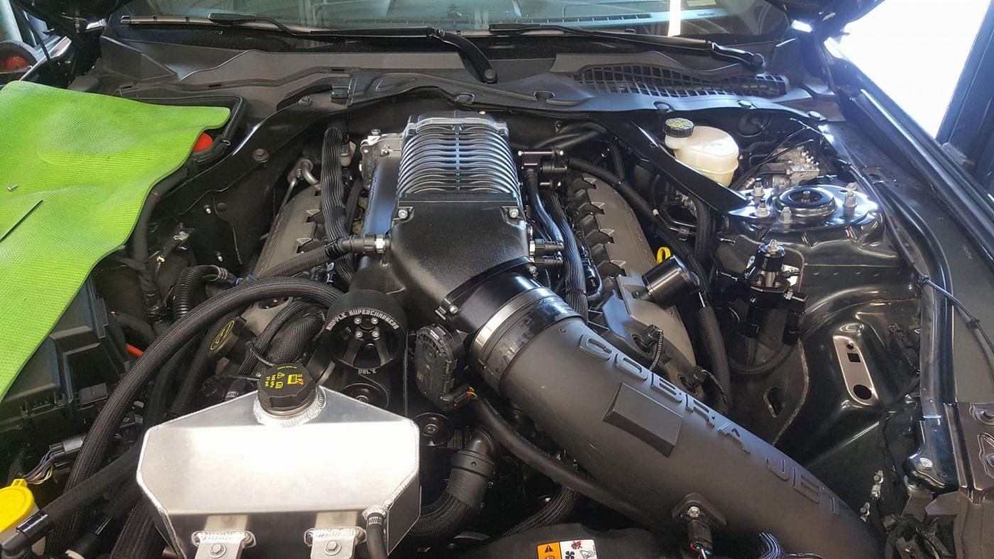

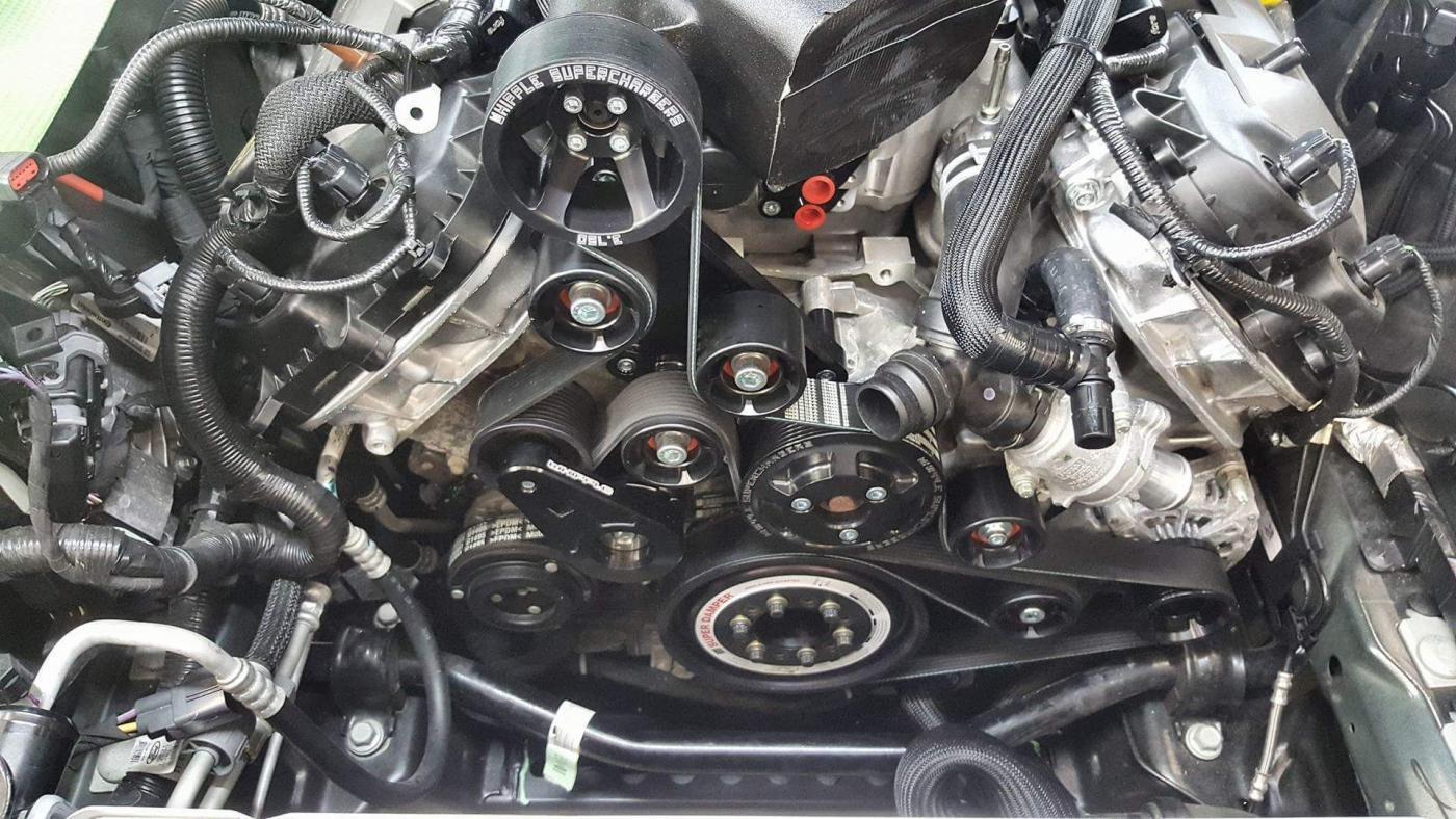

So the guys at Finish Line Performance & Team Beefcake Racing have been great! The car came to life this morning and they are working with the guys at Lund Racing and are doing some idle and slow rev logs to get the tune dialed in. Here's a few pics from the build.

Ahhh! that Cobra Jet intake just looks legit! Very nice setup and if I was going custom calibration I would have looked into the CJ intake.
