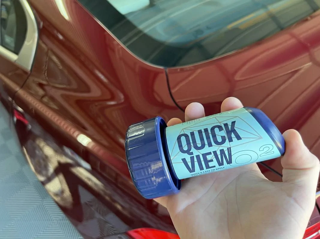

But.......................I absolutely love Gyeon Q2 Quick View.
Gyeon Q2 QuickView - ESOTERIC Car Care
I have been using this since it was released and really enjoy the ease of application. It's said to offer "excellent self-cleaning" characteristics and will offer up to 6 months, expect a little less on a daily driven car, expect up to 2 years on a garage queen.

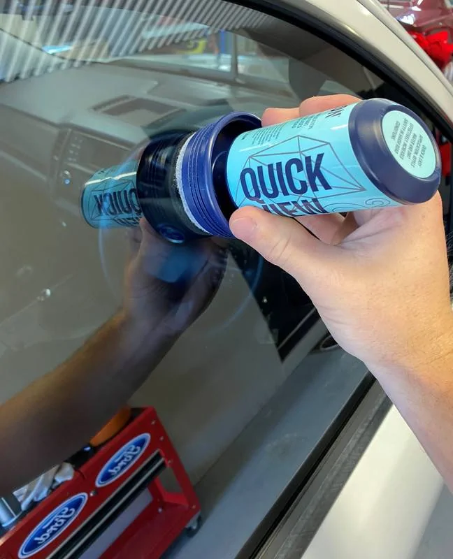

Application is its hallmark though -
1/Clean the car/glass as normal.
2/Consider claying the glass to improve the bond.
3/Clean the glass with a IPA type product (Carpro Eraser or Gyeon Prep) or IPA based glass cleaner.

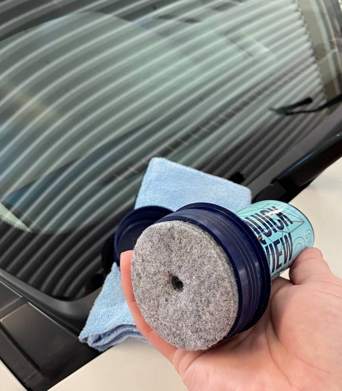

4/Remove the cap, squeeze to release the product into the integrated felt applicator.
5/Apply the product to the glass in circular motions, apply to all glass in one hit.
6/Allow to cure for 20 minutes.
7/Remove the residue with a damp towel. Must be damp.
8/Clean the glass with your chosen glass cleaner to remove any streaks from the residue removal.
Now, that may sound like a complicated process, but its super easy and longest part of the job is the 20 min cure, all up you should have this done within a 30 min period.

Be sure to wipe the threads on the bottle before putting the lid back on the bottle, and I would store it upright.
When I attempted to open the bottle for the next application, the product had welded the cap shut.
I ended up having to use the product like a ceramic coating, applying the liquid to a small applicator rather than using the integrated felt applicator. The finished result is not affected, rather the application becomes a two-handed process.

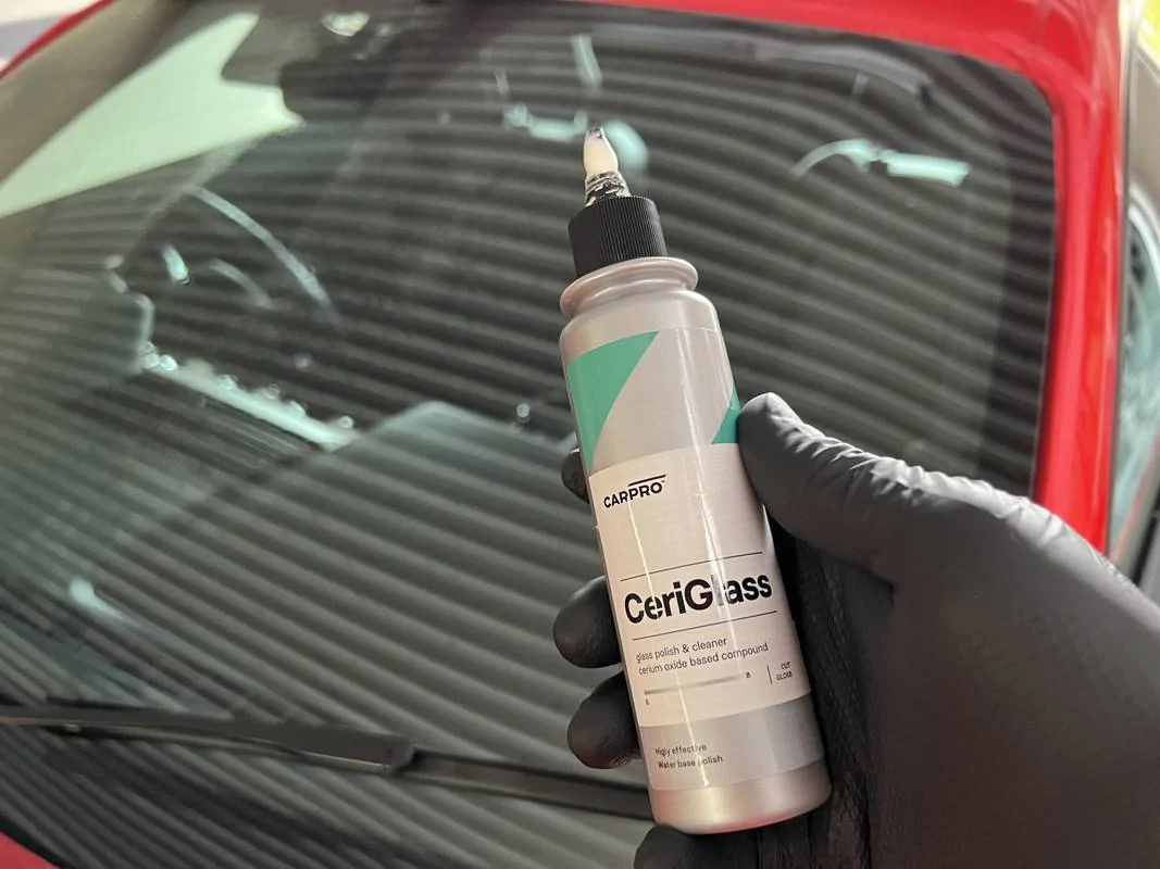

Last time I did a full detail on my Mustang, I also polished the glass with CeriGlass.
After that, I ended up giving the car a quick rinse down to remove the polishing dust. After polishing, the water was completely flat against the glass with absolutely no water beading. This made the drying process so much harder and made me appreciate the brilliance of a glass coating.
I have since moved away from CeriGlass though. Unless you are dealing with heavy water spotting and minor scratches, the horrible user experience from CeriGlass is not worth the bother. It's such a messy product, even with care it will splatter everywhere and you need to provide supplemental lubrication by misting water onto the pad, which increases the mess. It's also extremely abrasive, so you must be super careful removing any residue from the paint.

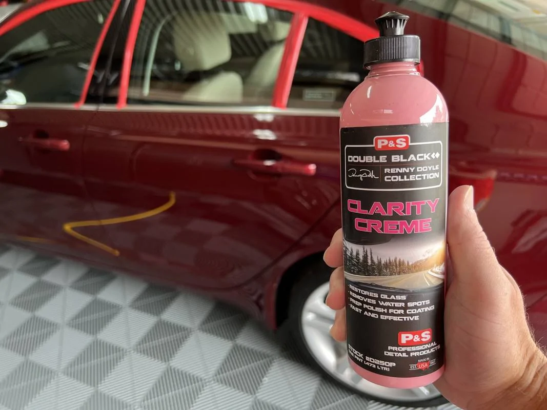

P&S Clarity Creme is a much nicer product to use. Think of this as a glass deep cleaner rather extreme polishing agent. (Glass needs aggression and plenty of patience to remove scratches, ie CeriGlass and a hard glass polishing pad.)
P&S Detail Products - Clarity Creme Glass Polish | The Rag Company
P&S Clarity Creme Glass Polish (detailingshed.com.au)
I use this on a 3-inch machine with a blue Lake Country SDO pad, but any cutting pad will be fine.
While you may think your glass is "clean", after a quick hit with Clarity Creme and a glass sealant, the "clarity" of the glass will be night and day, almost like it's not even there.
