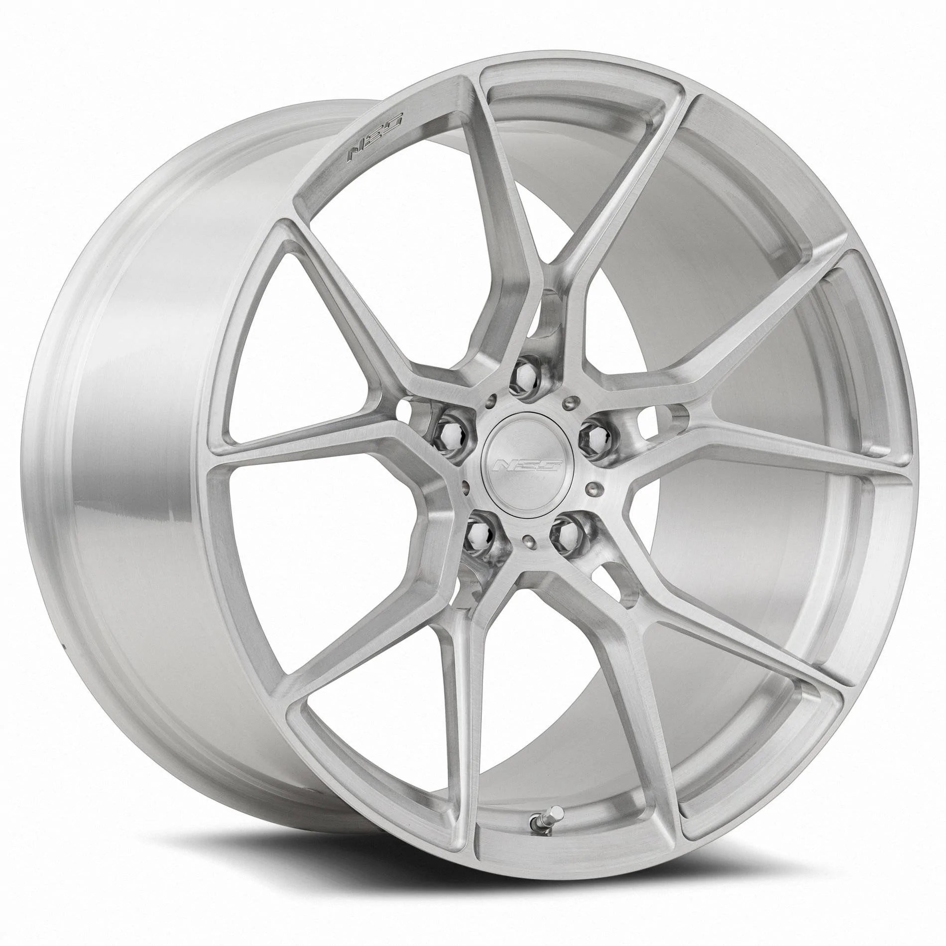

Here's my question: I want to know how to spec these out. I have a 2019 PPL2, and I'm going 10.5 x 19 for the rears and 10 x 19 for the fronts. One thing I don't like about the PPL2s is how the tire/rims protrude a bit - hence wanting to go 0.5 inch narrower. I want the inside of the rims to line up where my stockers are, but the outer rim to lie inward 0.5 inch, so the end result is more flush with the fenders.
Also, I'm thinking I want 305/35 19s in back and 295/35 19s up front - please let me know if that's a concern. I want to fill out the fenders a little more.
