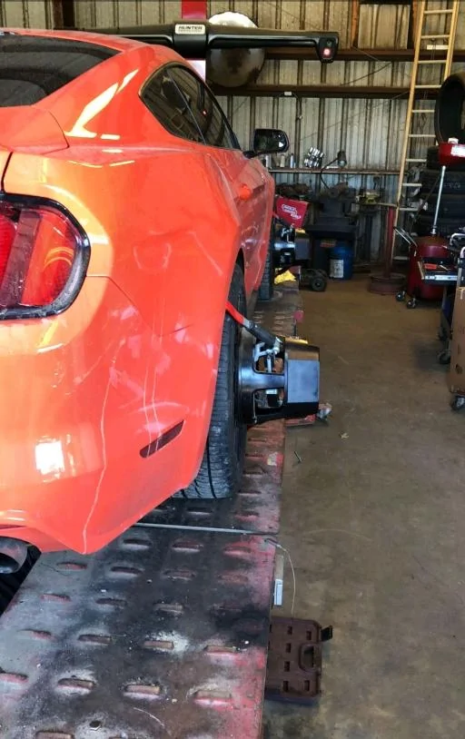

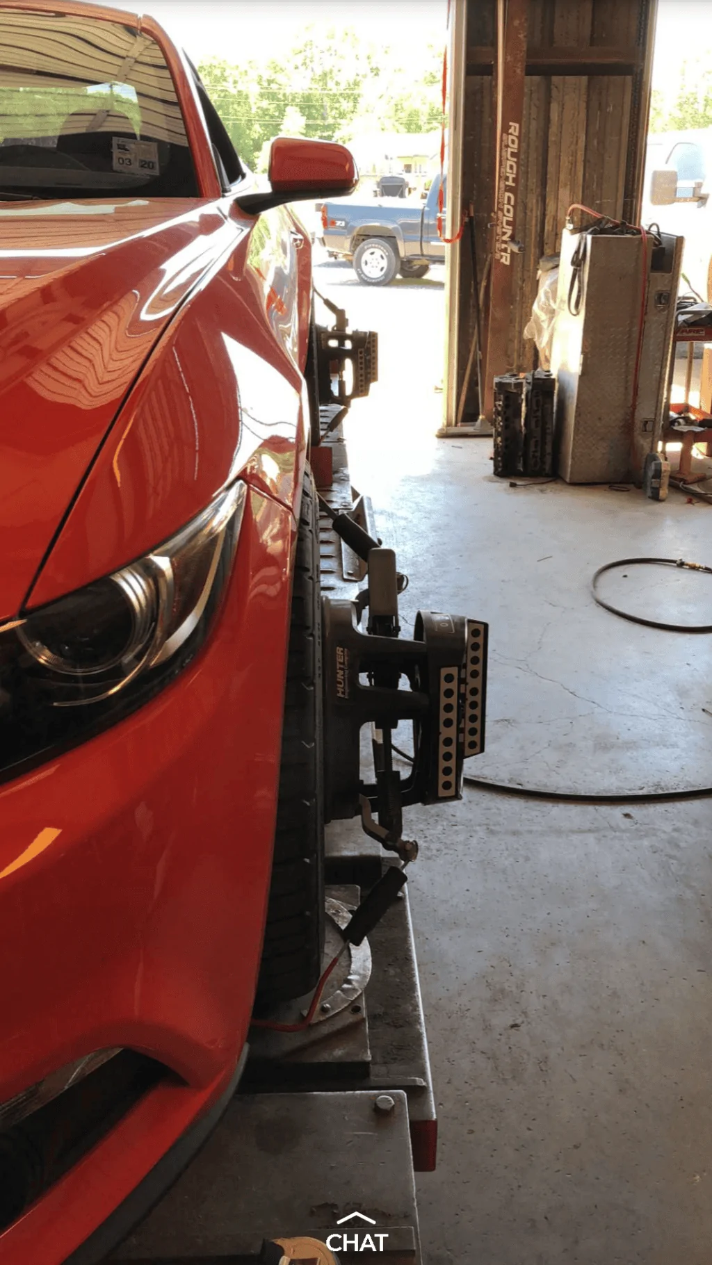

Quick question, can I run my 25mm spacers on all 4 corners with the SP080 springs and PP GT wheels? Hopefully I can.
Marvinmadman
Dec 9, 2016
841
166
Louisiana
16 EBM
Yes you can. But the rear will need more than 1.6° negative camber to sit flush with the fender. I'm at 1.6° with 20mm rear spacers and its pretty flush back there.
