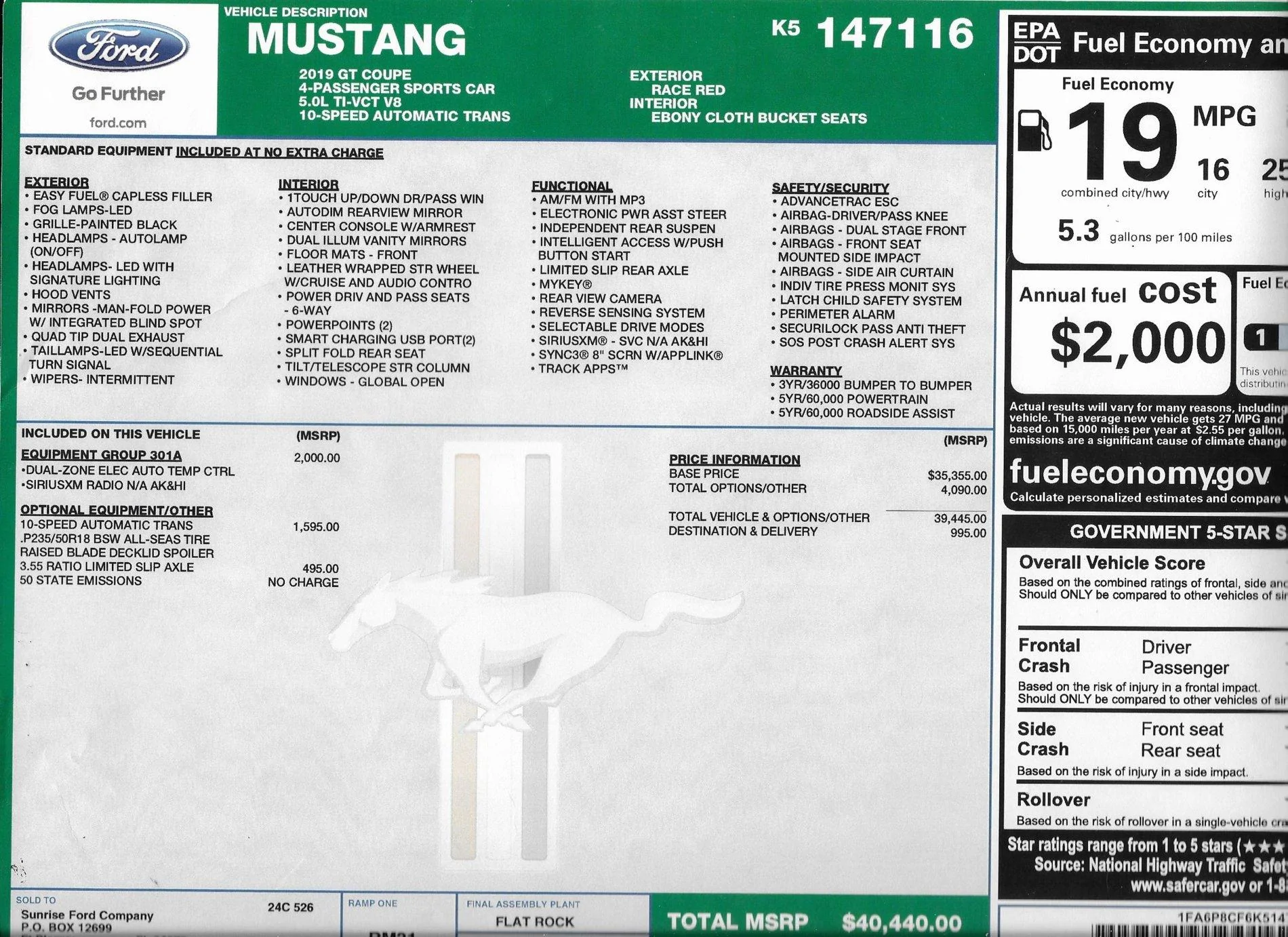

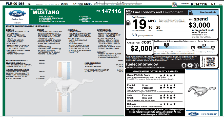

I ordered my 2019 last Sept with delivery in Jan 2019 Base GT A10 301A (for drag mode) and 3.55s. On some paper work at delivery it stated 3.55 with Torsen axle, I am not sure if this is true but with drs it hooks great at the track.Anyone know if the Torsen is included with 3.55 option. Thanks
Post your window sticker.

That reads like a standard clutch style limited slip. Which for drag racing is better

Very interesting. I wasn't shopping for an auto, so I didn't know they charged for 3.55s.
I'd think the Mustang build site could clarify what type of diff it is.
ETA; I'd think it's not a Torsen. On the Mustang build site, it reads;
3.55 Limited Slip Rear Axle
A 3.55 limited slip rear axle is included with the 2.3L EcoBoost® High Performance Package on Mustang EcoBoost and EcoBoost Premium. Standard with the 5.0L Ti-VCT V8 engine with 6-speed manual transmission; optional with the 5.0L Ti-VCT V8 engine with 10-speed SelectShift® automatic transmission.

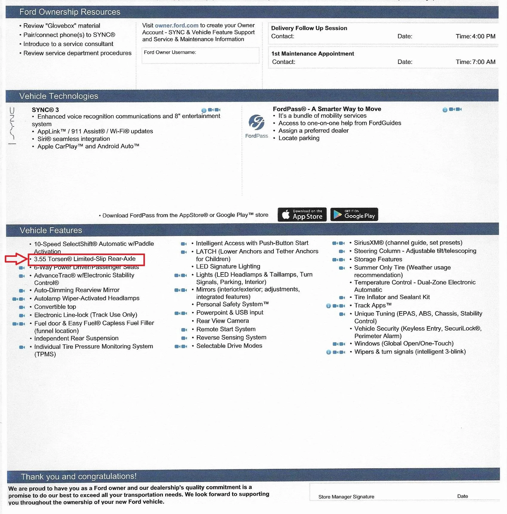

It`s been running great at the track with DR`s in drag mode 11.70 @ 119.9. This page was in with a packet of paper work at delivery.

Yeah, the optional stand-alone 3.55 is not a TORSEN, the 3.55 that's "bundled" with the PP is, but the info in that first post is curious, probably just bad data - what's that from?

This form also states that you have a convertible top, so obviously it's not correct.
