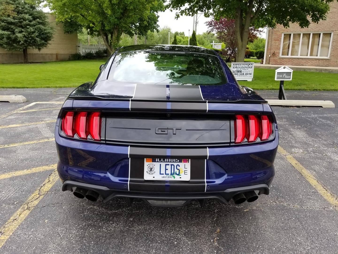

Big Worm Matte black is what I have. I had them ceramic coated for a little easier mantainence.

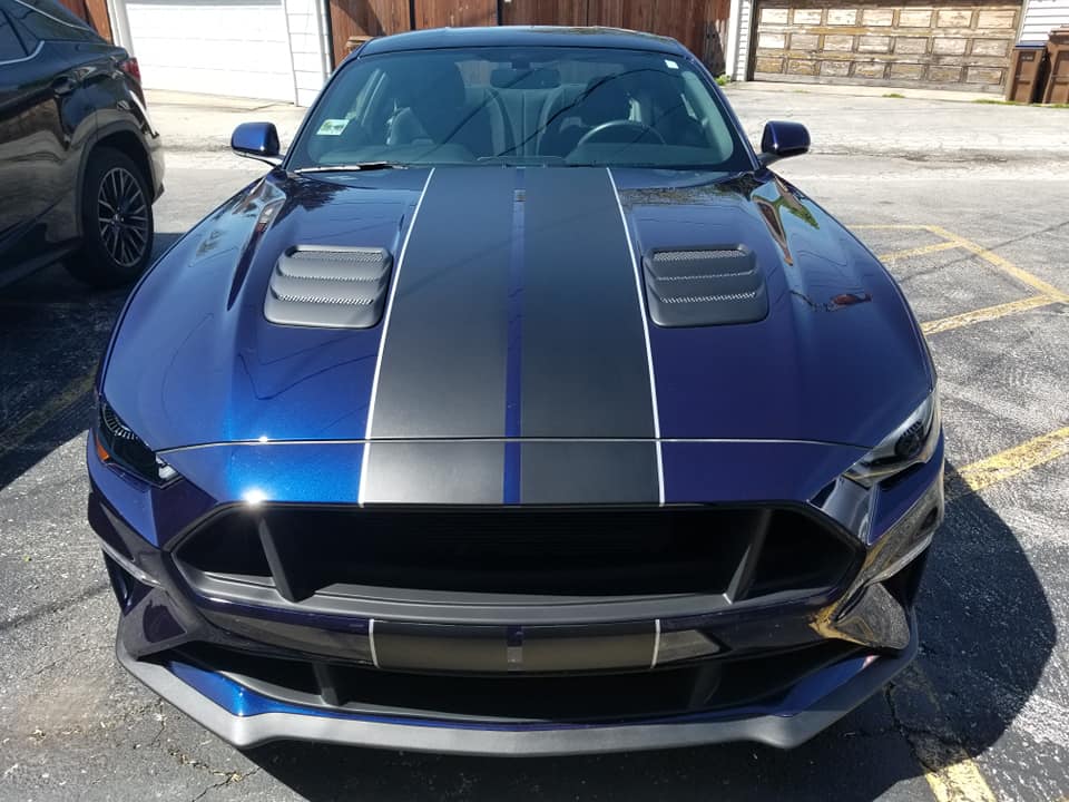

The stripes I had put on are by prodesignseries.com but I don't remember what vendor I used. The installer was happy with quality, I used the 1080 film. It's a dry install that took half the time as wet. I had mine installed at a small town custom sign shop that a local body shop sends all there stripe work to. He charged $150 to install but the education from watching was worth that alone, I wouldn't have tried it myself but now I wouldn't hesitate to do it if needed again. Jim

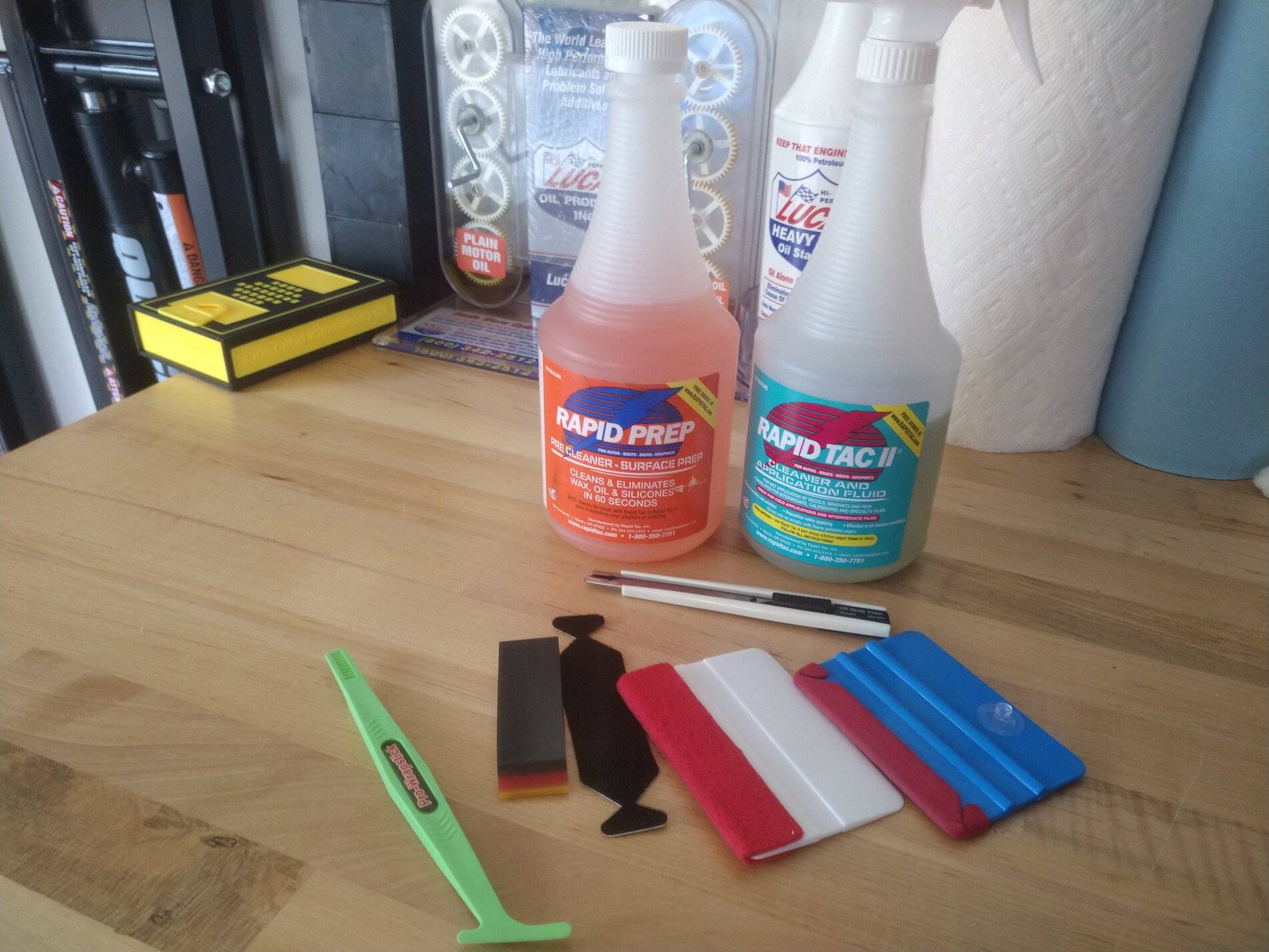

Kit came out great though,saved some cash, and had some fun installing. I got some great pre cleaner, and applicant instead of water that was recommended. Made it so much easier. If interested I'll grab a pic of them when I get home. Also recommend getting a generic vinyl install kit with all the different size squeegees. Super helpful around the vents, ducts whatever.
That’s very helpful. Please share pics of what you used!
This stuff along with a heat gun. Only used the heat gun heavily on severe bends mostly like the wrap around underside of good areas. Roof to windshield gap etc. on low setting. My heat gun only has a high/ low, results will vary depending on brand.
The applicant is great you have plenty of time to adjust but it does take a while to dry. Unless your heavy with the heat. Got it on Amazon, little pricey, but have plenty leftover. Had zero air bubbles, they squeegeed right out no issue. I also did the installation in a cool closed garage.
I let the car sit out in the sun for a full day when finished before driving, as was recommended to me by a friend who does these fairly frequently. Checked on the stripes throughout the day. Touched up where needed on heavy contours. Like gentle push or squeegee to make sure everything was good. Been good ever since. No lifting or any other issues.
Hope that helps. Worked for me anyway.
