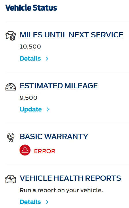

Interesting. The site looks pretty helpful. I'll go verify my Sync version. I might chesk into the below, I was told at dealer I was under warranty till 3/20. Even had some work done.
