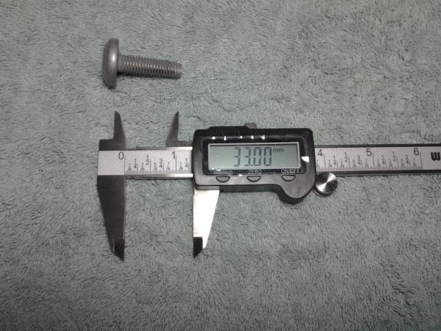

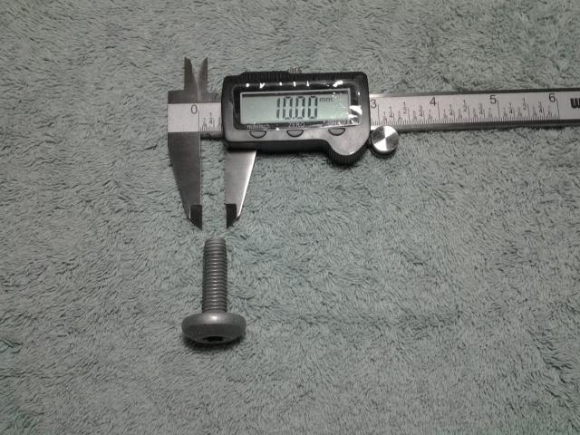

So I went ahead and implemented this yesterday.
I had to buy a large Torx drive bit from Sears. It clips onto a 3/8 ratchet. And yes, I needed that much torque to remove the large seat bolts. I also bought eight 3/8" washers. Four of each makes a 1/2" thick stack.

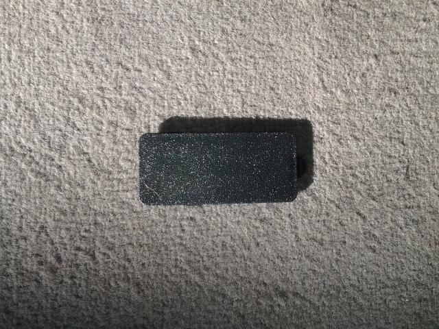

  1. First, I popped out the two front black plastic covers under the driver's seat to expose the bolts.
  2. Then I removed the two front bolts. In my judgment, they are plenty long to accept 1/2" spacers and still retain full thread engagement.
  3. I had to tape the stack of washers together, lest they "spill" apart when trying to push them into position under the seat rail.
  4. I started each bolt by hand, while pushing hard against the top of the seat, so as to lift the front of the rail. (This might have been easier if I first loosened the two rear bolts, but it worked with additional grunting.)
  5. Last, I tightened everything down. Whole deal took just over 1/2 hour (not including two quick trips to nearby hardware stores).
By my calculations, this mod provided less than 2° more tilt to the seat cushion. But I could tell that it gave me more support under my legs, and I didn't have quite so much "frog leg" action.
I may return for a couple more washers (or an actual sleeve/bushing) to gain just a tad more tilt, but I don't want to push the thread engagement past that.
Also, the seat rails actually have nice textured black plastic decorative trim, which lifts off the carpet slightly. The pictured black cap matches the rail trim.
