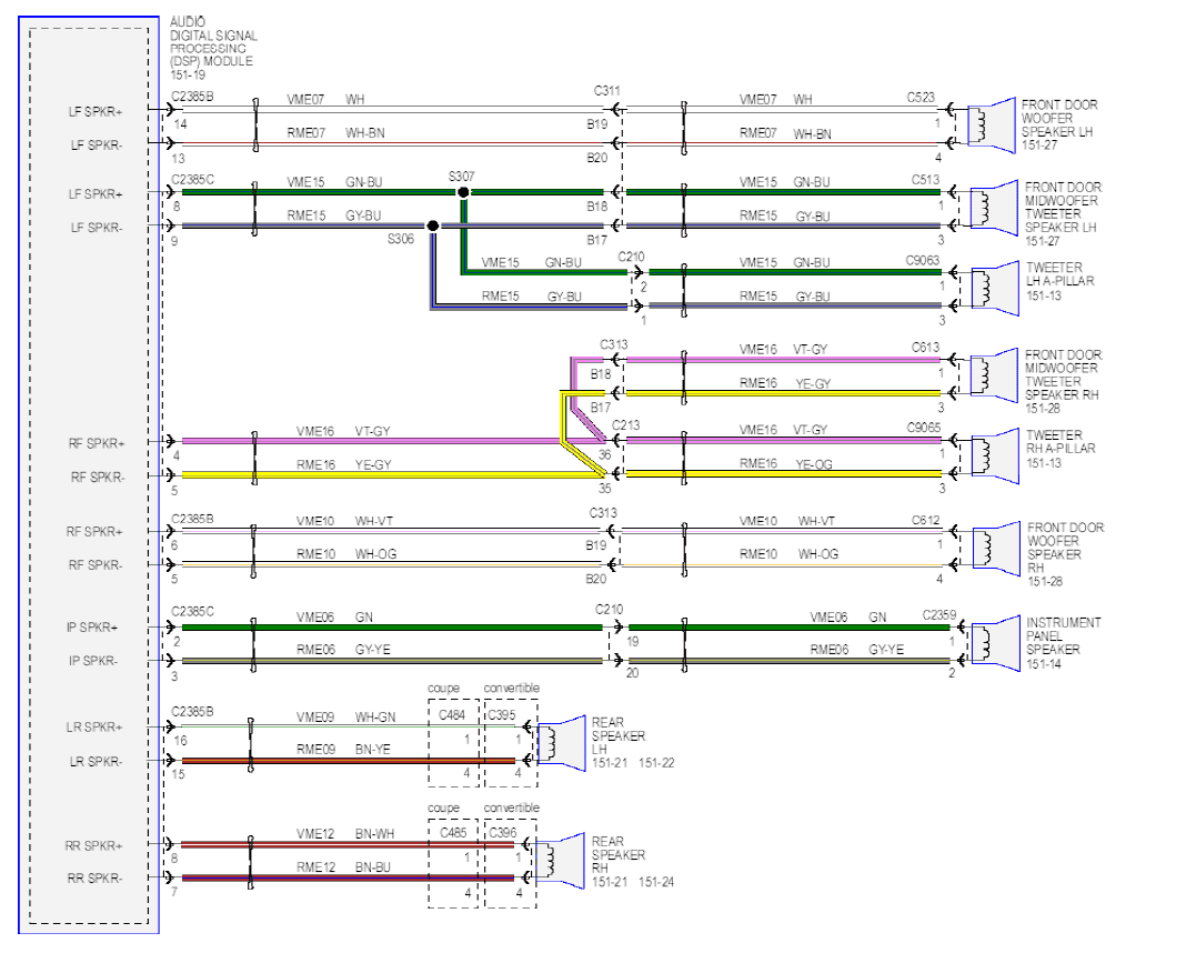

You don't need to pull anything apart, the speakers all have grilles that are visible on the a-pillars and door panels. There's also a center speaker in the dash, that's 7, there are two more in the back. It should say Shaker at the bottom of the center dash. So first, those rear speakers are worse than the old dash speakers they used to put in 1960s pickups, but they should be working. This is the wiring diagram for the setup, looks pretty straightforward

Shaker logo was gone for 2019. But otherwise, the system is the same. There should not be any boxes with wires going to the speakers, unless they are already aftermarket.

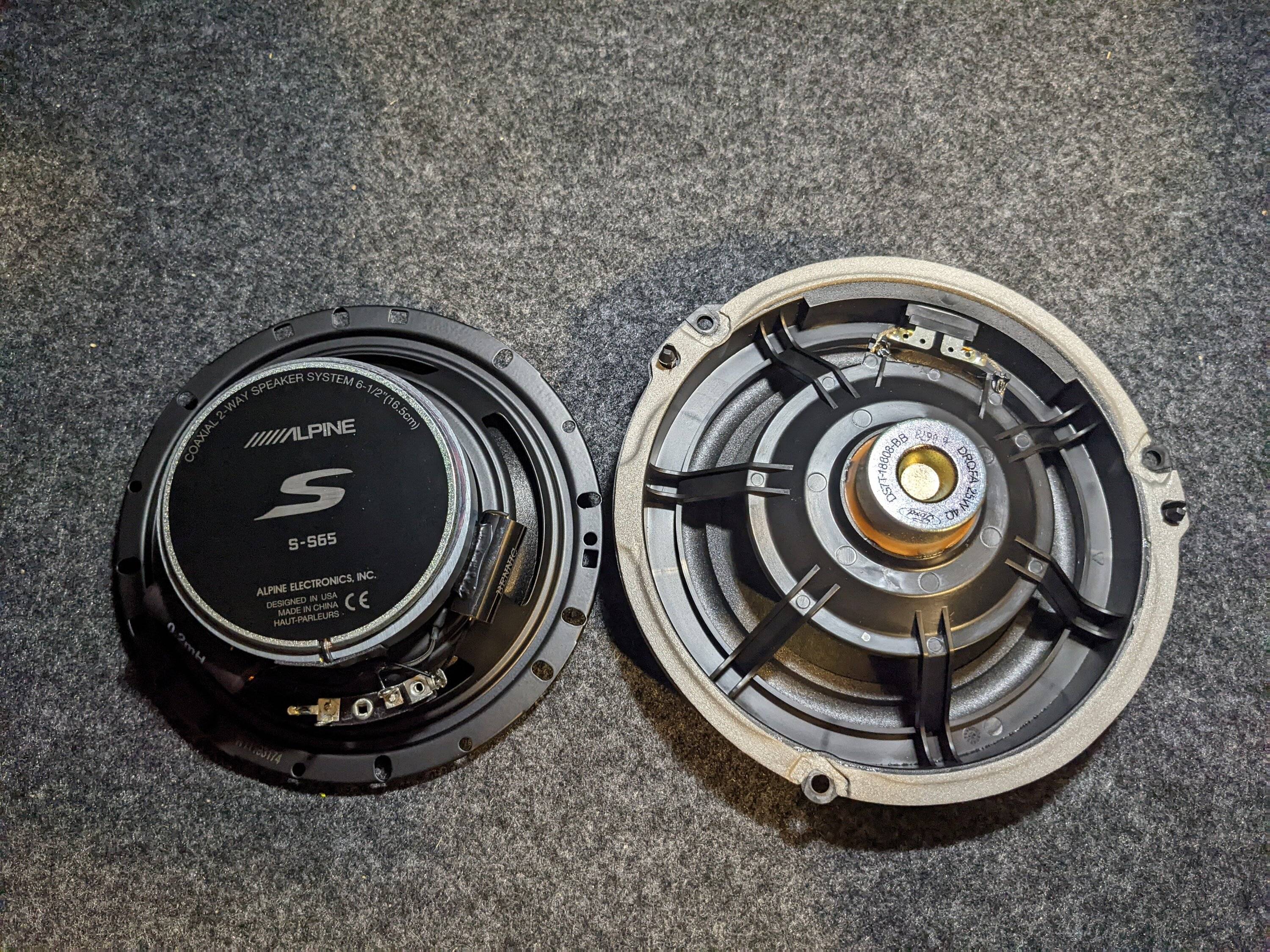

I think the speakers might have had some sort of plastic frame or something where there was a connector to plug the wires into. It may have had a black box shape. Here's a pick of my OEM and upgraded speakers. Can you guess which is which? 🤣
