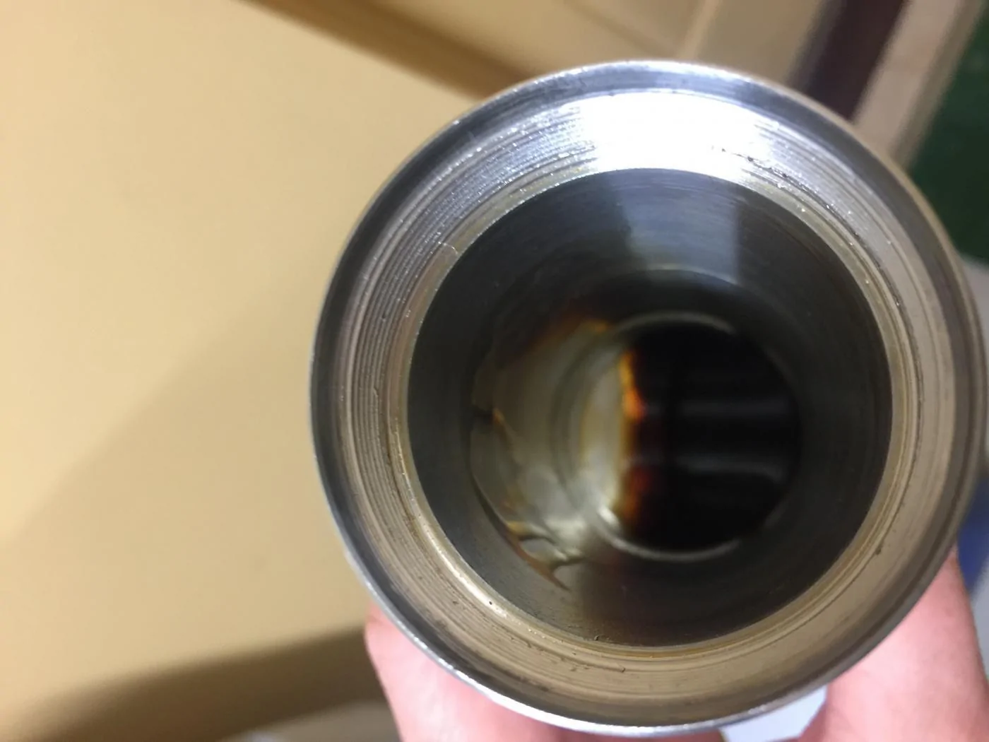

Checked the CAN today, the intake hose has oil in it but the out hose was clean. The Valve is working fine too.
After making sure the CAN and Hose are Ok, I put the Can back in today and no issues. Next thing I did is fill the Tank, this time from Shell. The sound of car changed straight away. It's back to normal.
The previous tank I filled from 7-11.
Not going to 7-11 again, if that's the case. It might be just one time issue, but it got me worried.
Thanks everyone who put some good, suggestions for testing the Can and hose connections.

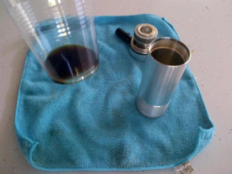

UPR catch can doing its job after only 2 weeks (approx 600kms).

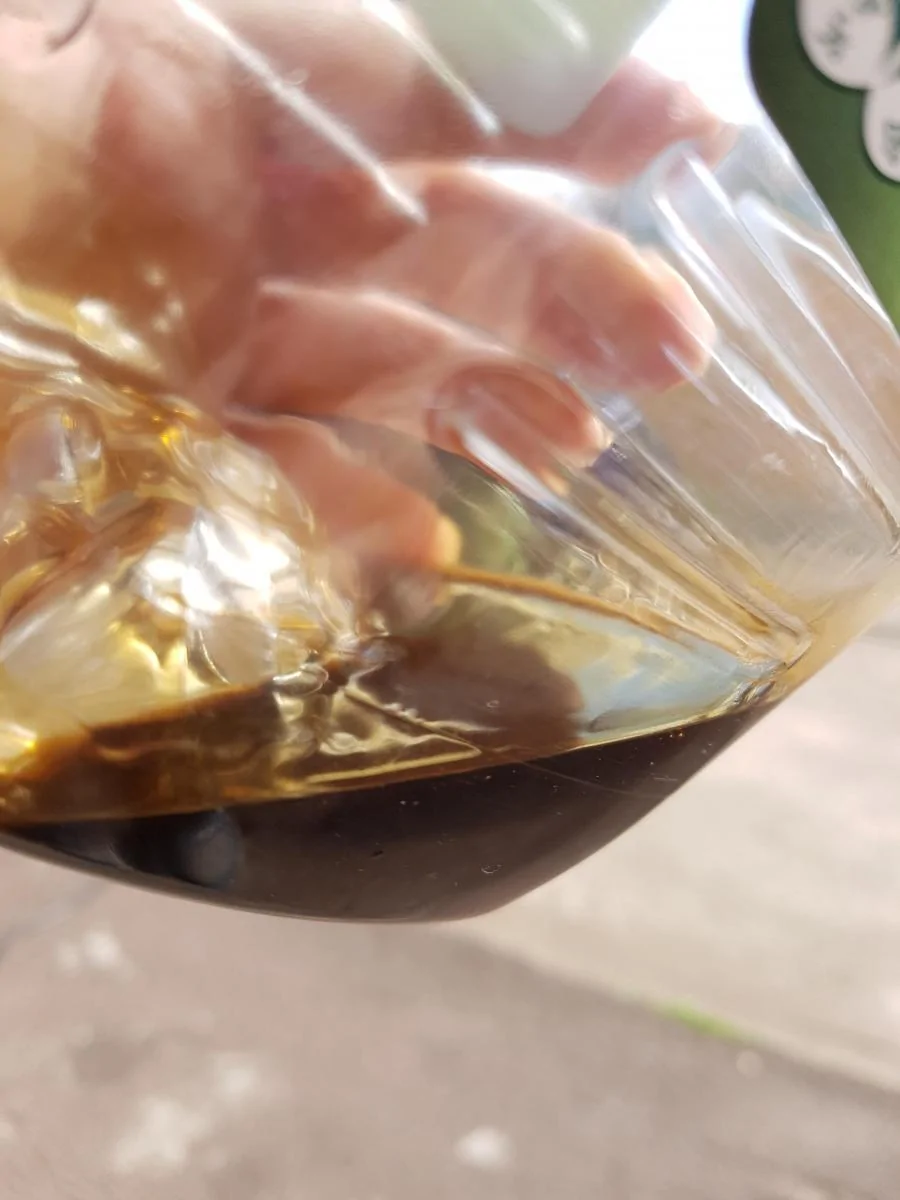

Has anyone emptied and checked theirs after say 5,000km?
I installed mine at 7,500km (I know I procrastinated, it's a bad habit) and haven't had a drop in it since. I've been check and checking thinking I'd installed it incorrectly.
Either that or I've got Super Coyote that doesn't blow back oil.....
