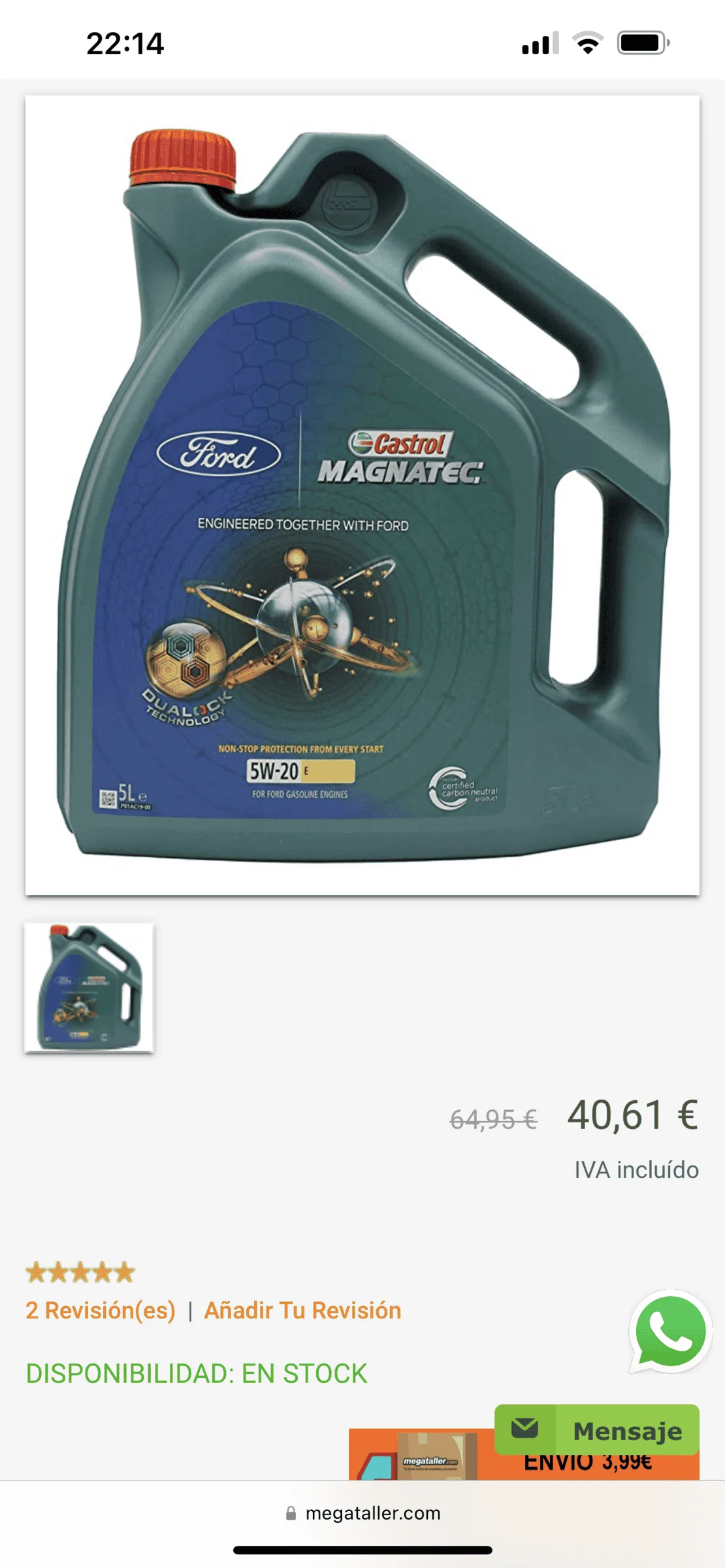

Hello friends, I have a 2.3 auto ecoboost and I would like to know which is the best oil for the engine and gearbox.

Just so you're aware, Ford does not prescribe the use of 5W20 in the Ecoboost engine in the U.S., so I don't know why it would be recommended in any other country. What does your owner's manual say?
yes I already know, that's why I'm looking for that oil if anyone of you knows

Ford Castrol Magnatec 5W-30 really is a good one and is also recommended oil if you look it up in your owners manual. I personally use Amsoil Signature Series 5W-30 as I find it to be the only one that outperforms Castrol Magnatec. Another good one is Penzoil (Ford partnered and uses Penzoil also for race applications). Everything you need to know is, choose motor oil that corresponds with Ford's Specifications and you are good.
