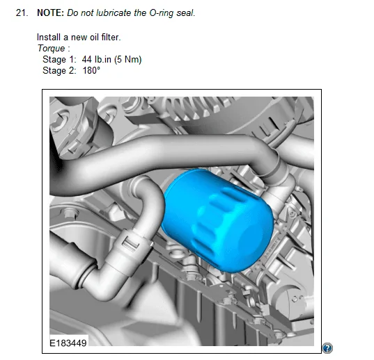

If I follow these instructions, the next time I change my oil, I will not be putting a little fresh oil on the o-ring for the 1st time in my life. I am not sure I am capable of this?
Any ideas why they would recommend not lubricating the o-ring?
That is a mystery. I can't see where there is a negative impact. Maybe FORD uses different elastomer that does not like oil on the face.
The other possibility since Ford may be anal about this is, smearing the gasket with oil changes the relationship between torque and preload.
Looking at a fastener torqued to a specified value will produce a specific preload.
If you take the same fastener, apply a lubricant, and apply the same torque, the preload will be higher. Different lubricants would yield different results.
While the filter gasket is not a fastener, in this application it behalves like one depending how much the filter housing gets preloaded for a specific torque.

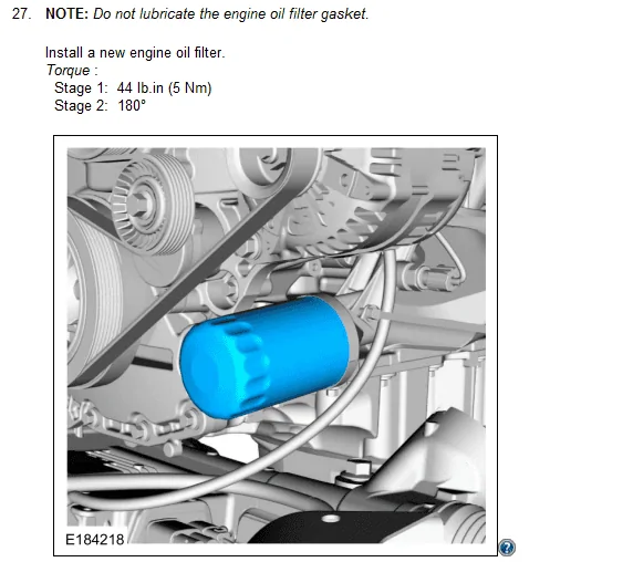

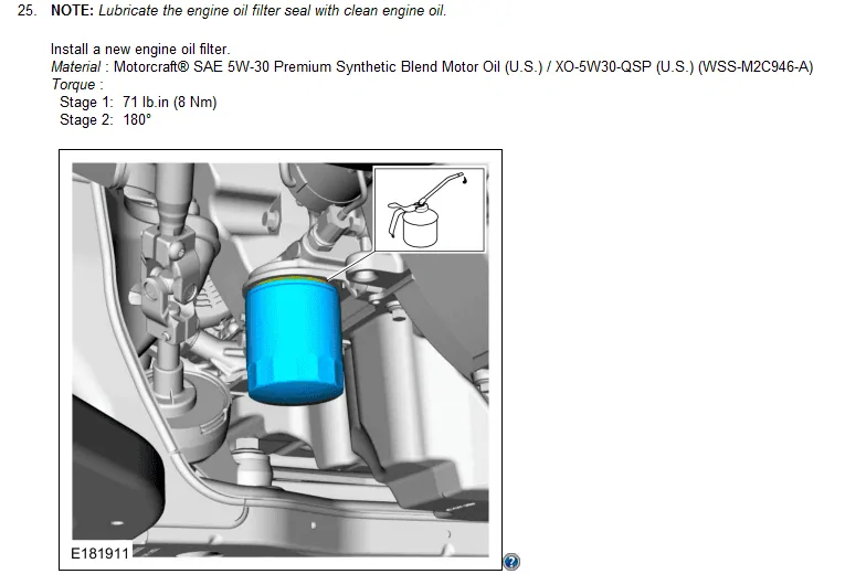

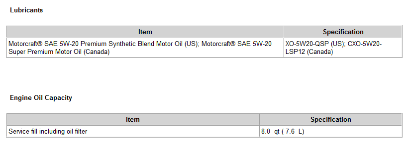

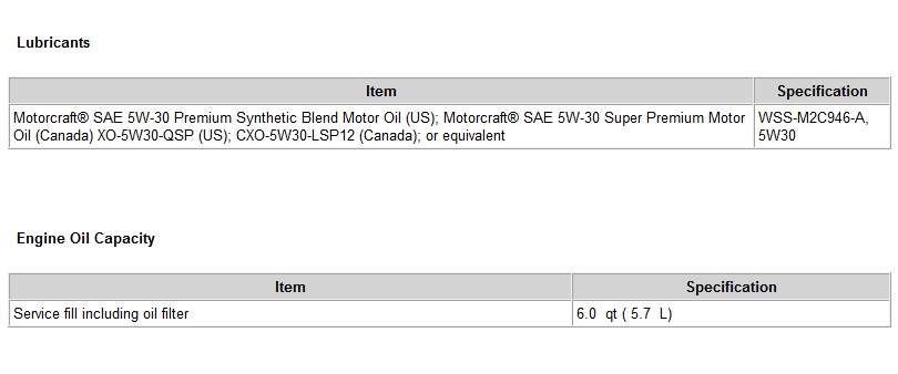

Since they are pictures and could disappear at any time, here is the text version of what's in those pictures now.
V8, or V6 oil filter: Do NOT lubricate the o-ring or gasket. 44 lb-in, followed by another 180 degrees.
I4 oil filter: Lubricate the gasket with clean oil. 71 lb-in, followed by another 180 degrees.

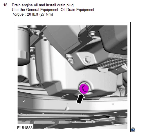

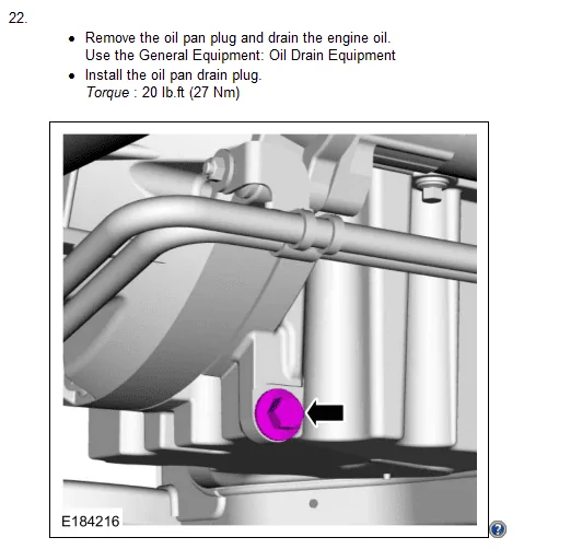

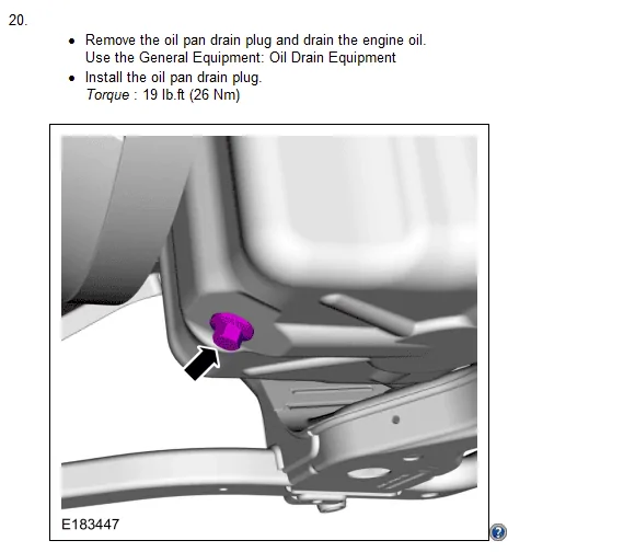

V8 drain plug: 19 lb-ft
V6 or I4 drain plug: 20 lb-ft
Note for owners replacing their drain plug with a drain valve: use the lessor of the torque specified for the valve and the torque for the drain plug it replaces. Valves usually have lower torque specs than the plugs.
Update: since several members have been asking in different threads about drain plug threads of the Ecoboost and V6, all 3 engines have M12x1.75 drain plugs. Part number: 9L8Z6730A.[FONT=&quot][/FONT]

19 ft-lbs on the drain plug. I don't torque the filter with a torque wrench, but turn it 3/4 turn after the gasket first hits the mount seat.
