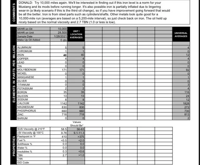

Oils are fine for 10-25k intervals. These aren’t old technology oils. Some serious properties to them.
I’m running next 15k interval and re testing will post back in a year
amsoil isn’t badly priced. 10 a quart. 15 filter

Ive been running 10k on crap 25 dollar dealership syn blend for 100k and went to 15k after that w full amsoil synthetic. That car has 175k and drives better than it does day one.
Amsoil sig is rated 25k miles, but amsoil ea filters only rated 15k
only reason I posted this was because says higher iron. But the company sent me an email saying it’s fine it’s most likely from previous oil and break in. Since this is my 3rd change
8k and 18k now 28k
my car is full bolt on, minus I just put stock downpipe back on. But this oil was with it

Can't argue with the numbers, just find it amazing you've only changed the oil three times on a 28k mile car. I might do this test next time around on my Mustang interested to see the condition of the motor.

I was at the dealership at 8k to get a new battery, mine was a 2 year leftover and it was kaput. they offered me a full synthetic oil change for like 70 bucks at the time, removing the synthetic blend. I said sure, why not. it was 30 bucks off I recall for the oil change.
then 10k interval, fords recommendation. I changed to 18k amsoil signature. I did a test at 10k to see how its wearing on my mustang, and other than iron, which is most likely from their notes, im going to rock 15k next interval and will post results. !
ford performance tune, all other small add ons, not a major tune like the other EcoBoost guys pumping like 28psi lol. I don't know if it matters, but I do have a catch can as well. it may help catch some stuff, but in 10k miles I had like, maybe 3 tea spoons worth of oil.

I guess the smart guys at Porsche got their newest $200,000.00 911 Turbo 20,000 mile OCI all wrong.
OP, you got it right. Your confidence in modern oils and the OCI is on point.
I received the same high Fe readings a few years ago on a low mileage Land Rover 5.0 SC. That’s when my radar went up and dug deep into oil tribology and the effects of iron on sample readings.

I agree with this, during the break-in period I would not change the factory oil for a bit. There's additives to aid the break in process.
