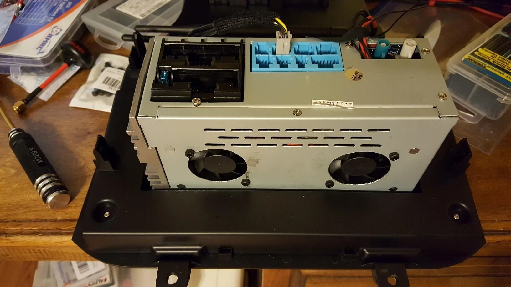

When my screen went out, I still had the backlight. Turned out to be a failed main core motherboard. One step was to see if you could see the red LED blinking inside the host on the red core board.
Marvinmadman
Dec 9, 2016
841
166
Louisiana
16 EBM

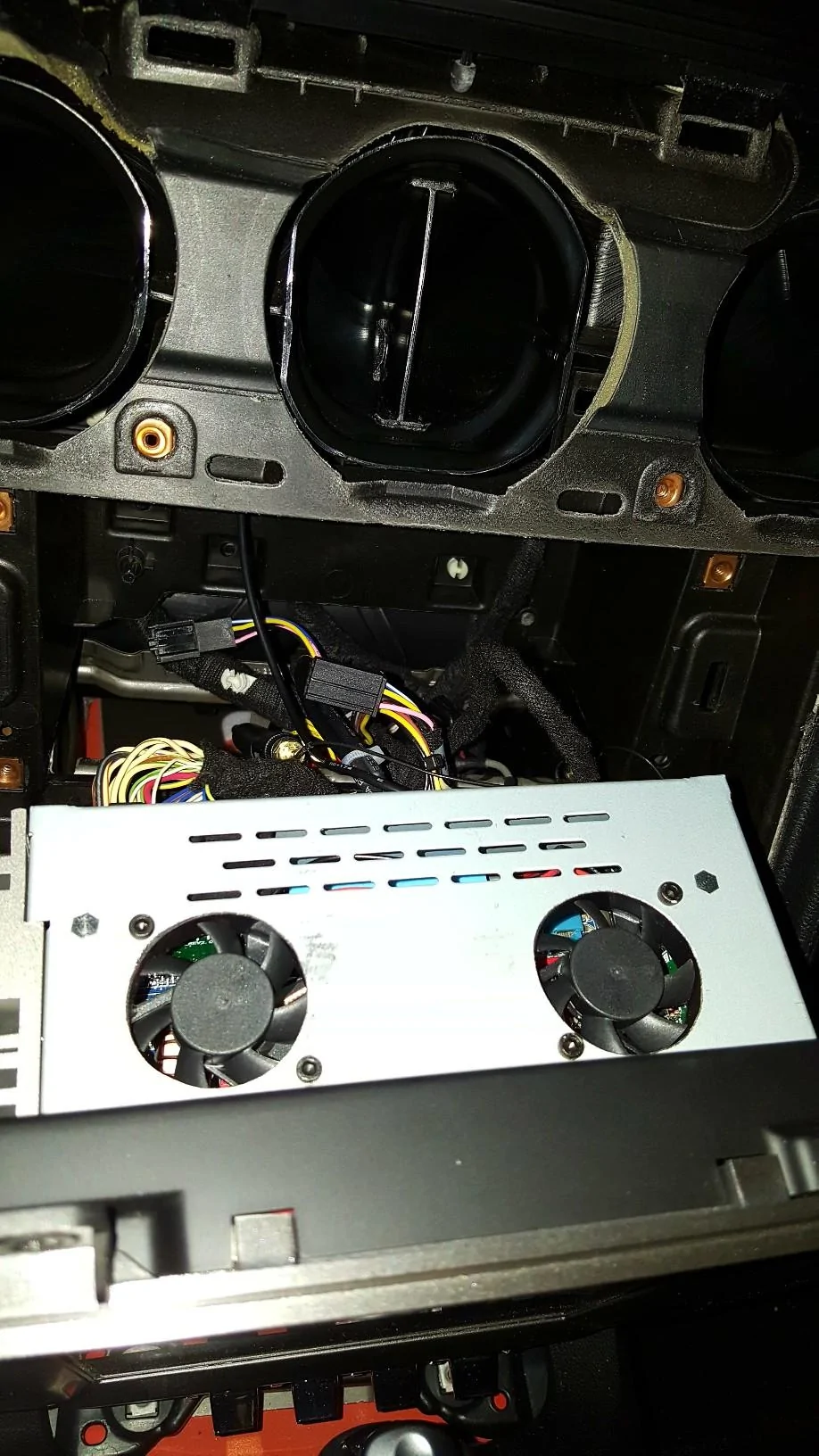

I think my unit failed because it overheated. I was inside the car with unit on and playing the music kinda loud. Hot day with the car not running. The host gets extremely hot. That's why I added 2 fans to the host to keep it from overheating again.

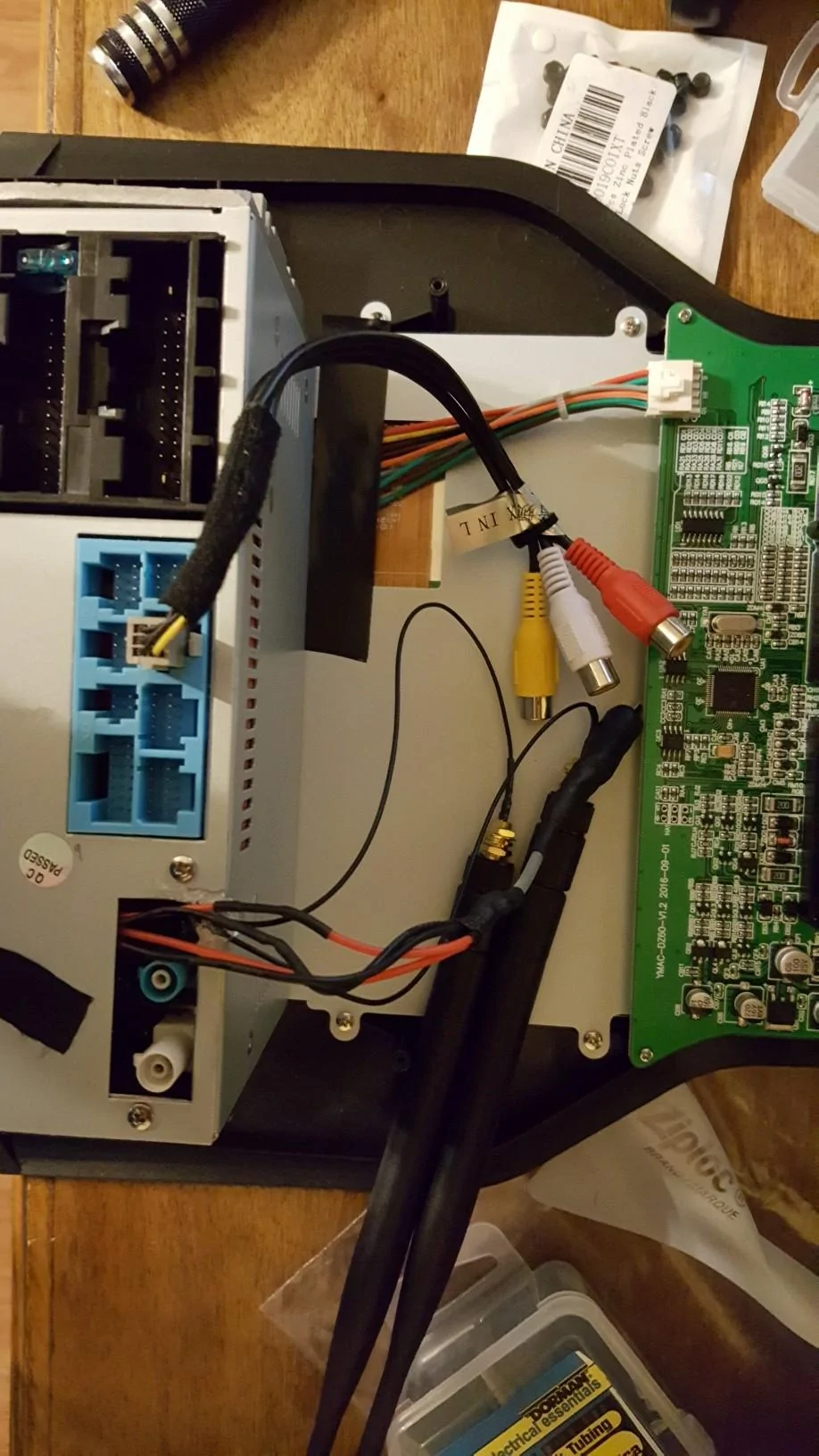

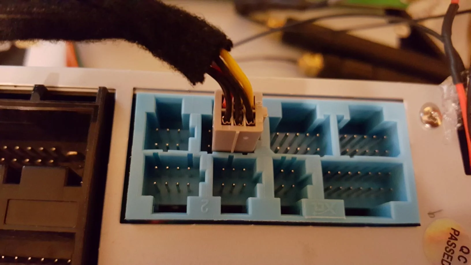

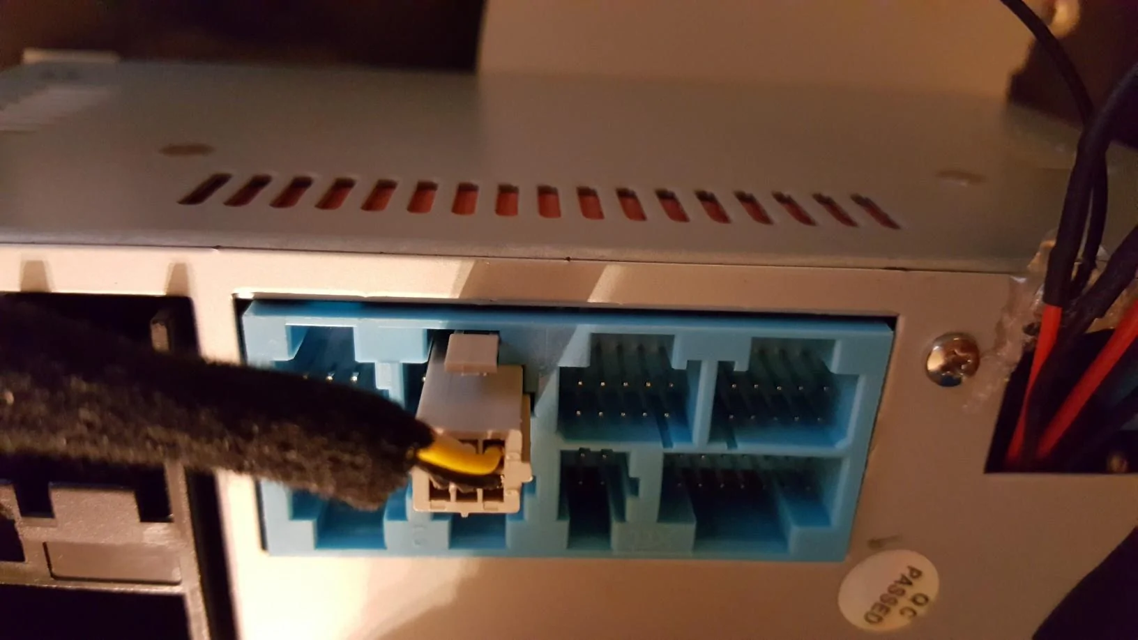

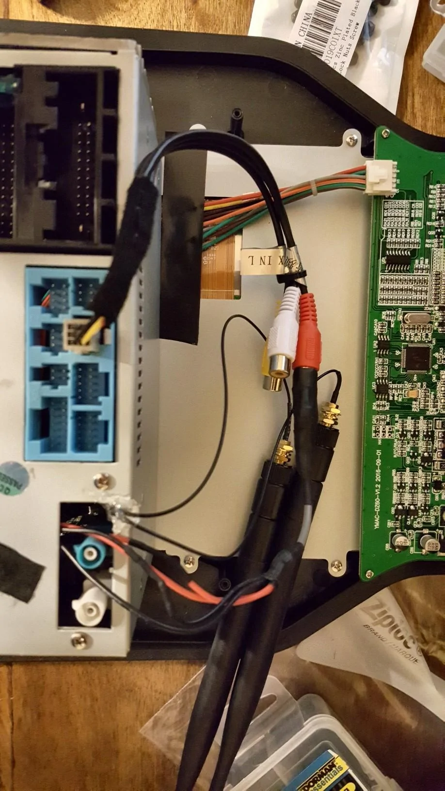

Figured I would post here to help some people out.
I recently installed a unit in my personal car (GT Premium Track Pack)
Had the issue with no audio, spent about two full days tracing wiring to and from the amp to the head unit.
Ultimately what fixed it for me was two factors.
1. Hopping in the advanced settings and setting the car to mustang hi
2. the amp trigger wire had 3.6v going to it. factory is 6v. on my unit they had ran an inline resistor setup with two resistor set together and a ground lead to one pole. I left the resistors in and snipped the ground lead and it bumped the voltage to 5v and fired the amp accordingly.
3. unable to fix, the usb adapters do not work for my premium model. I can plug right into the usb they provide with no issues. running it though the car is an issue.
workaround is to just drop a usb down the console in case i need it.
I did also wire in a fan to my unit as just screwing around with it in the car loose it became extremely hot to the touch.
so if you have a premium its not out of the realm of possibility to get this working, mine does.

How many of you had a problem with overheating? Also for those that installed fans, how did you wire them?
