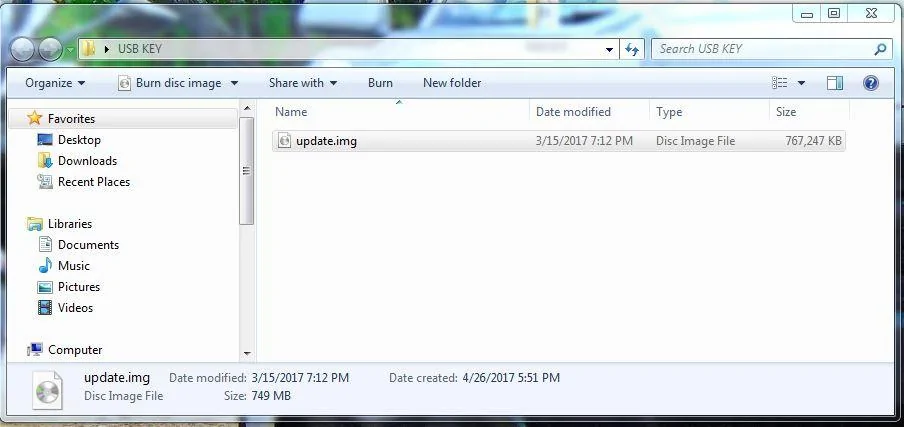

did that, HU doesn't do anything when I insert thumbdrive.
"update.img"is not the file that shows up after I extract the file, its "Custom_ROM_March..."
go in that folder, you will see the "update.img" file. Cut it and paste it at the root of your thumb drive and delete that folder. If you don't know what I mean look up the website. I posted a complete tutorial on how to do it with pictures...:thumbsup:
Yes, you have to go into that folder and copy the file named update. Paste it onto your thumb drive, and be sure you have it formatted and free of anything else. Also, start the car and wait until you get past the boot screen to insert the drive. It takes about ten seconds to recognize the update. How big is your thumb drive? Mine is 8 gb's and works fine, but I remember people having problems on the first gen with a large thumb drive.

Are you sure your USB key is formatted in FAT32? I just sent the update to another member and he did it perfectly... I wonder what's going on right now :confused:

Your thumb drive should look like that...
