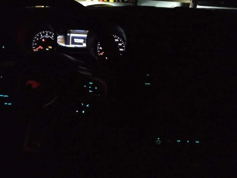

Aside from my mission to fix the WiFi, I bought some conductive electric paint and fixed the LEDS on my AC / On-Off board. I also swapped out the Cyan color filter for (ironically enough) the green filter that came with my kit. This green filter looks very close to stock. :headbang:
