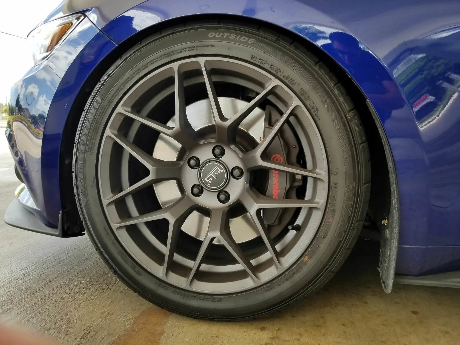

You guys that are running 19" staggered having plenty of clearance running 305/30 in the back without having to have extreme camber or anything out of the ordinary? I want to run the Continental ECS without jumping through too many hoops.

I run the 19" staggered with 305/35/19 MPSS in the rear. I run just passed -1 degree of camber in rear. Lowered on BMR performance spirngs (1/2" drop in rear). No rubbing.

Thanks! That is the setup I just ordered!

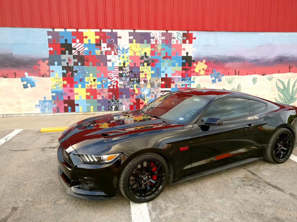

Conti ECS in 275/35 front and 305/30 rear. These wheels look so much better in person! I did have to use a 7mm spacer up front because they rubbed my Steeds struts. I don't know why they didn't use a better backspace. They now sit flush with the spacer on. I'm on BMR handling springs.

what i don't understand is why u need a spacer...Do you have the performance pack brakes?...are u on 20's?

It is a PP but it cleared the brakes easily. It was rubbing the strut. Took off all the blue paint from the Steeda strut where it contacted.

This is the best side shot I have for now. Straight from the tire shop, still has the white goo on the tires.

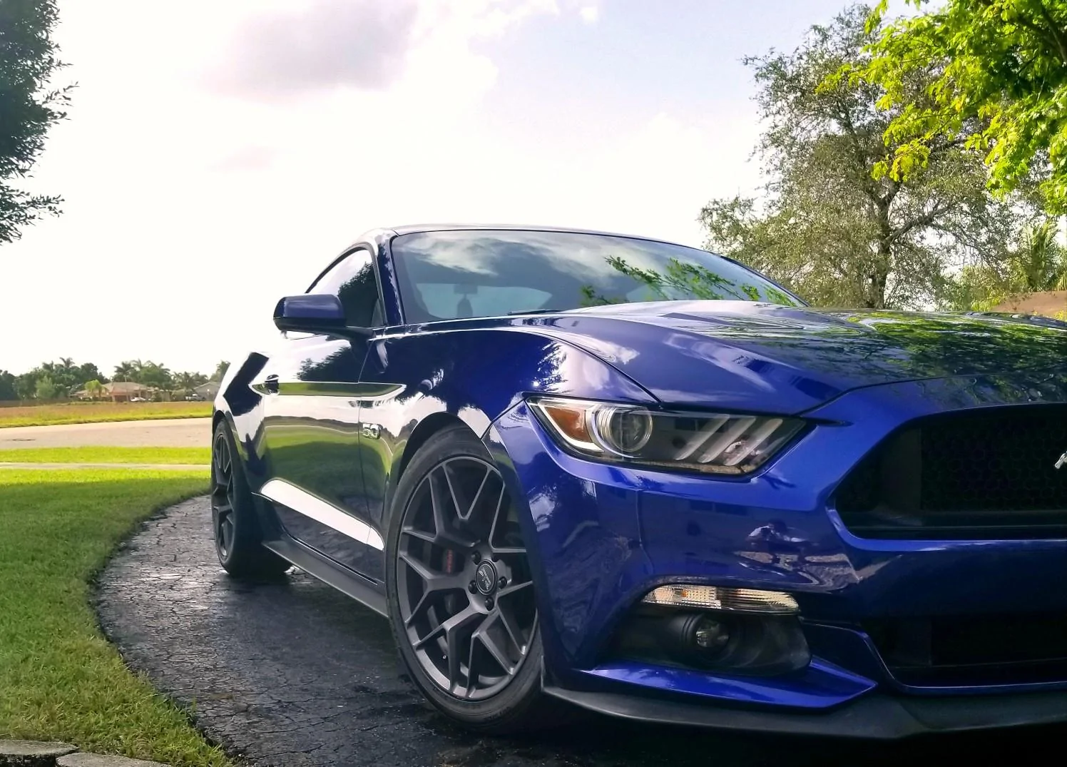

Just got some RTR's from another member on here and I love them. They are the 19x19.5 squared in the charcoal color
