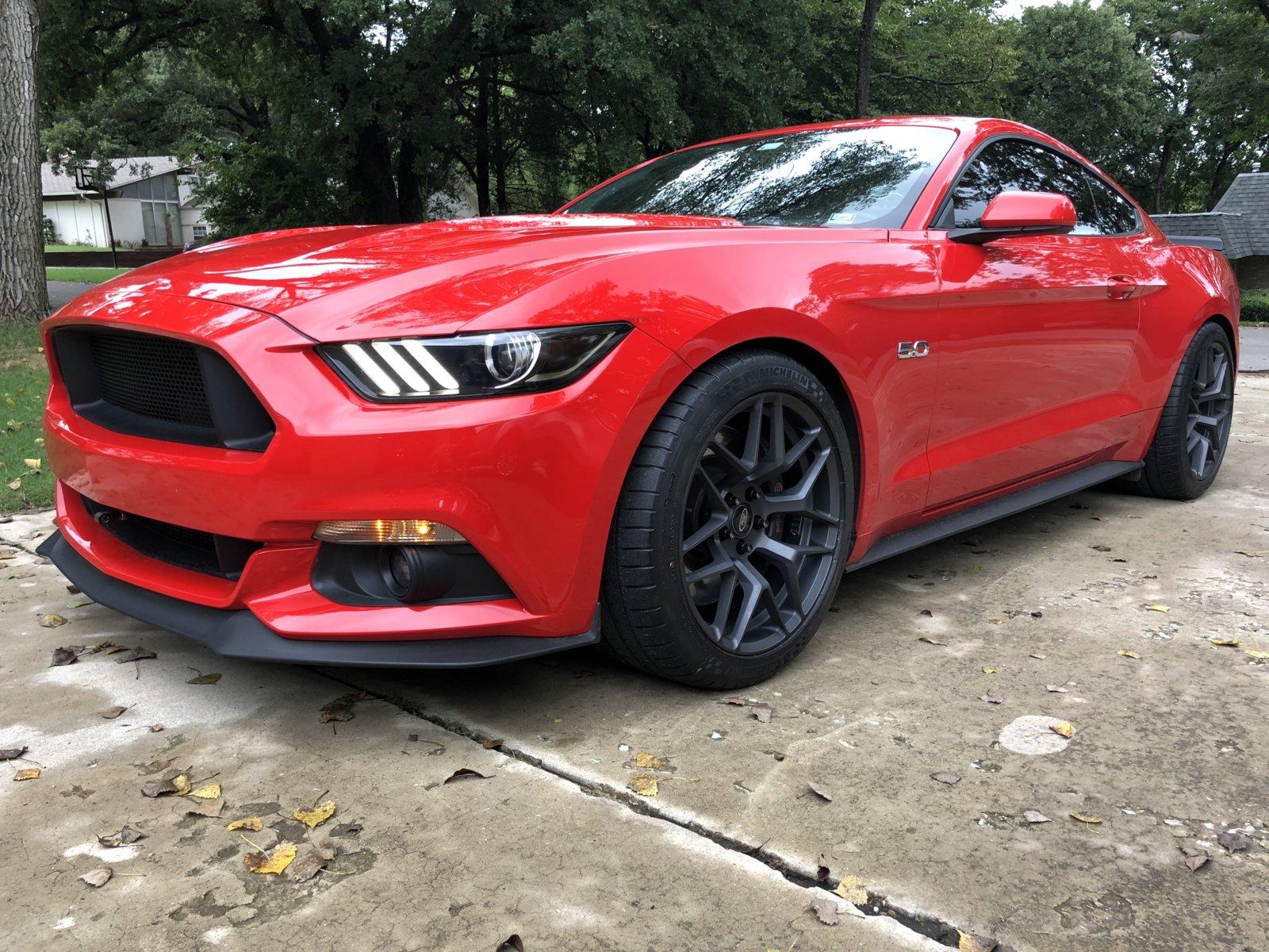

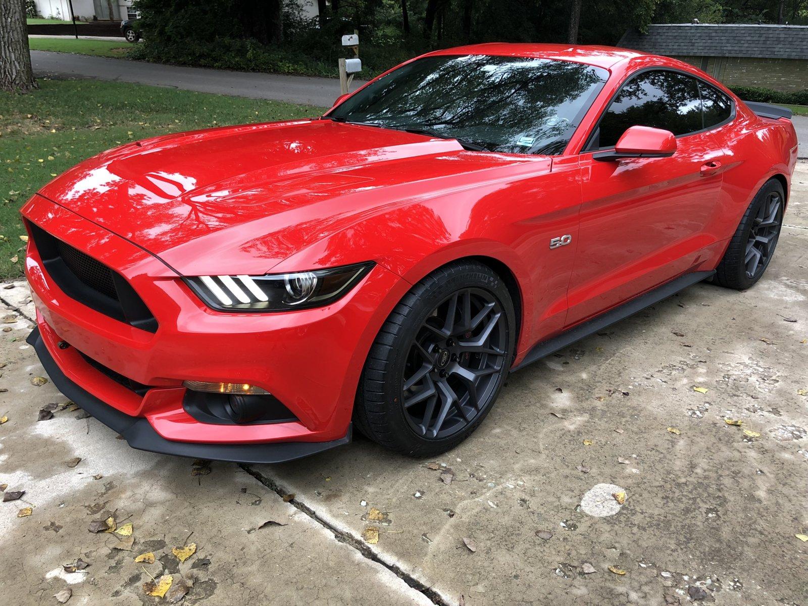

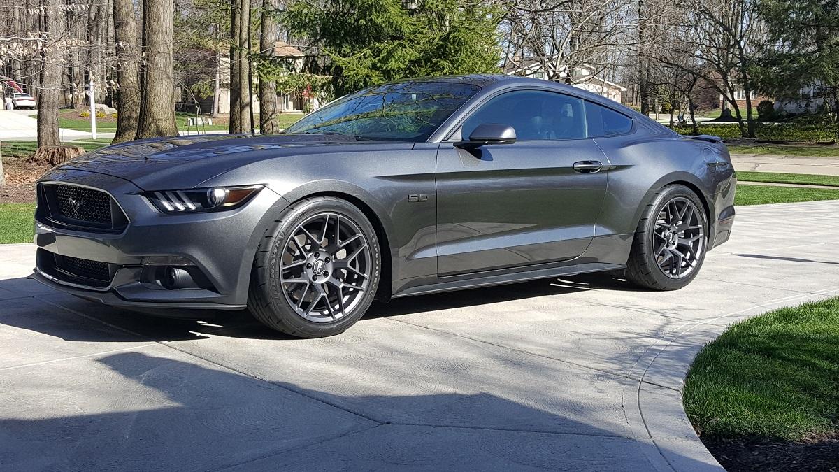

19"x9.5" squared on 275/40 Firestone Firehawk Indy 500's. BMR springs.
Looks really good:headbang:. I'm still trying to decide if I want to got 275/40 or 285/35, yours looks really nice with the 275/40's. I'm not planning on lowering mine.
Nicely done sir!

Thanks!
It was a tough decision between those two tire sizes. I got a great deal on the 275/40 tires and had more brand choices in that size.
However; I would have been fine if I found some 285/35 at a better price . I'm sure they would have fit fine and given me a bit more contact patch and rim protection.

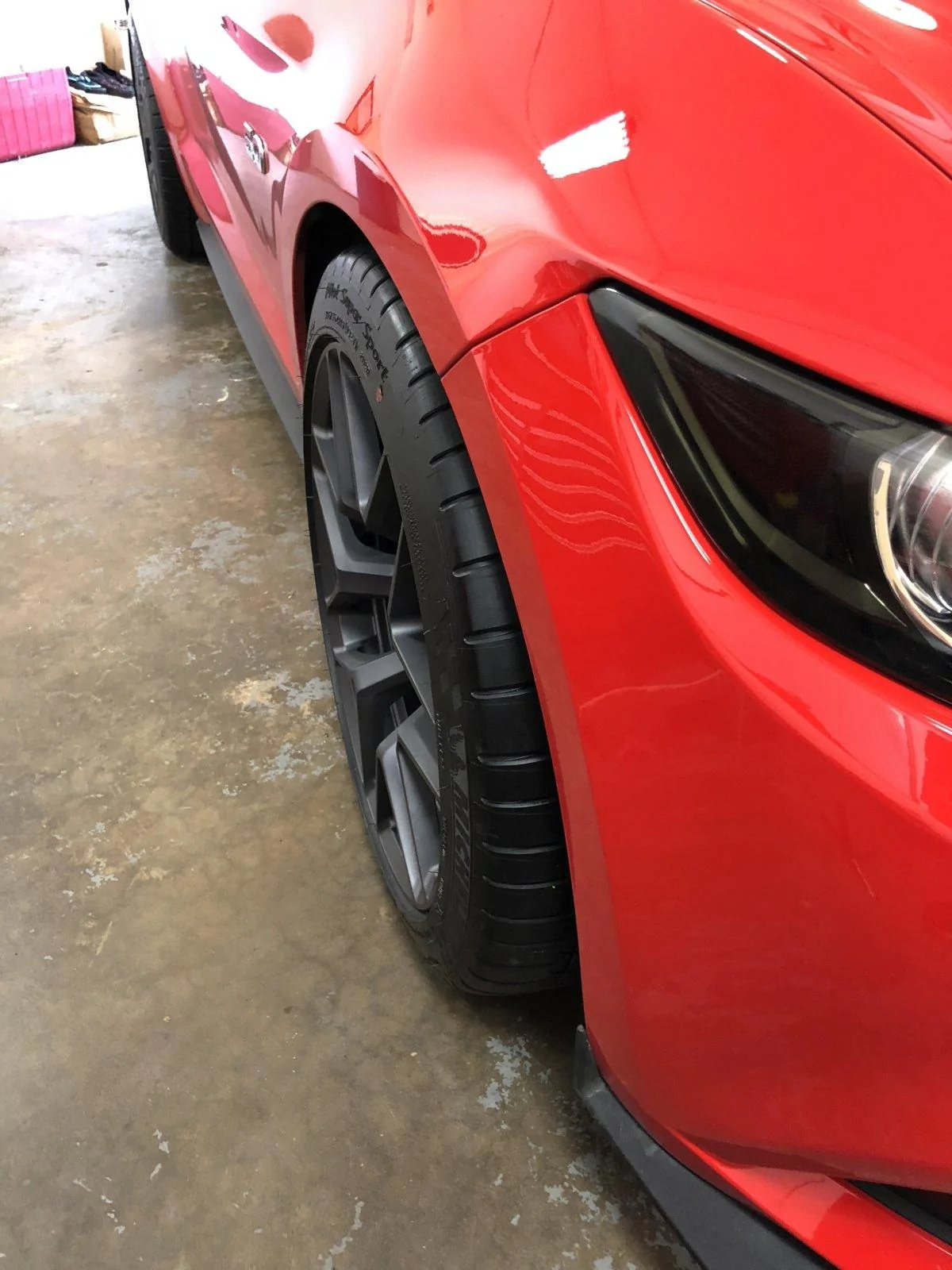

Think I have a 10.5 square fitment figured out for the RTR Tech 7 19". Requires extended studs and 13mm spacer up front. Will post more once spacers are received. I used a stack up of 5mm and 3 mm spacers to confirm clearance with everything.

19x10.5 squared.
MPSS 305/35/19
ARP Extended studs in front with H&R 13mm spacer.
