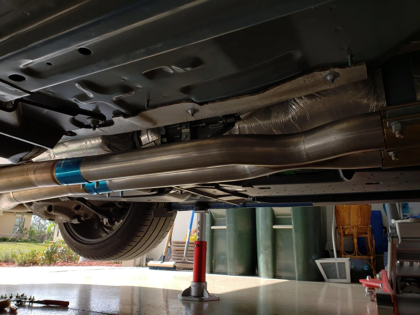

Did it with the shiftek kit. The fitment is eh, and directions weren't extremely clear but I was able to get it installed. I don't like the area with the clamps as there's a large difference in the OD of the pipes, but the clamps seem to seal well. I'd almost want an exhaust shop to weld it up with some intermediate pipe but as long as it stays secure I'll be happy.

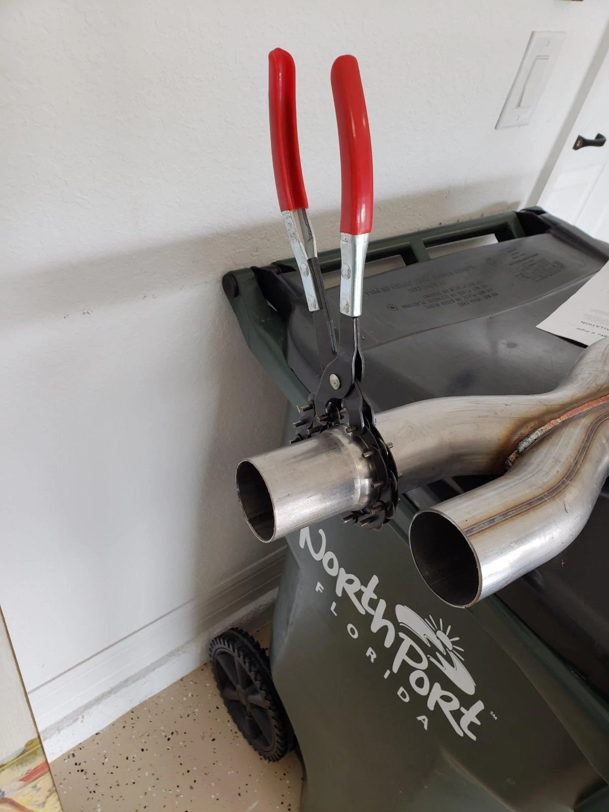

Shifteck installed, wow what a difference. Car is flat out nasty now. I pulled past a couple in a minivan from a stop light and heard a "Jesus Christ!".
PS only issue was I bought this pos, should've just got another sawzall for FL

Not sure about 20% but having installed one on mine, the the sound is now just awesome. Absolutely could not go back to stock. In my mind I think this simple mod really opens up these motors and if Shiftek says 20%, Im apt to take their word for it. Highly recommended.

I see most cut off the down piping. Can I ask way and doesn't that make it harder to clamp up? I thought the purpose was so you can slip it in and clamp , wouldn't that make it so you have to weld now once you cut that off ?

I have an appointment scheduled tomorrow to get the resonators cut out and replaced by 3" stainless. They are slip fitting then welding. Does this have any down sides compared to butt welding 2.75"?
Quality of mine was fine. Much louder and pops and backfires even more. I cut off the down pipe - no problem because the factory clamps on that side allow the wider section to butt right in.

According to their data on the installation sheet:
Stock - 729 cfm
Shifteck with neckdown - 747 cfm
Shifteck w/o neckdown - 882 cfm
