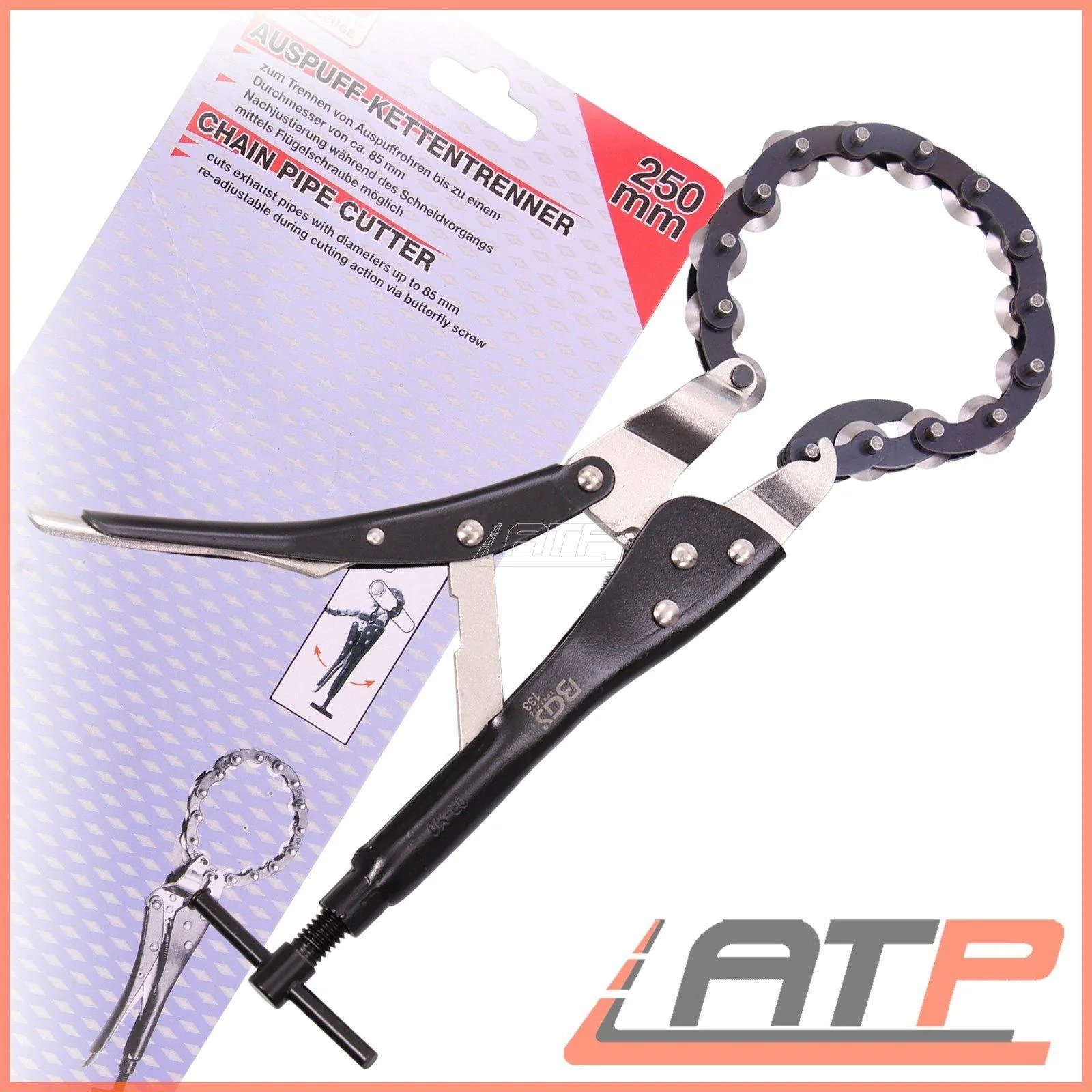

Hey guys,
I ordered the Shifteck XPipe.
Which tool is the best for cutting out the resos? (Need to buy or rent).
1.
2.
