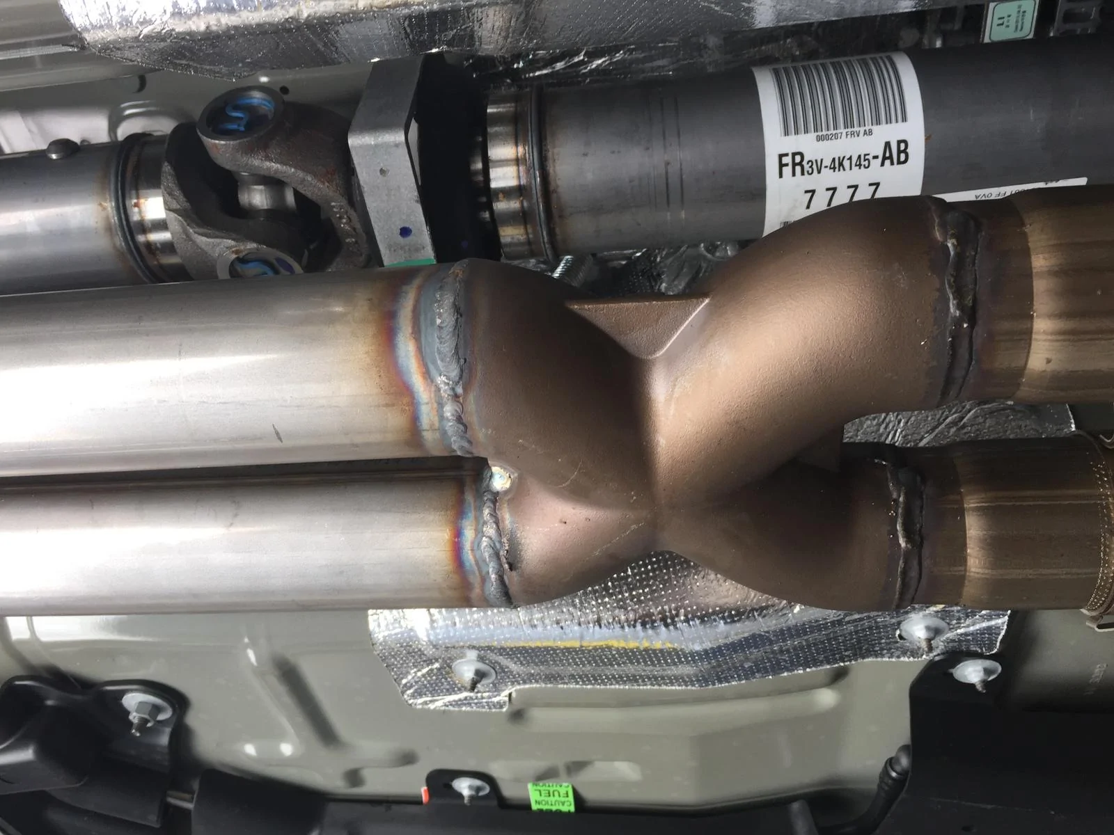

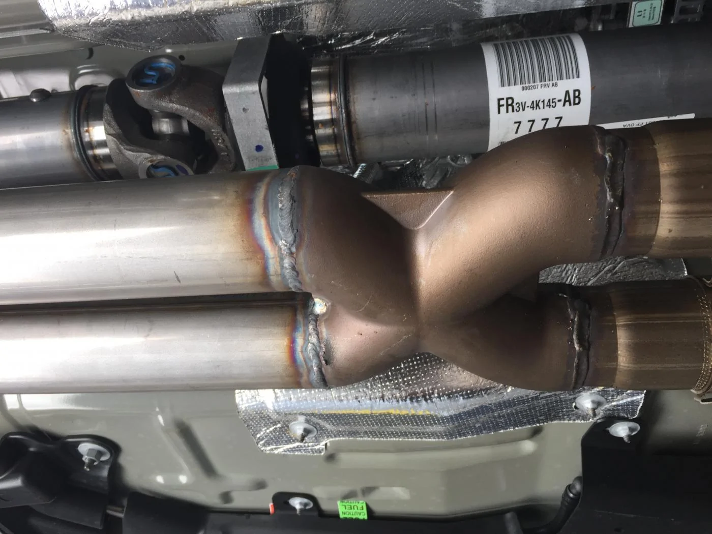

I cut up to the leading edge of the x pipe to make it a smooth transition and not have it hit a reduction in diameter. I also tig welded mine for a cleaner weld.
So if I have them cut up to the leading edge of the x-pipe, then the pipe can be 2.75" all the way through?
Also, I'm a welding noob so what is the difference in TIG weld & MIG weld? I would want whichever would match the current welds on the OEM exhaust.

I used a chop saw and cut the x pipe to the collector area. You can see before/aft of the collector where the unedited portion of the x pipe has an area of pipe that snakes down just a bit. That's what both sides look like. I used 2.5" pipe. I had 2.75" pipe, but I would have had to crimp it down slightly to get a snug fit and instead chose to weld in the 2.5" pipe and have it slip fit on the exhaust pipe to the rear. I left about 1.5" excess to slip fit and then welded the rear.

Pic didn't show but thanks for the explanation. So 2.5" is recommended over the 2.75"? I'm trying to replicate how it is on the R, I assumed it was 2.75".
