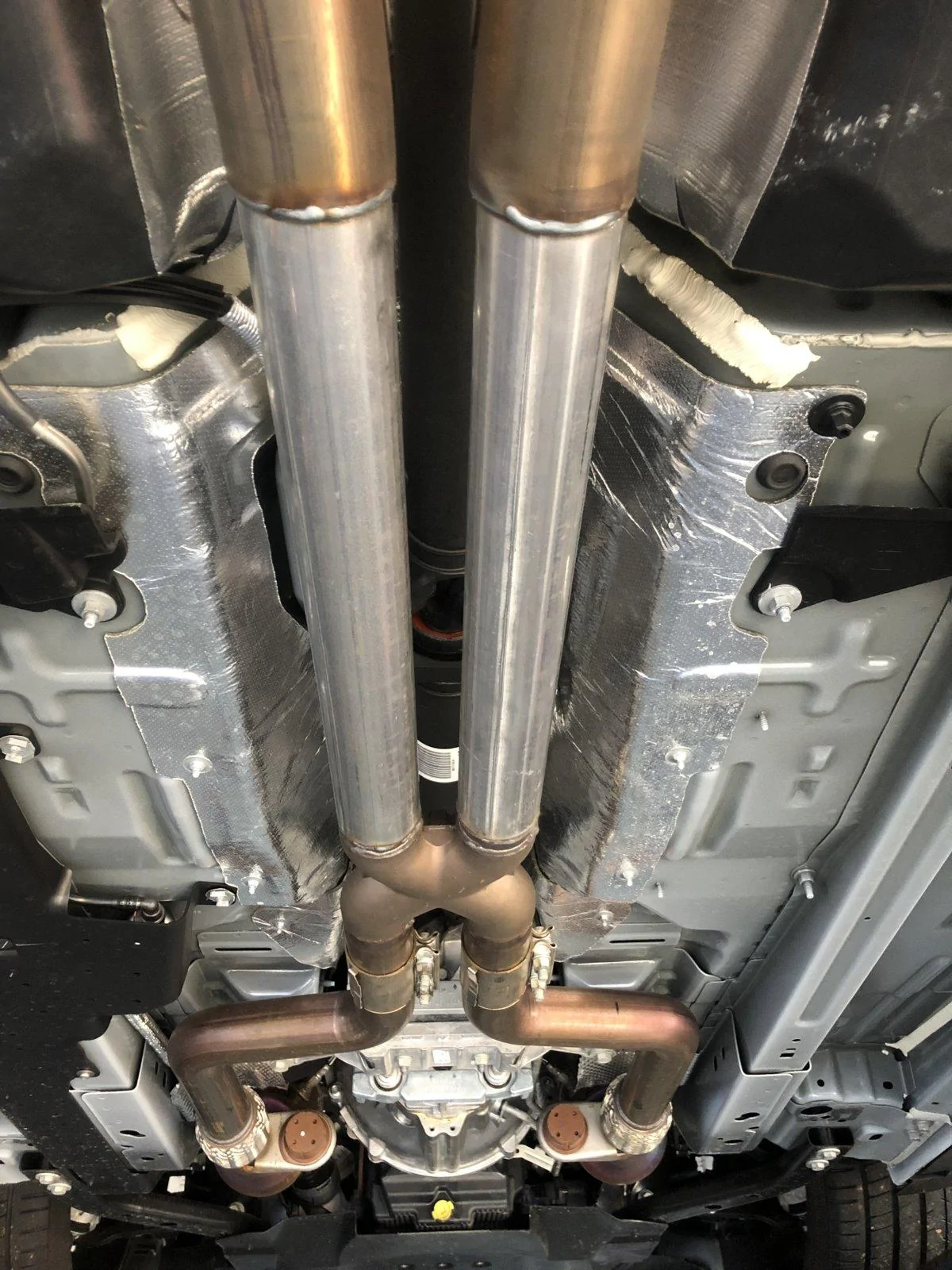

I did my own lol, good client of mine actually gifted me the piping.

Any sound clips? I am guessing you created two straight pipes? Seen many cars here that have a muffler shop replace the resonators with strait pipes. Curious is there is much sound difference in that vs an x pipe?

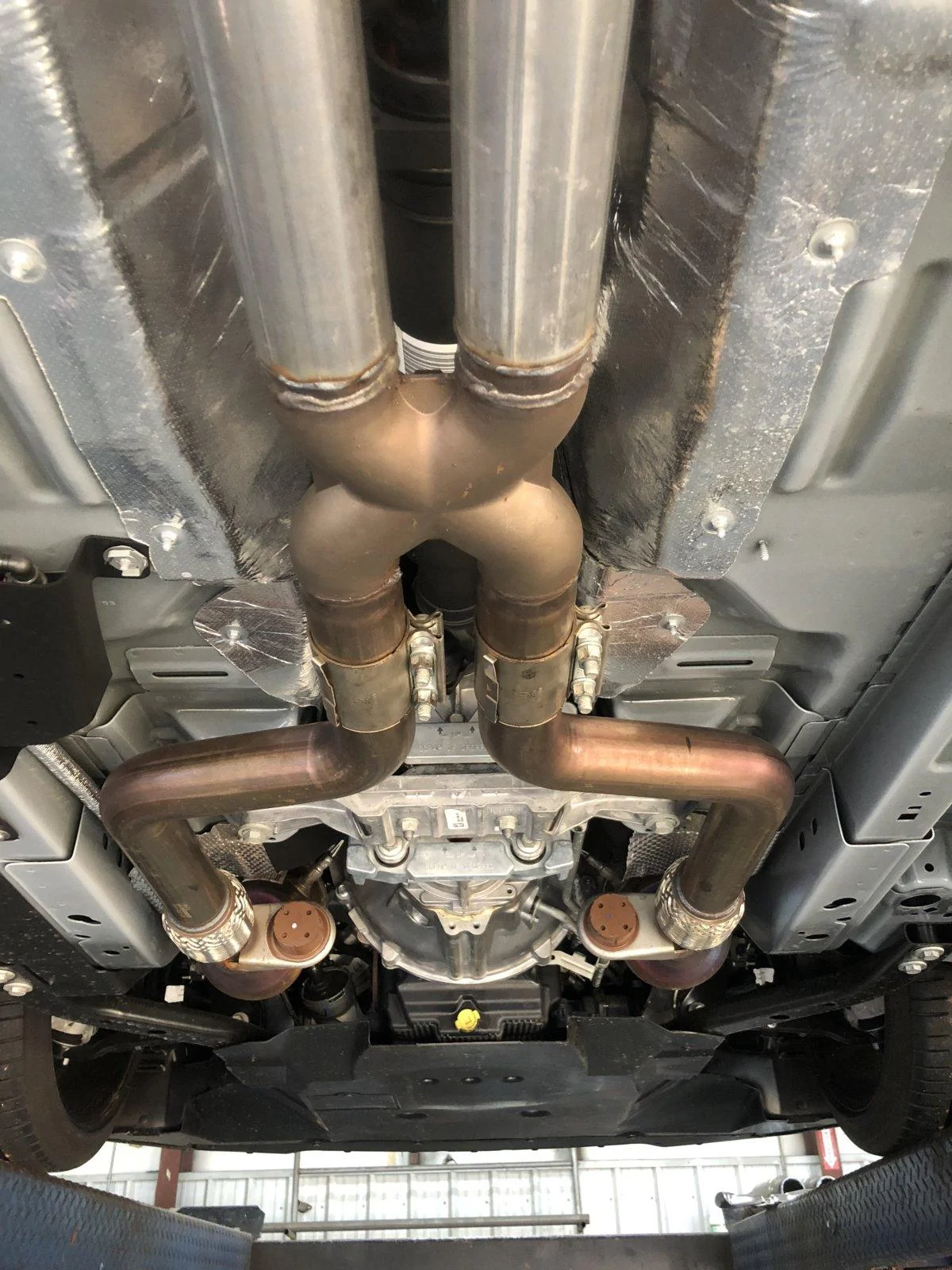

Had the resonator delete done.. bought an aftermarket xpipe.. this aftermarket piece would replace the factory xpipe and the resonators..
The xpipe did not fit.. the pipes were to small and had tons of play when matting to the receiving pipe.. plus the weld on the pipe seam split..
Decided to keep the factory xpipe and just weld in resonators delete pipes..
Confused on how this would sound different from the aftermarket pipe? still have an xpipe and now have a straight pipe where the resonator use to be.. same as the aftermarket pipe..

I am not going to say it sounds better or worse (since that is a personal thing) but definitely not the same (x-pipe vs cutting resonators out). I listened and drove cars in both configurations and the sound profile is quite different.
Different material metals, maybe slightly different diameters, slightly different bend angles through the X section etc could yield a small difference in sound.
But the point I was making in my post above when I said they sound the same is.... think of it like this...
When your at Best Buy and your looking at all the new big screen TVs on the wall. Sure, side by side, they all look a little different. Some a little more bright, some a little more contrast in colors etc.
But no matter which one you pick and you bring it home and stick it in your living room, it's gonna look good as hell and your gonna be happy and a day later you won't even remember what the other TVs looked like. Without those side by side reference points you'll never notice a difference.
With the resonator deletes, whether you buy an X pipe or you have pipes welded in, the same end goal is going to be achieved, it will sound like a GT350R, and you'll be happy.
