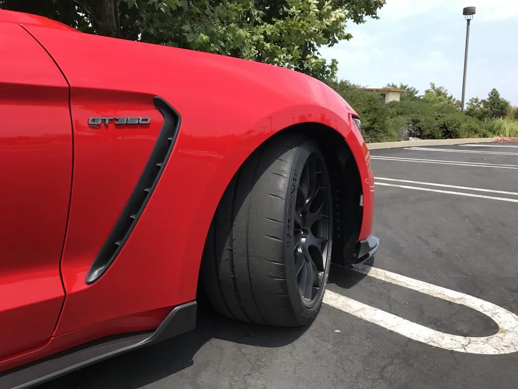

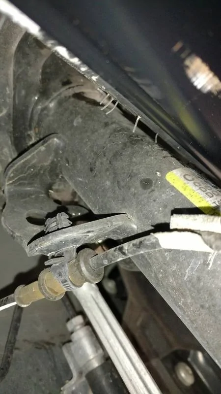

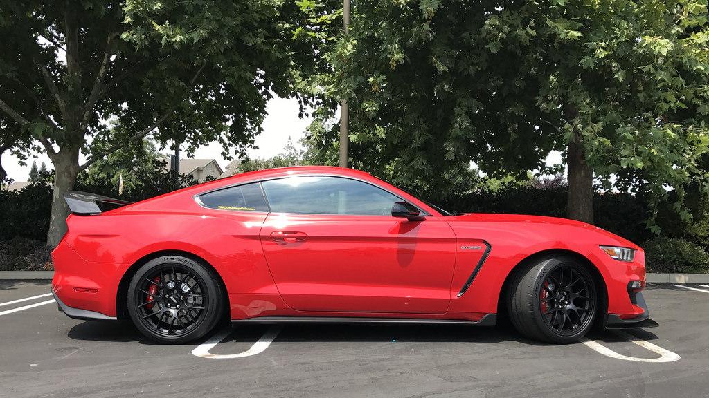

Without spacer the tires were very close to the strut. The little tire hairs are touching. It's around 3mm of clearance. This is all on a 2016 GT PP with completely stock suspension.
With 5mm spacers. Everything clears just fine.
With the 5mm spacer I couldn't get enough thread engagement on the stock lug nuts (only around 5 turns or so) So I had to go with longer studs too. 3mm was the largest spacer that I could go and still get bout 7.5 turns with the stock lug nuts.
