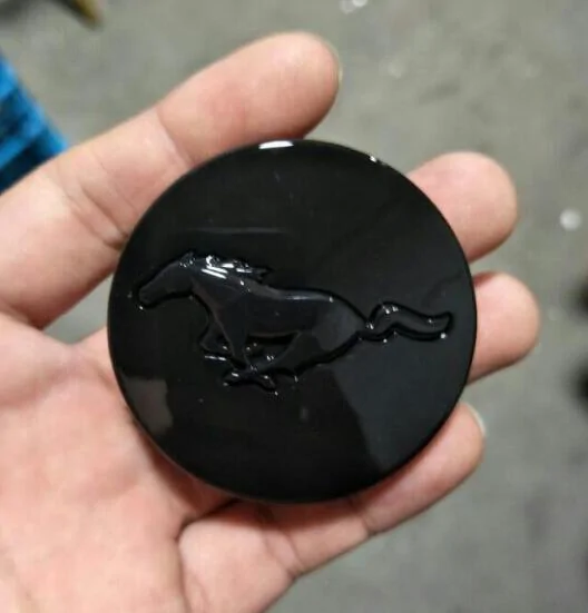

Cory if I bought a wheel/tire set up from you, would it be possible for me to send you these OEM center caps to install?

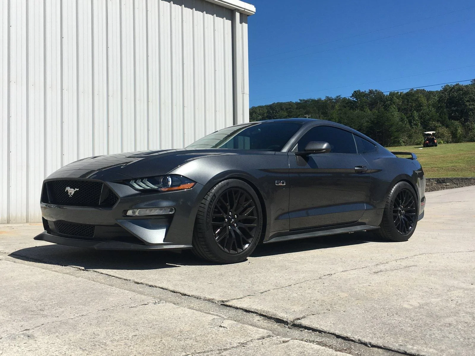

I assume we could do a 19x10 front and 19x11.5 rear on a NON-GT350. like my '18 GT PP1 car??
What is that center cap from? Our wheels do not fit every OEM cap out there, as there are many nuances between them so it's impossible to fit each one. Either way, the center cap takes literally 1 second to pop out. Gently grab the plastic ring on the backside then push it out, presto.
Yep! You're correct that setup, 19x10" ET40 front and 19x11" ET56 rear, would fit a non-GT350 and would not require any spacers. Rear fitment between the GT350 and other cars are the same.

The EC-7 uses a center cap design from older Mustangs, that won't fit. The SM-10 will accept OEM S550 PP center cap.
