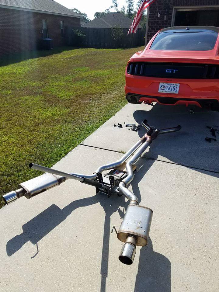

I did a generic x pipe and Borla XP generic mufflers that sound great. Cost was around $400.00.
I have a set I'm debating putting on mine. What tips do you go with and if your still good with the sound?
