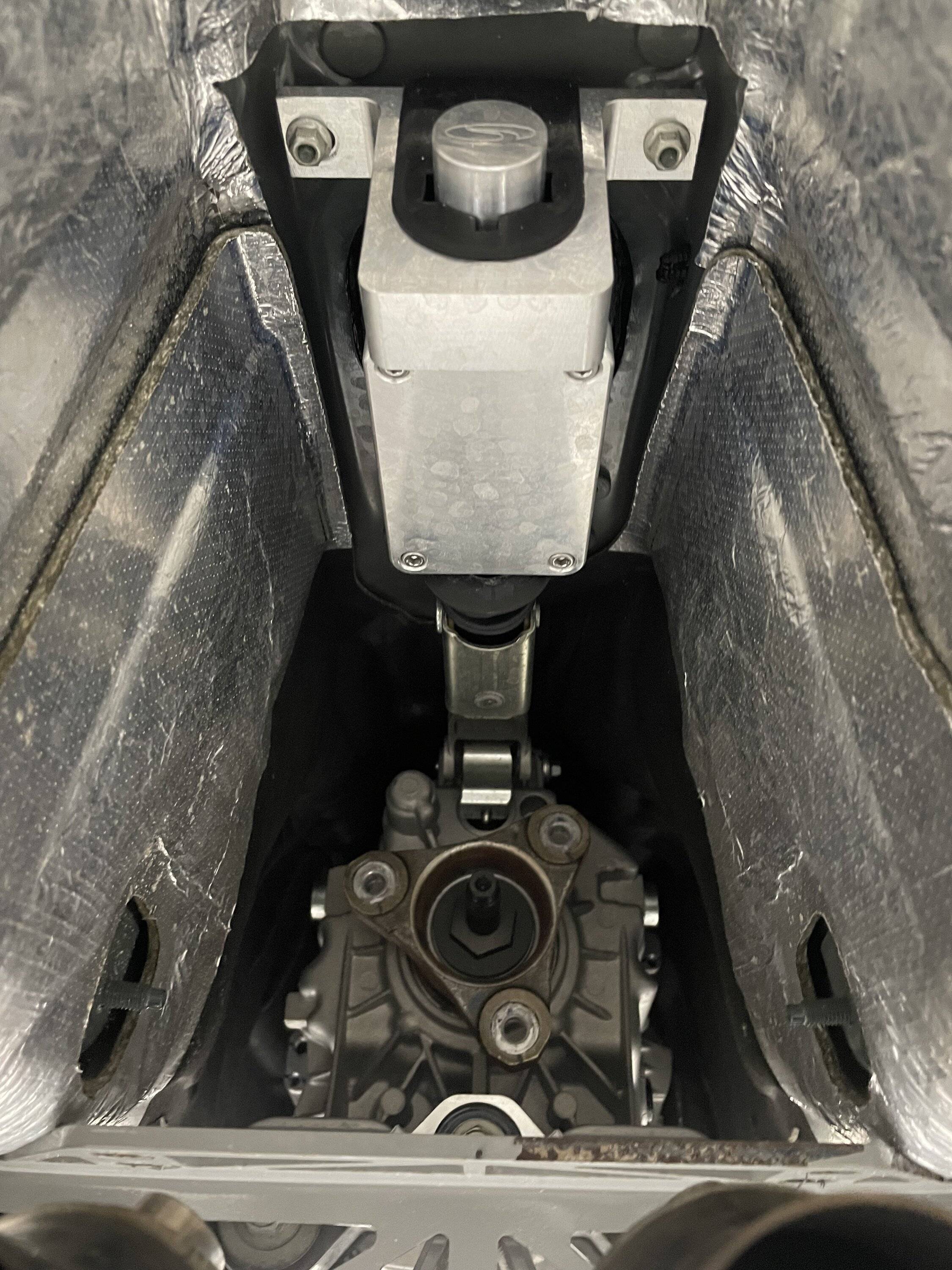

I didn’t mention removing the exhaust and driveshaft because some people install the shifter with them in place, However, if you want super easy access to everything, it would be best to remove them. That’s what I did when I installed my shifter.
