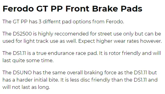

Greetings fellow SoCal racer. For what it's worth, the stock Performance Pack brakes aren't half bad, because they're likely Ferodo DS2500's. The issue you talk about switching is exactly why I switched to G-Loc, where I'll use something like R12 and R10's on the track, and then GS-1 for daily driving purposes. The Brembos make it decently easy, where you jack it up, take off the tire, pop out a few retaining pins, and pull them from the back of the caliper. I'll be testing them out at Buttonwillow this weekend with SV, if you're there, stop by and say hi.

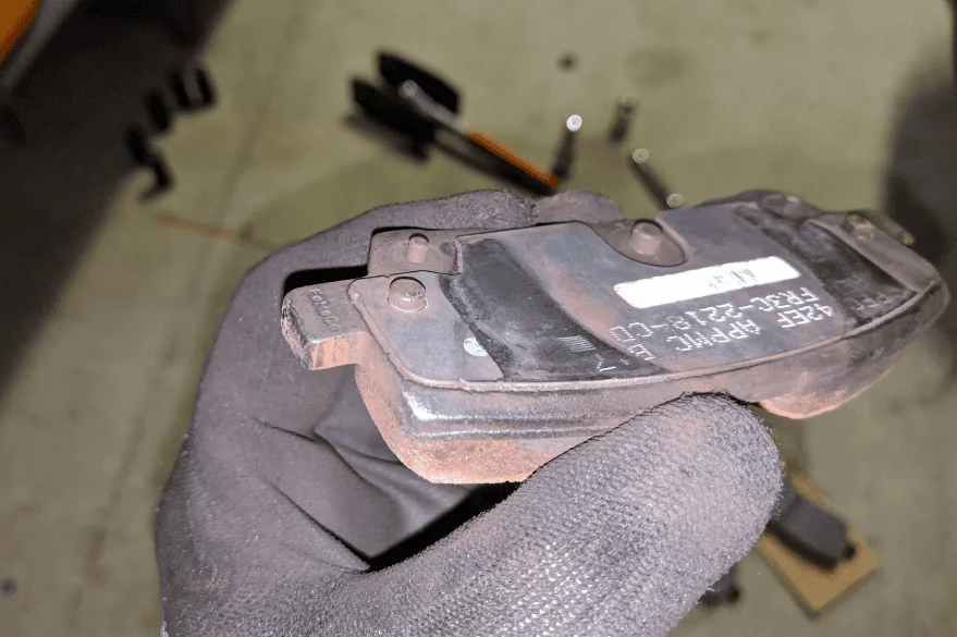

I was changing out my pads this weekend for my new Hawk set. The fronts were straight forward but I had one concern with the rears. Does the metal backing plate not come off on the rear pads? The front plate came off easily and I transferred it to the new pads. But for the rears, I could not get the backing plate off, maybe it's not meant to come off?

Need a picture but if you overheat a street pad on track it will crack before it chunks. When it chunks you loose pieces of pad material and that can end up a bad day. When it chucks you loose pad grip and increase heat more and destroy the pad. It is similar to when you overheat a street tire on track and the tire starts to chunk.
the PP pads can't be DS2500 because those are a race pad. Honestly these stock PP pads don't stop the car at speed. I have had 1 trackday on them and they allow a long pedal that does not modulate release well and has poor initial bite and not enough Mu to slow my stock 19 GT pp1 down without drama that makes me wait before the car settles enough for me to turn in. Can some of that be chassis? Yes I hope so.
That metal pad if fixed to the pad don't worry about it. Your new pad depending on design may or may not have that. This shims have multiple purposes like anti-rattle, heat dissipation etc. If you new pads lack that plate just install them as is.
DS2500 are definitely not race pads.
This is useful. Thank you
