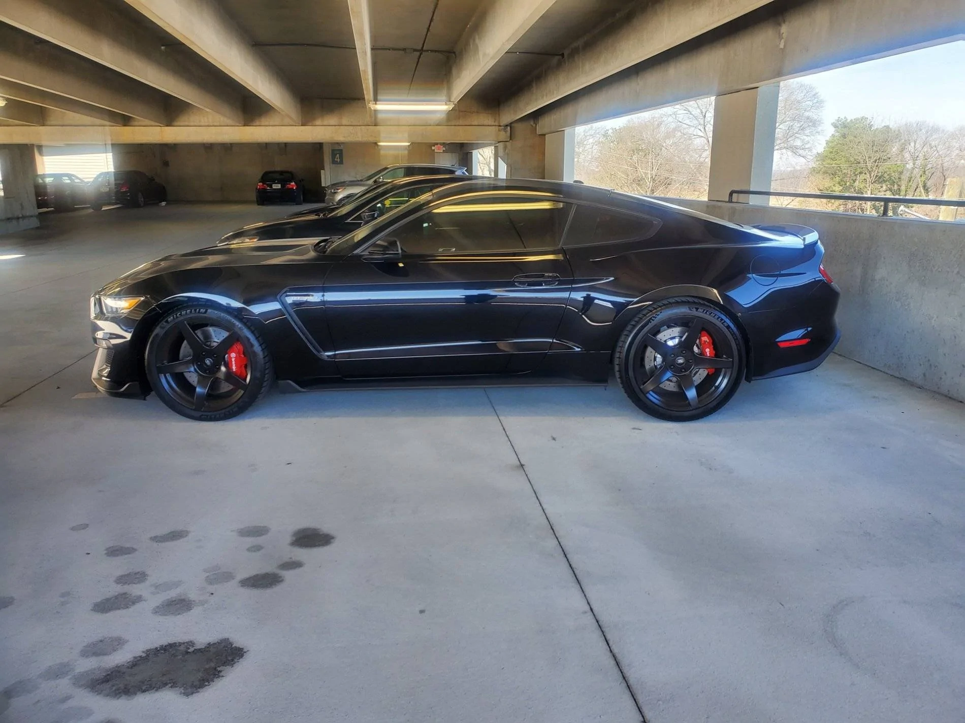

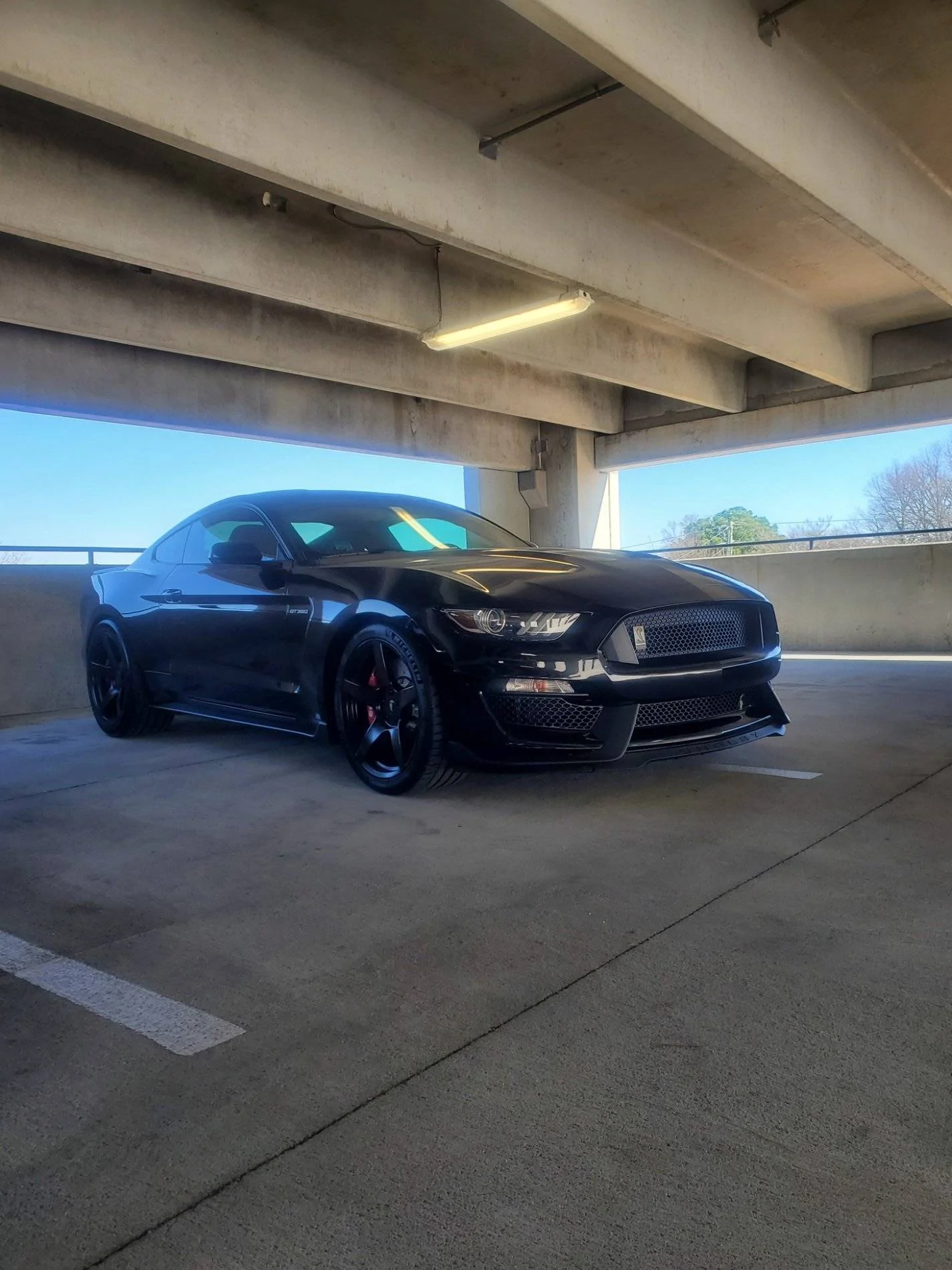

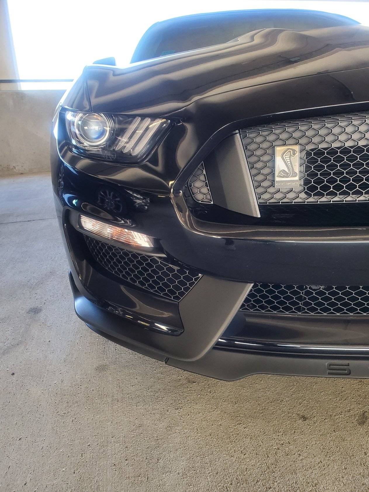

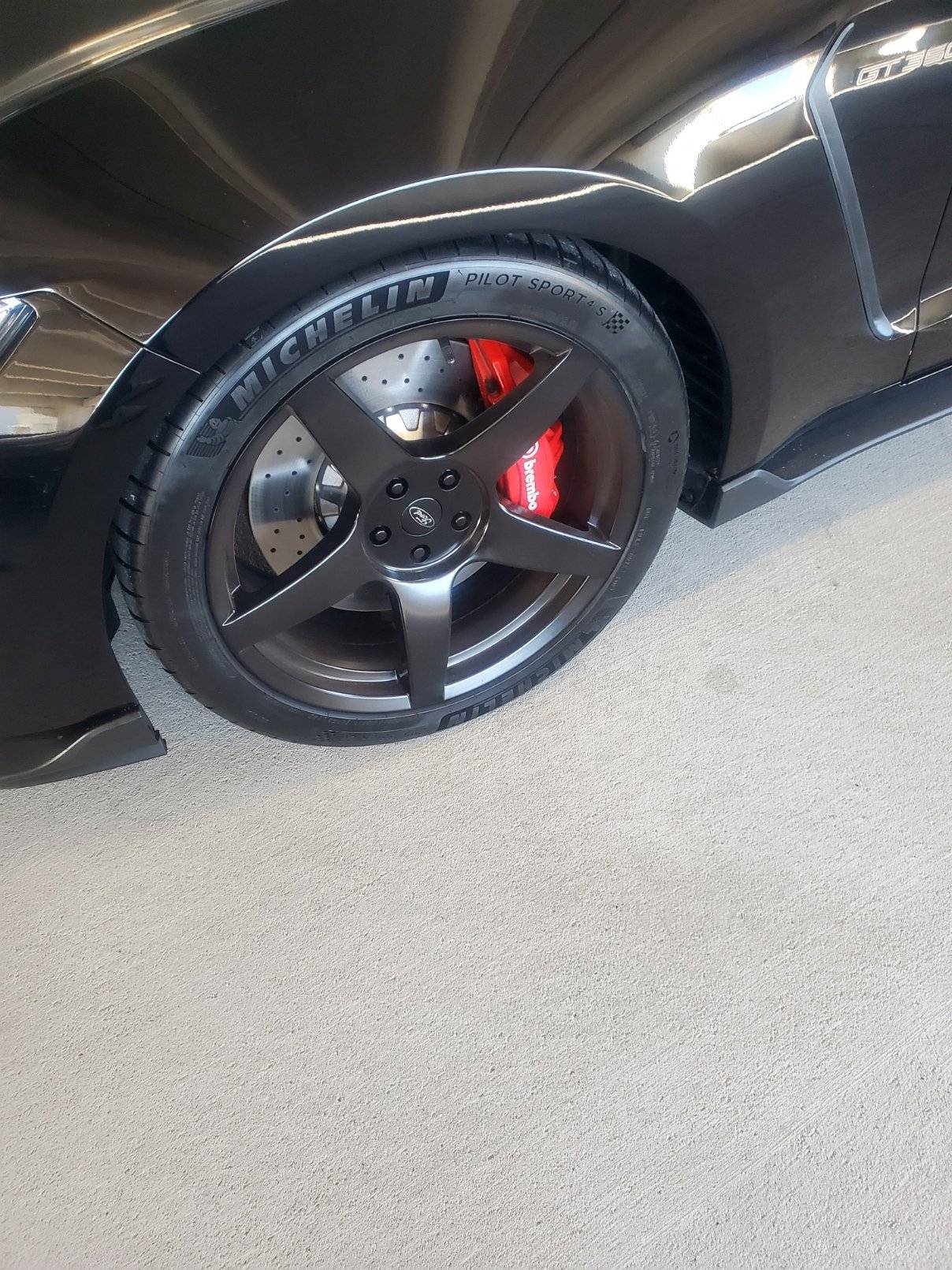

    It turned out really well, I have no words to tell you how great the guys at Akins Ford are. I will post more pictures later, with names and contact info; here you have some I took while parked at work for now. I hope you like! 20200222_110838.jpg 20200222_110846.jpg 20200222_110901.jpg 20200222_110909.jpg

    No, I don’t like emblems, but I am still trying to figure out how to deal with the holes.
    Akins shared their experience with epoxy and soldering, as I had asked them to leave the car debadged and cover the wholes on the side panels. If using OEM ones, best way is to get a custom or 3D printed emblems with the same insertion points as the GT350 one, they said. I will probably do this and put “GT SEXY” or something funny like that.
    The front grille is easier to deal with, as the holes are plastic.
    They recommended trying out the like of:
    https://lmr.com/item/LRS-43531A/mustang-ecoboost-boosted-decklid-emblem-red-black-15-18
    The front lip doesn’t bother me, it doesn’t stand out much.
    The only positive thing about this whole badging is the boosted folks on certain brands so assured mine is a GT350 and actively coming after it... very rewarding to see their faces when I am passing them without effort :)
