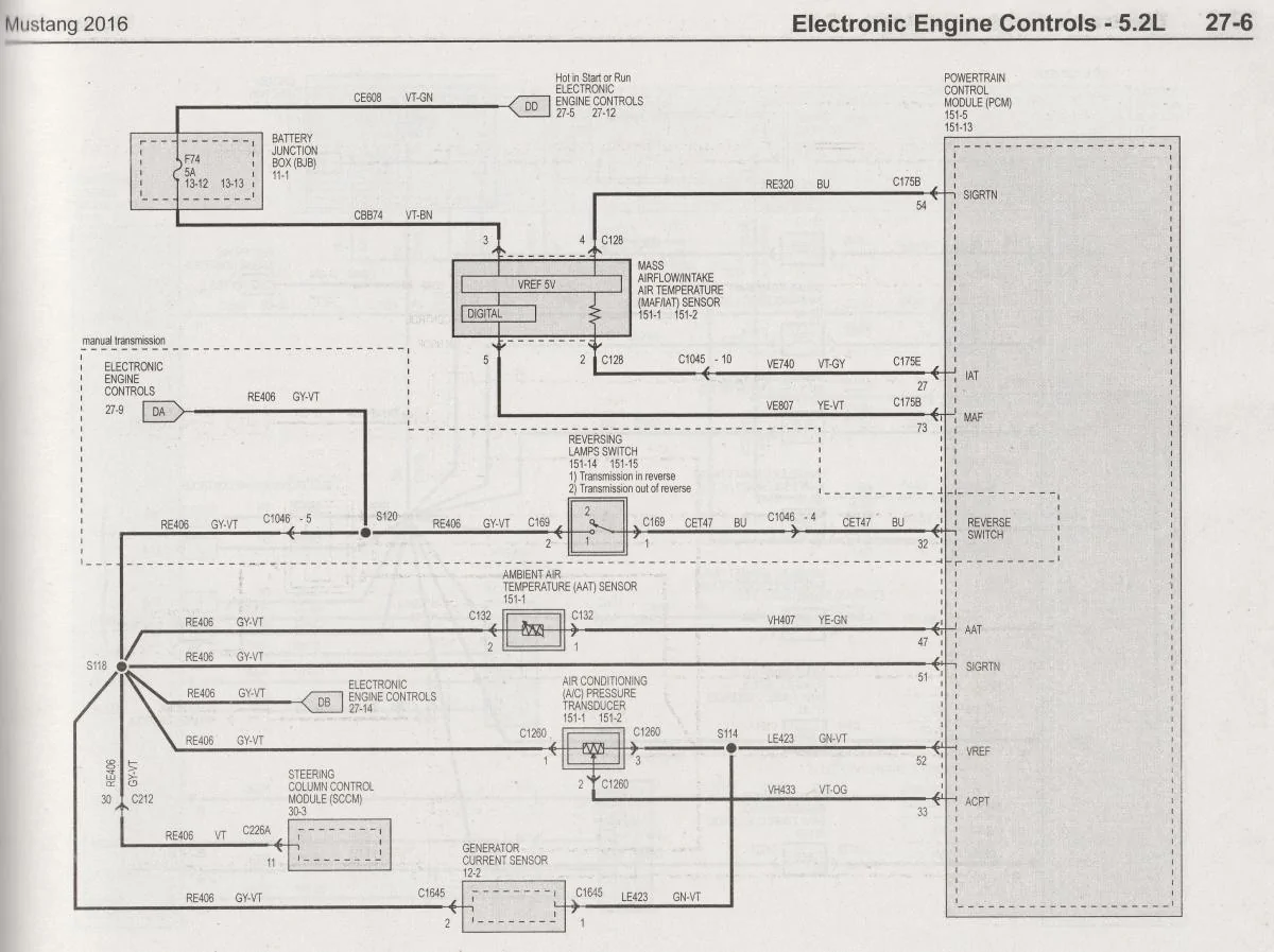

Matt,

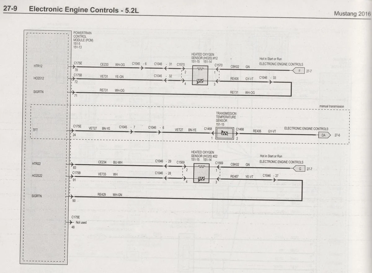

Out of curiosity, did you get this from Helms? I received the CD a few months ago and it is a November 2015 version. My version does not have the temp sensor shown on this schematic. That would have been helpful. I found it by process of elimination. Is there a way to get updates. Sorry for the slight side track.
Also, your schematic shows circuit RE406 going to page 27-6 via DB. My 27-6 does not have DB. It does have a DA. Which is the tranny temp sensor. If you have time and want to, will look at 27-6 and tell me what it says. You don't need to post pics. Your own description would be great.
Thanks,
John
Here you go, it's easier to just post a quick scan.

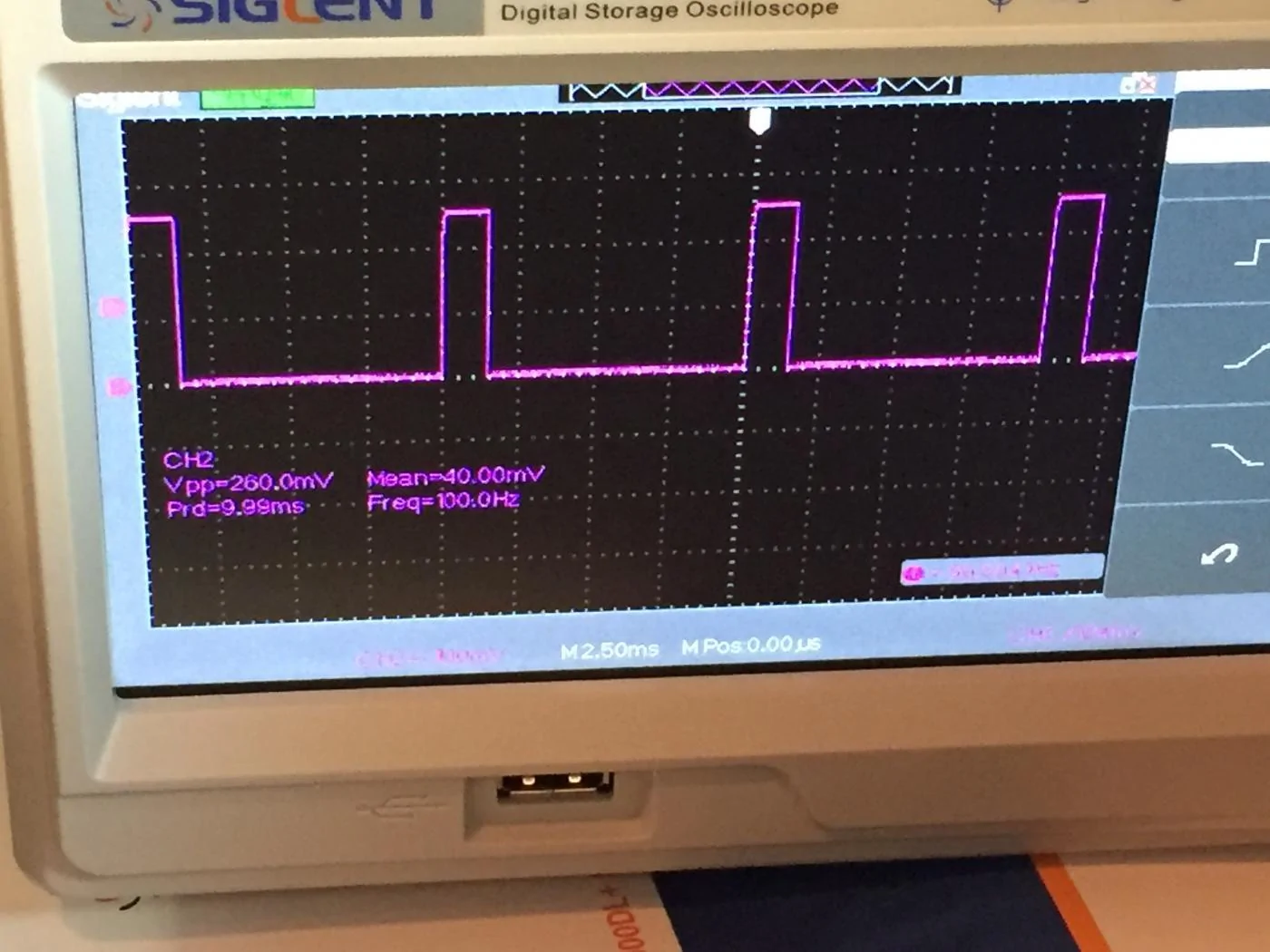

Good news. The speed control signal from the PCM appears to be a narrow pulse as expected at low temp.
However, I took the sensor temp up to 250F and the pulse did not widen any. I'm leaving the pump connected overnight in case there is some kind of reset/detection. If that doesn't work I'll start playing with settings (BCM or other) that are different for the track packs.
