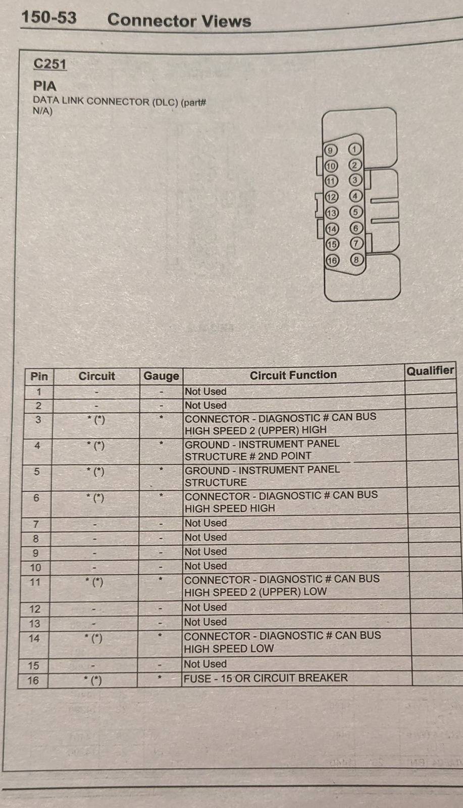

Can someone help me out with this? Need it for the sensor based flex fuel guide I’m working on. PM welcome

Not sure how much this will help unless you know what module you need to talk to... its all digital data busses and high speed module communications. But here's the pinout for a '21....

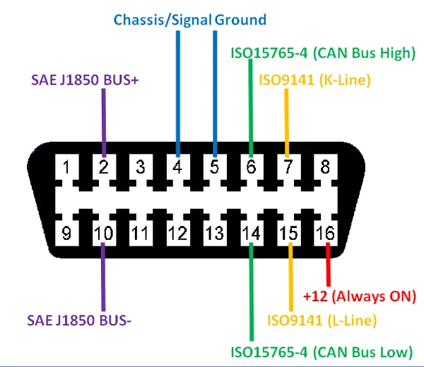

One more.
Thanks. This is perfect.

Maybe I'm naive or uninformed but I thought all OBD was the same. I thought standardization was the purpose of OBD.
No?
No?
the ford diagram helps a lot because ford uses the same terms between the ObD port and the port I’m trying to tie into, which in this case is the connector on the back of the DLC.
No?
It all depends on what years you're speaking of because the early OBDII had minimally used terminals and was prior to CAN being implemented. Newer vehicles (like current models) used a lot more pins on the DLC for various data functions.
That makes sense as far as it goes. It doesn't really answer the question though.
OBD2 is a standardized protocol, right? Data type"A" is going to be on a particular pin always, across all platforms, right? And if data types B, C, D, etc are added they will be assigned different pins, right? And that data, or equivalent, will be on those pins whether scanning a Ford, Chrysler, BMW,ect? Right? Isn't that what a standardized protocol is and why OBD/OBD 2 was created?
I think for basic DTC reading all you need is power, ground, and HSCan+ and -, so yes, but not all the pins are used on my obd port plus I’m plugging in a j2534 ford scanner so I’m sure there is customization available between manufacturers.
The "standardization" of the DLC was just for the "generic OBDII" data. I forgot if it was 16 pids or whatever the number of pids that were mandatory for manufacturers to deliver on the DLC. The CAN data stuff can vary between manufacturers as to what they will transmit over those data lines and the proprietary data can vary so unless you have a manufacturer specific scantool (or an aftermarket professional grade like OTC, Snap-On, Autel, etc.) you may not have access to everything there.
