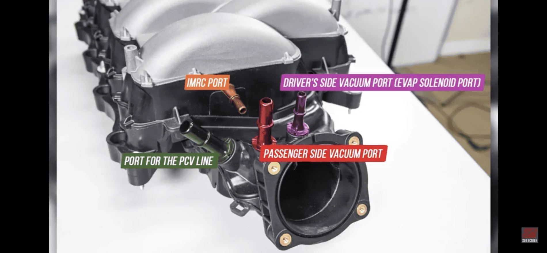

I have a pretty nice one. I haven’t used it yet. Where’s the best place to hook it up at/to?

A very common place to hook up is the brake booster vacuum line. You'll need to block off the throttle body
