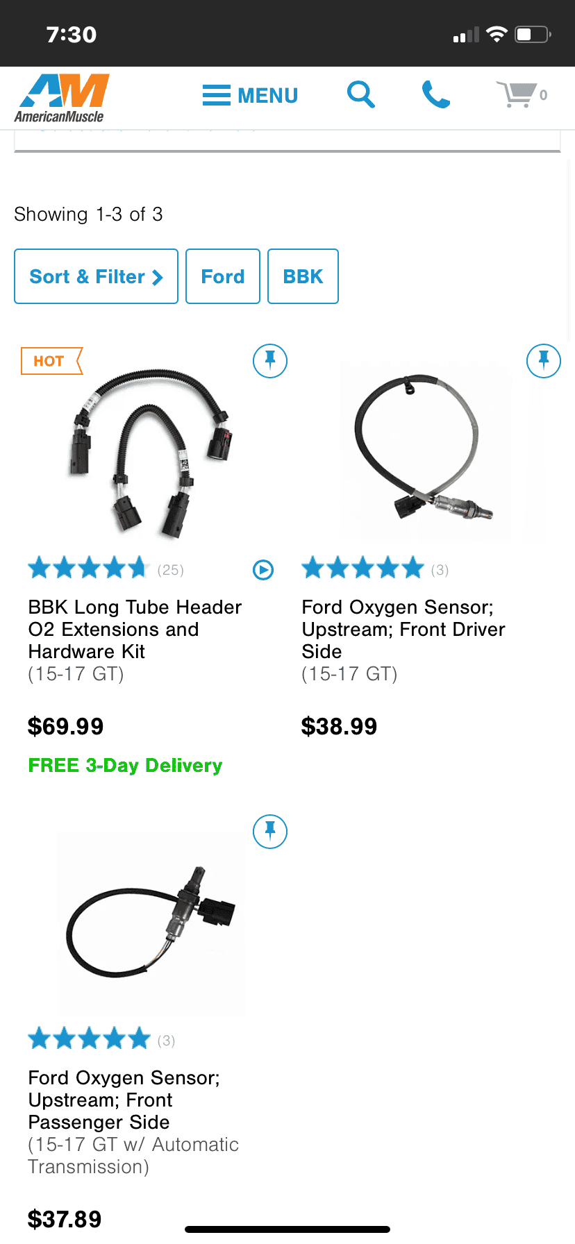

I’m going to be replacing my upstream O2 sensors soon, need to be educated on which ones should i buy. 2015 manual fbo e85 coyote. the passenger side option states “auto transmission) can i still use it on my manual car? If not, can someone direct me to which ones I should purchase? thanks in advance.
