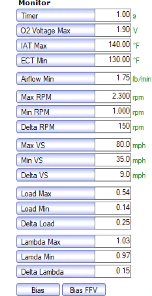

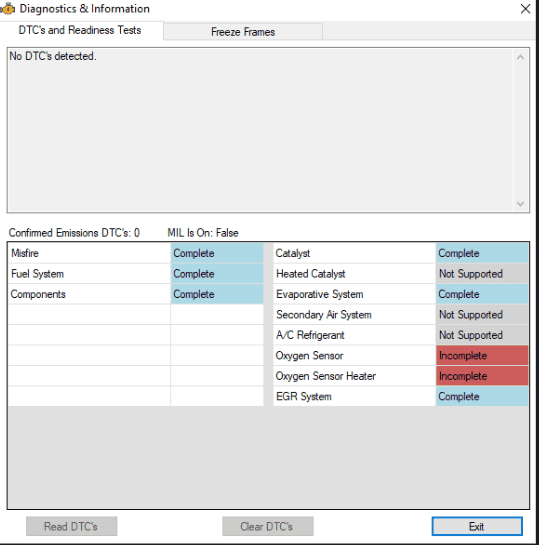

So this has been a "Thing" for me. The short of it is, I've had to add Cat's back on to the car to get it to pass emissions. Right now I am trying to get the Oxygen Sensor and Oxygen Sensor Heater to check in. They show as incomplete. Everything else has checked and shows good. So, I got an HPT kit, and this is what I've found.
and
This does look correct to me. Please let me know if I am wrong.
And below is the issue I am trying to correct.
What have I done? Drive. Mostly short drives 10 miles +/- 5 miles. Just took a nice long 4 hour drive with varying speeds. Highway, small towns (35mph) and such. All in all, I'd say I have about 300 miles into this. I know I am doing something right, as most of the systems have checked in. But what am I missing?

I've done a little research and found that a stock tune has it off. There are several other settings within a stock tune that seem really not attainable.
the Delta V for RPM is 150, and the Delta V for speed is 9 mph. While I see it possible to keep the car within 9 mph. The 150 RPM seems a bit much. The reason I bring this up is. One of the tests, as I have found out is a run of either 4 miles or 4 mins ( still don't know which one.) @ 40 mph. 1) trying to find a place that'll let you do 40 mph, without pissing people off behind you. And, that is flat, with no traffic lights.
But I digress. I've made some changes within the tune and at back to square 1 again. We'll see how it goes and will post updates as I make progress. I hope!
