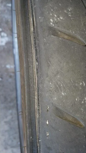

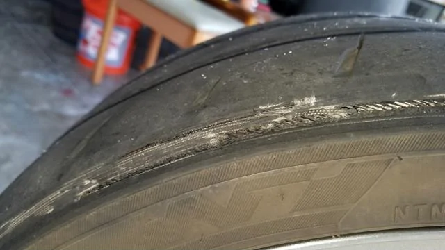

I appreciate the feedback. I have put the stock tires and rims back on. I will not ever drive on this tire and also may not go back with this tire and size again. I just can't figure out what caused this. I know there was some wear on the tire side, but not enough to make it separate like it did. The inside wear or separation was a big surprise to me when I took the tires off. Thank God for the nail in my back tire or else I may not have noticed it until it blew out on me, which would have not been nice. I'll take more pics of inside the car strut area and tire. I don't see any signs of rubbing anywhere. Thanks for the advice sigintel and everyone else.

That is not a tire defect. Having worked as a tire engineer and done failure analysis: nope.
Did these come from LMR directly?
If so, if they did not clearly label front and rear, they saved less than a penny in paint pen ink to risk this occuring. Their risk management and attorneys should jump to get you replacements and get those back as this is text book risk management (not to mention good marketing).
That tire might be a wee bit risky to drive on. Its cut thru to the shoulder reinforcement (circumferential cords) and possibly to body ply carcass and steel belts. Shoulder reinforcement keeps you from having blowouts from pot holes and we may have 0 protection left. If body plys are cut, Id be surprised if this doesnt blow out on you. In heavy lateral loads, the tread splice is completely unreinforced. You are basically a rolling tread separation waiting to happen.
Keep in mind, a tread separation is when part of the tread starts peeling and acts like a 400hp massive weedwacker while driving and rips your fender to shreads, blows your windows out, and tears the flesh off your arm if its resting on the window sill. Please dont drive on that.

With car safely on jack stands or some wood backing up your jack, get us some well lit pictures of your inner wheel wells, particularly the leading and trailing edges of your front spring perches. We can look for damaged perches, and possibly melted rubber. If perch is still structurally sound, thorough degrease with brake cleaner and a couple light coats of primer will keep it from rusting. If this was a perch rub, it may have gotten the strut fairly hot.
The wheel you show pictured does not look like a 255/35 20, maybe 255/45?
That looks like a front position spring perch rub, but on an excessively large OD tire.
A 27.4” OD tire is pretty close to max OD front for dynamic clearance.
Are your 255 a 45 series instead of 35 series? That would be way over 27.4”OD
In any case, if you document what you have, even if you put the rears on the front accidentally, I strongly suspect that asking *nicely* will get appropriate labelling added to the replacement wheel/tire and only leave the question of how much, if anything, they want you to pay. Offline thoughts avail via PM. Hope this all helps.
