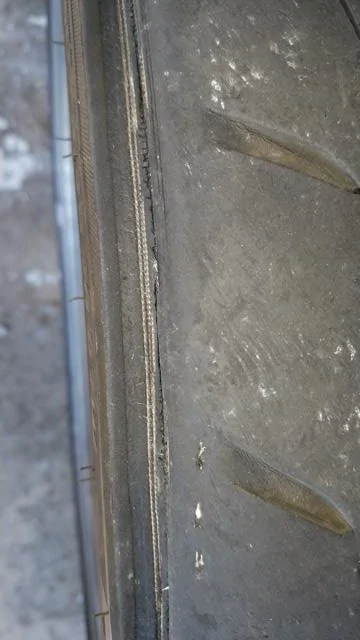

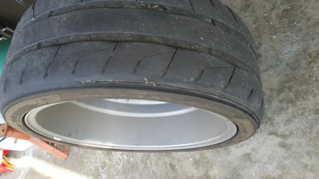

I haven't had it aliened yet, but will soon. I have the stock tires and wheels on now and they seem to track pretty good. Nonetheless, It does seem, I'll have to push the offset out at least an inch, which I'm not a fan. I was trying to avoid messing with the geometry of the suspension, thus putting stress on the bearings by getting the proper tires. What's odd though is it only rubbed on the drivers side. anyone else running 20" rim and tires with a +32mm offset?

I know it does seem odd. I verified it is the 8.5 front rims with +32mm offset and 6" backspacing. I have 10" in the rear with 305's no problem. the cut around the rim is very clean almost like the tire came apart from a seam. I have more pic's I'll post after I resize them. this is why I am inquiring to see if anyone else is running the same offset and backspacing.

It could very well be a tire defect.

I really appreciate everyone's help! I'm waiting on a Steeda Extreme G-Trac K-Member Brace and after the install, I'll get the car aligned and go from there. I'm leaning towards a tire defect, because of the smooth seam like grove around the tire.:headbonk::headbonk::headbonk:

See how the entire shoulder is worn, not just a single groove? That looks like inside wear from camber/toe to me, not a rubbing issue. You’d probably hear rubbing fwiw.
If it’s super tall it could be rubbing on the spring perch (easy enough to eyeball), but my guess is that’s toe. We see that odd inside shoulder wear on a bunch of cars. Mine is starting to do it, but I can’t say if it’s front or rear in origin because I rotate my wheels, and my 19x10+35 wheels definitely have clearance on the inside front and rear.

Right on Nightmare moon. I put the bad tire on today to see what it could be rubbing on and also I see no signs of rubbing anywhere. no marks at all.... this is a relief, but will watch my tires closely from now on. i'm glad i pulled it when i did or else.... ugh!

How many miles on those NT05s? They look like they were getting close to the wear bars at least.

I had my car realigned today. it was a little off on the front toe and some on the rear. the car drives better for sure. I initially said 20,000 miles on the tires, but I believe more like 14,000. we'll see as time goes. I won't put new tires on the 20" rims until the summer and i'll check the alignment then as well. thanks for all your help guys...

That does not even look like a 255/35 or 305/30!
That is not a tire defect. Having worked as a tire engineer and done failure analysis: nope.
Did these come from LMR directly?
If so, if they did not clearly label front and rear, they saved less than a penny in paint pen ink to risk this occuring. Their risk management and attorneys should jump to get you replacements and get those back as this is text book risk management (not to mention good marketing).
That tire might be a wee bit risky to drive on. Its cut thru to the shoulder reinforcement (circumferential cords) and possibly to body ply carcass and steel belts. Shoulder reinforcement keeps you from having blowouts from pot holes and we may have 0 protection left. If body plys are cut, Id be surprised if this doesnt blow out on you. In heavy lateral loads, the tread splice is completely unreinforced. You are basically a rolling tread separation waiting to happen.
Keep in mind, a tread separation is when part of the tread starts peeling and acts like a 400hp massive weedwacker while driving and rips your fender to shreads, blows your windows out, and tears the flesh off your arm if its resting on the window sill. Please dont drive on that.

The wheel you show pictured does not look like a 255/35 20, maybe 255/45?
That looks like a front position spring perch rub, but on an excessively large OD tire.
A 27.4” OD tire is pretty close to max OD front for dynamic clearance.
Are your 255 a 45 series instead of 35 series? That would be way over 27.4”OD
