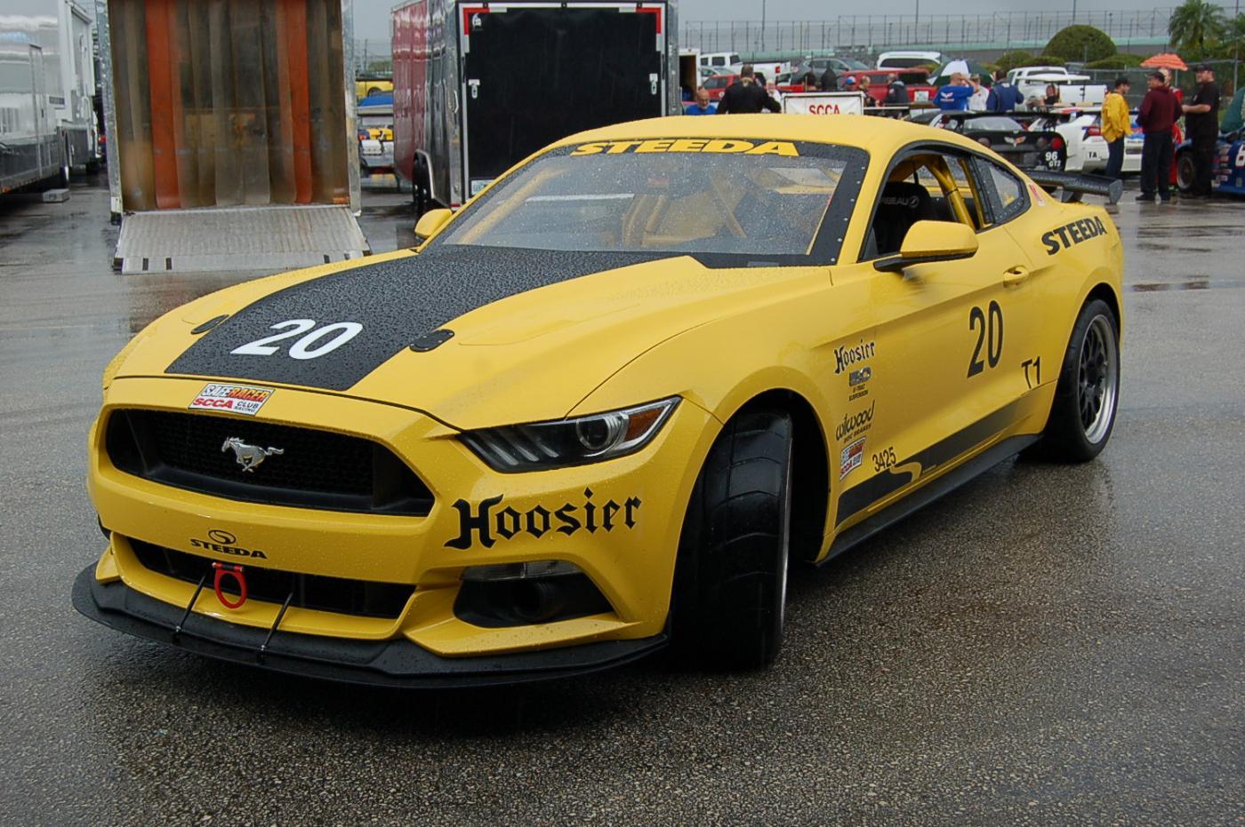

My buddy took this photo back in January at the SCCA Majors event. Looks like Steeda uses the NT01 as a rain tire for their race car. I believe they won this event.

Those are new-newish NT01. Anyone with 1-2 track days on NT01's will need another "wet" tire as NT01/s lose a ton of the tread pattern, especially on the outside shoulder, very quickly. It's great in the dry, because they become a slick-like tire and grip until they cord.

I have 305 NT01s that I have to decide if I'm going to get wheels for and have a dry and wet set or just a dry set. I would not run NT01s in the rain, personally. I am only comfortable with standard summer street tires for wet tracks at my skill level. The Steeda car does run NT01s in dry and rain settings. But it is driven by a driver (drivers, actually) far more skilled than you or I are (well, at least me).

Yes we did Win the event, the track was wet, but not super wet.
Usually we run on the Hoosiers.
