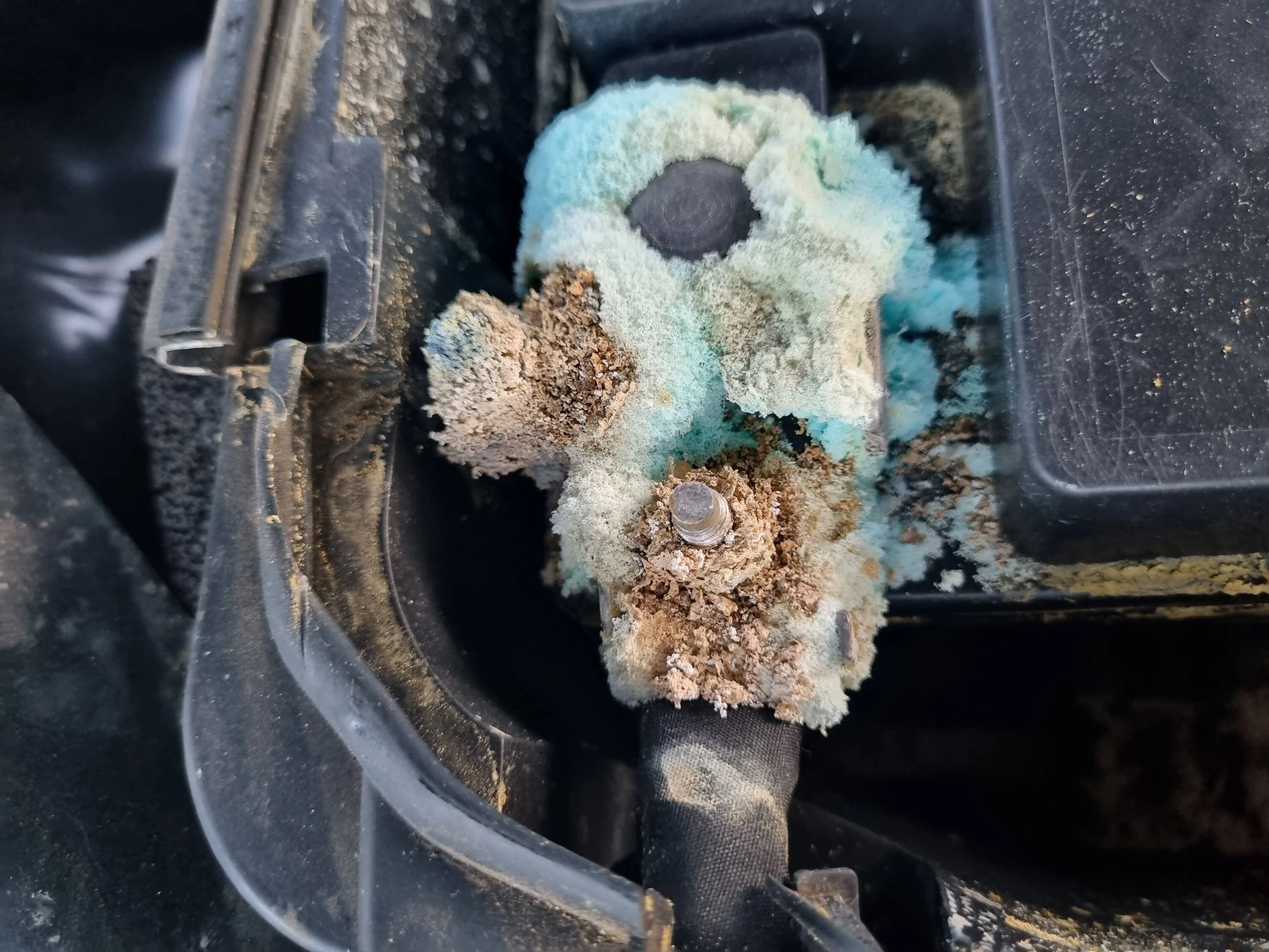

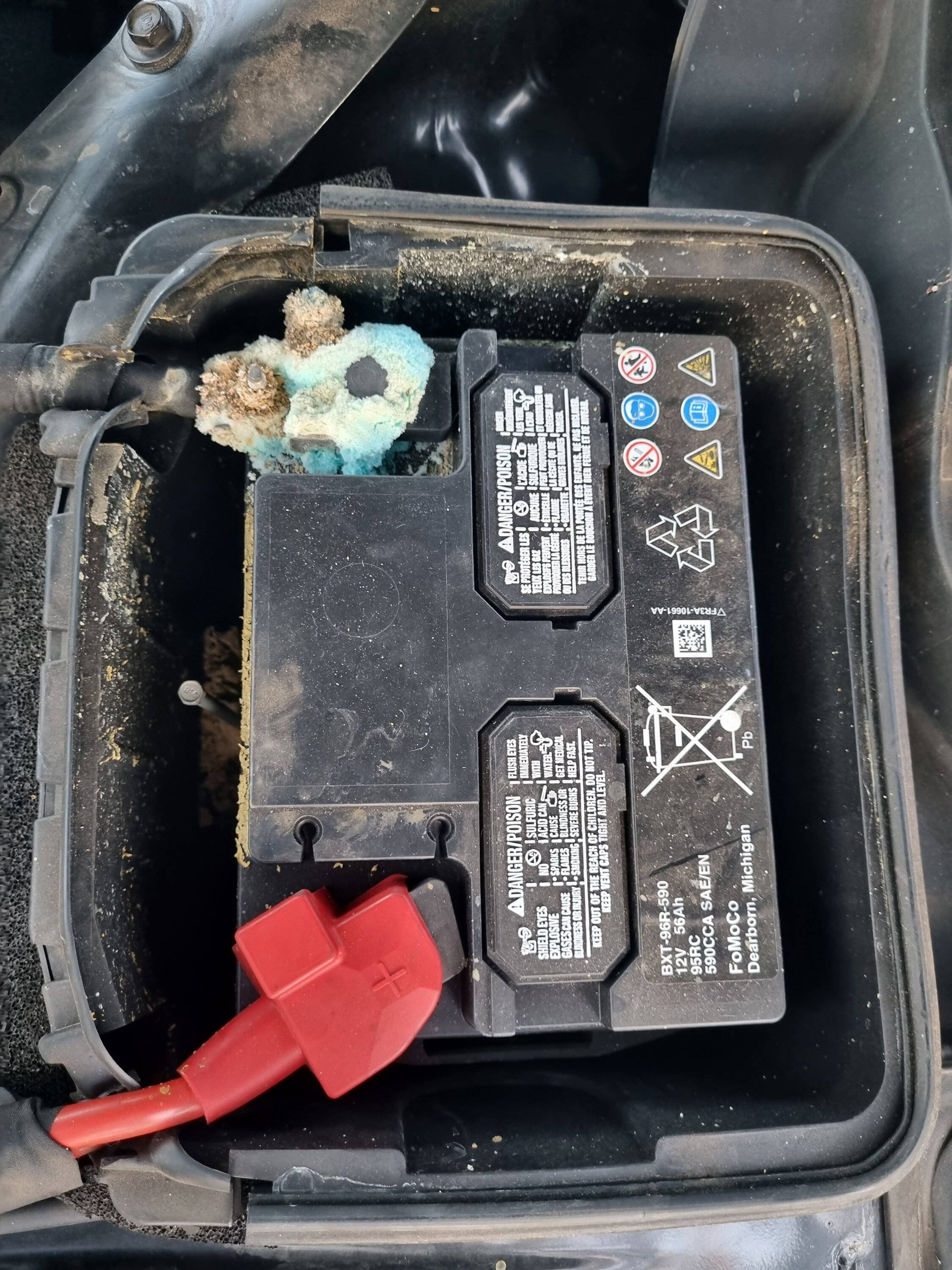

Yeah like this 😗. My battery died last month and this is what I found under the cover. I hadn't looked under it for the whole time I've owned it (7 yrs). The crappy thing is I've had the car Ford dealership serviced its whole life and they check battery as part of the service......obviously they don't.....what else have they missed.....I'm surprised
..not 🤣🤣🤣

It was the negative terminal on my battery that corroded also. I would be so pi$$ed at that dealership. Anyway makes me want an AGM battery even more. I looked recently and the 96R is not as available as most other sizes. They're expensive too.

Wow, that's REALLY ugly! My cars NEVER got corrosion like that as I've always installed the impregnated felt rings and sprayed the terminals with a Noco type spray that stays "soft", not like some that are like a paint coating that can crack, etc. Also, I check my battery terminals condition every couple months to ensure it's pristine (at the same time I do a capacitance check of the battery's CCA).

With my older cars it's no problem to check as there is no cover. The cover has a bit of 'out of site out of mind' effect. My mistake was to assume it was OK as it's part of the log book service schedule and it's marked as checked by the dealer, which clearly they haven't done. I had to remove the battery box to clean out all the crap and to make sure it wasn't corroding anything else. Suffice to say that will never happen 2 me again as I will check it personally. I was not happy with the dealership and I told them, of course it made no difference and they didn't really take ownership.

Old-school coke will clean it right up :sunglasses:
