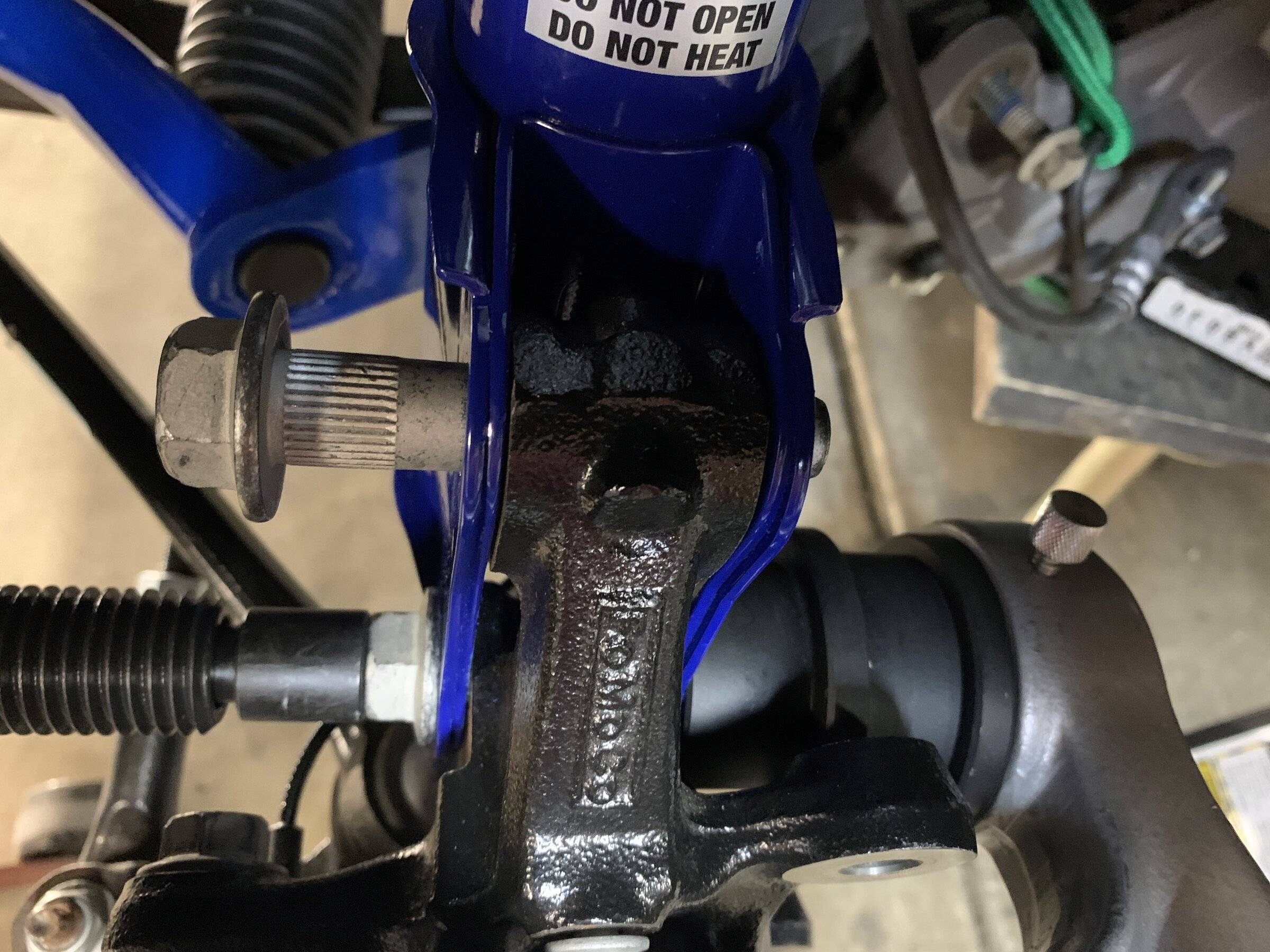

I used a large truck stud remover and they came out easy. Granted the car is only 6 months old but I couldn’t bring myself to take a sledge to it. It cost around $300 so maybe a better club purchase to be loaned out.

This is a 2021 Gt that has a magneride style hub. I needed to stack a spacer to clear the hub for pressing out the bottom bolt. No problem. There wasn’t room for my impact gun but it was not needed!

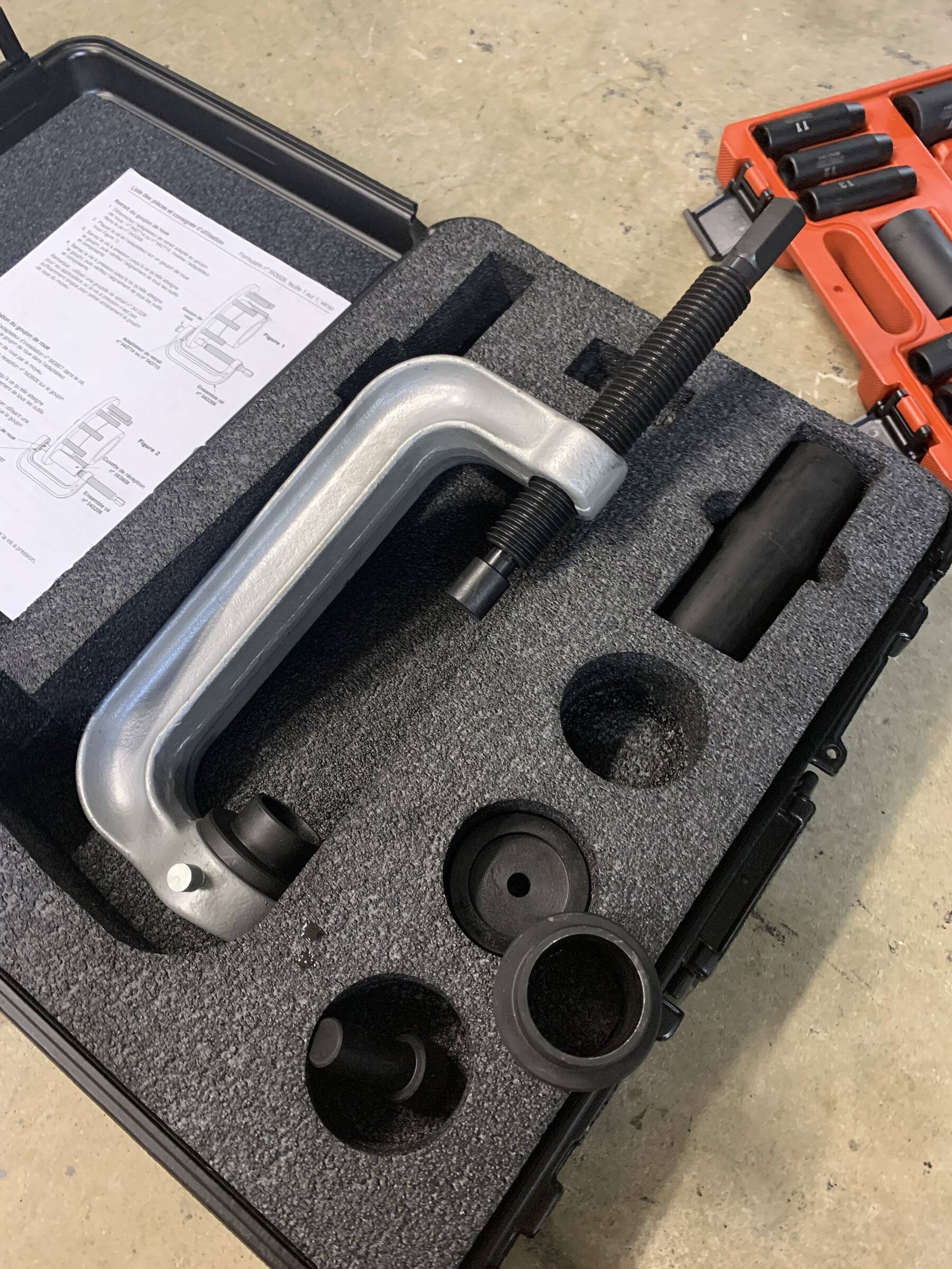

OTC 4295 Wheel Stud Service Kit

You can also use a big C clamp and an oversized socket on the bolt side. Same idea basically.
EDIT: I tried this method and don't recommend it. C clamp rotation handle can't provide enough torque.
Have you done this? My old brain forgot but I was trying this a few months ago on a strut not on the car. I cut off the little sliding handle and was going to weld a nut for the ratchet end. I remember having trouble fitting a socket for both inside and outside clearance. I should try again. It would save a lot of misery for this operation.
I'm about to. I have the car in the air doing suspension upgrades and will probably be doing the struts tomorrow. I have a rather hefty C clamp that looks almost like the press tool in your pic. I'll post some pics when I do it.

Thanks. A much cheaper solution.

The lower bolt again required a spacer to clear my 2021 4 bolt hub.
