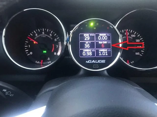

Does anyone know how to get the following 2 gauges on the nGuage?
Gear CMD (Shown in pic)
Trans temp
Mine is from Lund if that matters.

Send a ticket to Lund and request those PID's. I know Lund only has certain PID's available to log/show.

I just did the most recent firmware update, rescanned and selected "Ford All" and it has the gear, trans temp and digital speedo.
Just in case anyone is looking for it.
